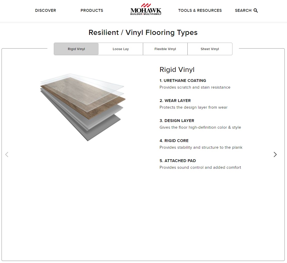

Should I remove the urethane coating my LVT came with?
Is your factory Urethane failing after 18 months?
116,968
I haven't done a single coating yet but I'm curious. Why shouldn't one do coatings on lvt and lvp? Is it the texture, contours, faux wood grain and such that makes it a be-atch to get off? Just completely unnecessary and a waste of time to put on and take off in general?
Yes
Reactions: Bryce C
I don't know. It's still in the box but I imagine it wears off at some point reducing the scratch and stain resistance. I don't think Mohawk has magic everlasting urethane even though it is put on under better conditions and aftermarket blends would vary in quality.
116,968
I wonder which of these covered the slop and mop application process...
Different manufacturing processes can also influence the overall quality of a luxury vinyl plank’s wear layer. Some methods result in more robust layers that are less prone to damage over time:
  • Cured Coatings: Cured coatings apply a liquid coating on the photographic image layer before curing it. This curing process uses ultraviolet light and heat treatments. This process results in a durable surface that resists scratching and staining effectively.
  • In-Mold Labeling: In-mold labeling involves fusing together multiple layers during production. Instead of adding them separately afterward creating stronger bonds between each part. The overall durability is enhanced in this method.
  • Fusion-Bonded Layers: A fusion-bonded process uses heat or pressure to bond all components of the LVP together. This results in a more durable and long-lasting product.
