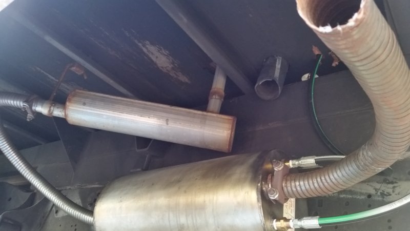

I added an a Blue Barron heat exchanger to my Whitemagic... it replaces the primary heater ,but i don't see any reason why you couldn't extend you exhaust and add one .
