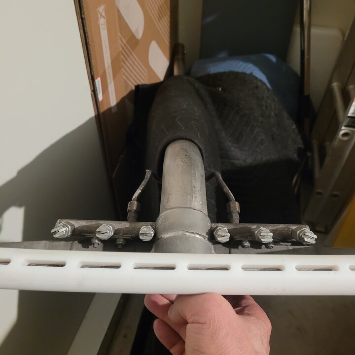

Mario
I have a Prochem titanium wand, wondering if anyone one changed up the jets to fit their needs or preference. What are they?
I don't like the slight over spray one each end.
The side jets are slightly turned inwards to prevent overspray. The wand in the pic is used for residential carpets only, set at #9 flow- 95015. The identical wand is set to #11 flow for the commercial accounts. ( mostly CGD carpeting) Both are fitted with extenders to counter the glides.
The flow on that wand with 6 - 015 jets is between 1.8 &2.1 gpm@400psi

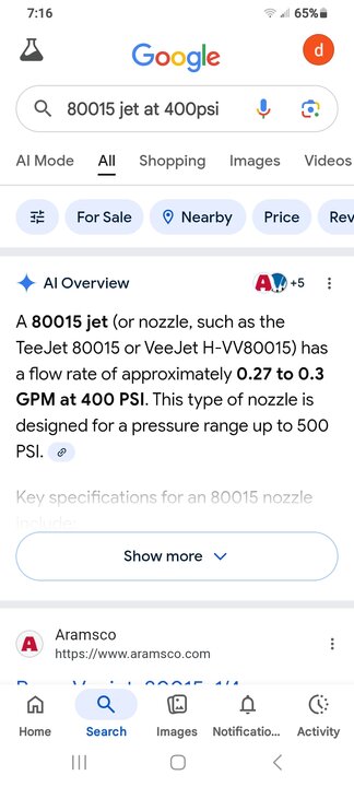

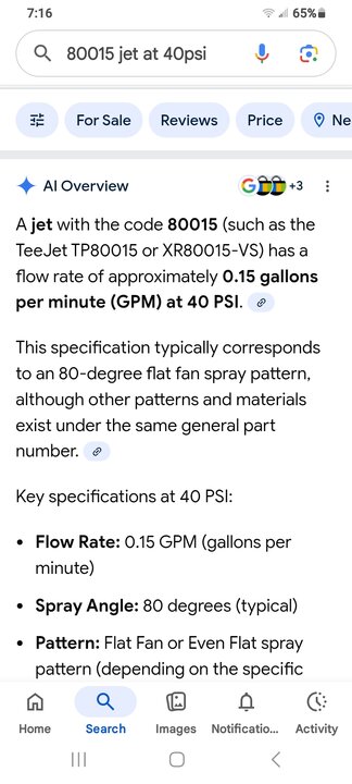

80015= 80degree spray and 1.5flow x 5= 7.5flow of water
Flow is based on psi. Most spray jets are rated at 40psi. Based on that, 5 - 80015 jets will flow .75 gpm @40 psi (.15gpm per jet×5) and 1.35 to 1.5gpm @400psi
View attachment 133179 View attachment 133180
You would have to recalculate for the 3/8" solution hose again, if you want to be so factual. It's possible that we used to mistakenly refer to jet opening as flow, e.g., 6×9502 would equal to #12. I promise to give you exact numbers once I have more time and do the bucket test 😉.

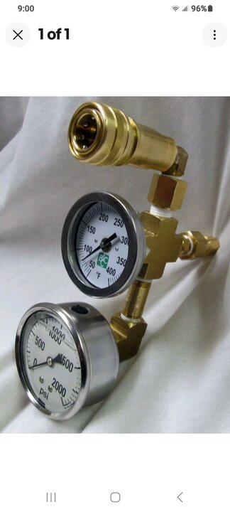

I have no idea what you're talking about. Ive always simply used spraying systems flow charts for flows based on tip size and pressures , then simply multiplied by number of jets to reach flow. Flow is based on size of tip and psi at tip. Diameter, construction (materials its made of),and length of hose will cause pressure drop from pressure source to tip which will effect actual flow. Thats why jets are measured on a chart at a standard pressure generally 40psi and adjusted up or down from base for final flow. And all this is made sooo much easier for this computer generation by simply asking google "whats the flow rate of a _ _ _ _ # jet @ _ _ _ _ psi and getting an immediate answer. To get an accurate pressure reading at the tip , youll need a pressure guage on quick connects at the wand and check pressure while spraying. But if you're really really really geeking out and you have a hose connecting your trigger valve to jet manifold youll connect the guage where the manifold and hose meet for the utmost accurate reading. If that's your thing and you got that much spare time. For me .... size & number of jets and pressure at the trigger is good enough. I have a" lie detector " that looks like picture below i use as a test tool for checking my temps & pressure
