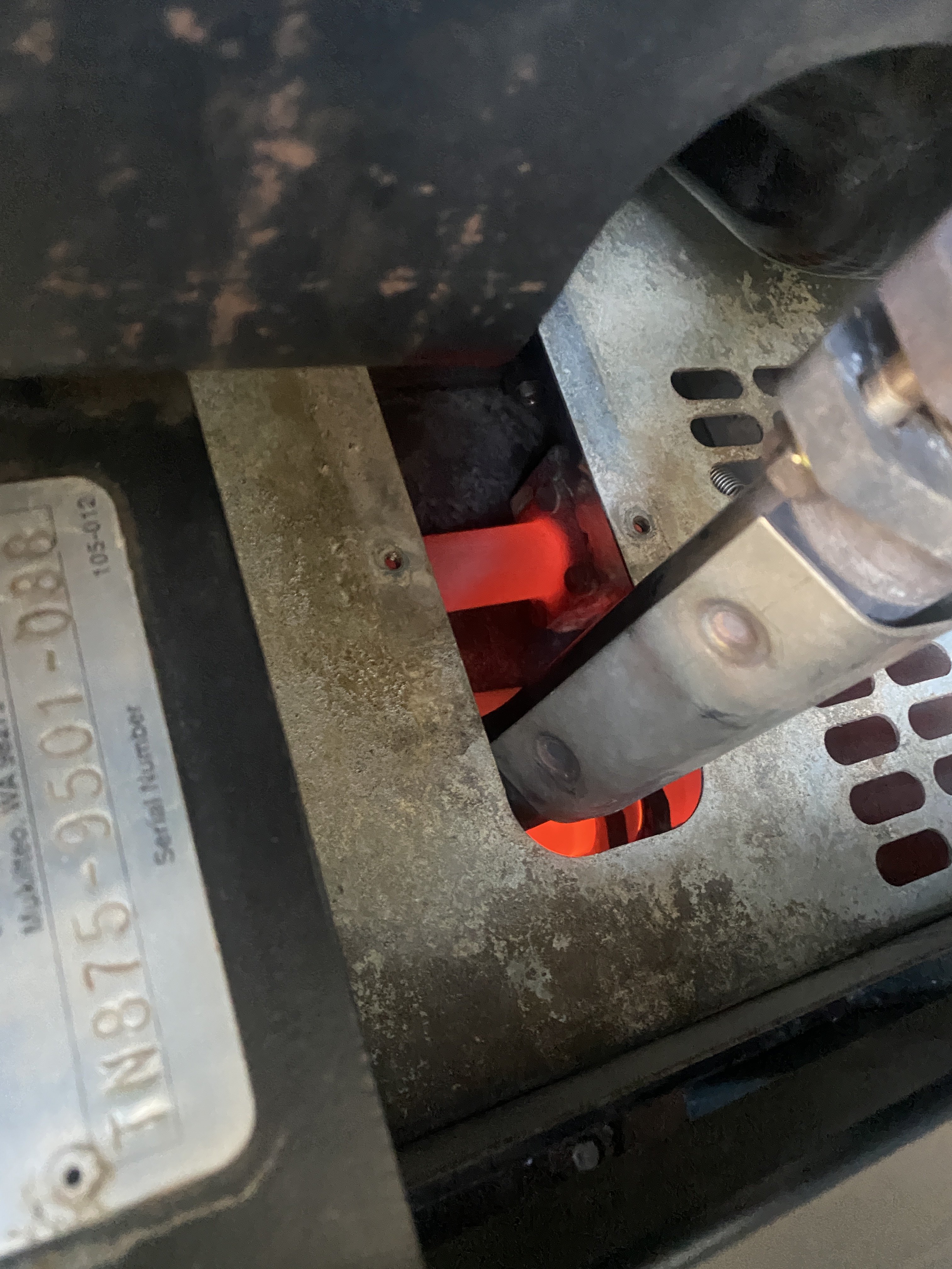

a few weeks ago I was having an awful time getting past that usual start and stop till it smoothed out. I noticed the lower exhaust was cherry red diverter valve too and lower pipes . I figured I had a clogged catalytic and taped it a bit and eventually it smoothed out enough to finish an all day job and the exhaust stayed cool. Machine ran fine.

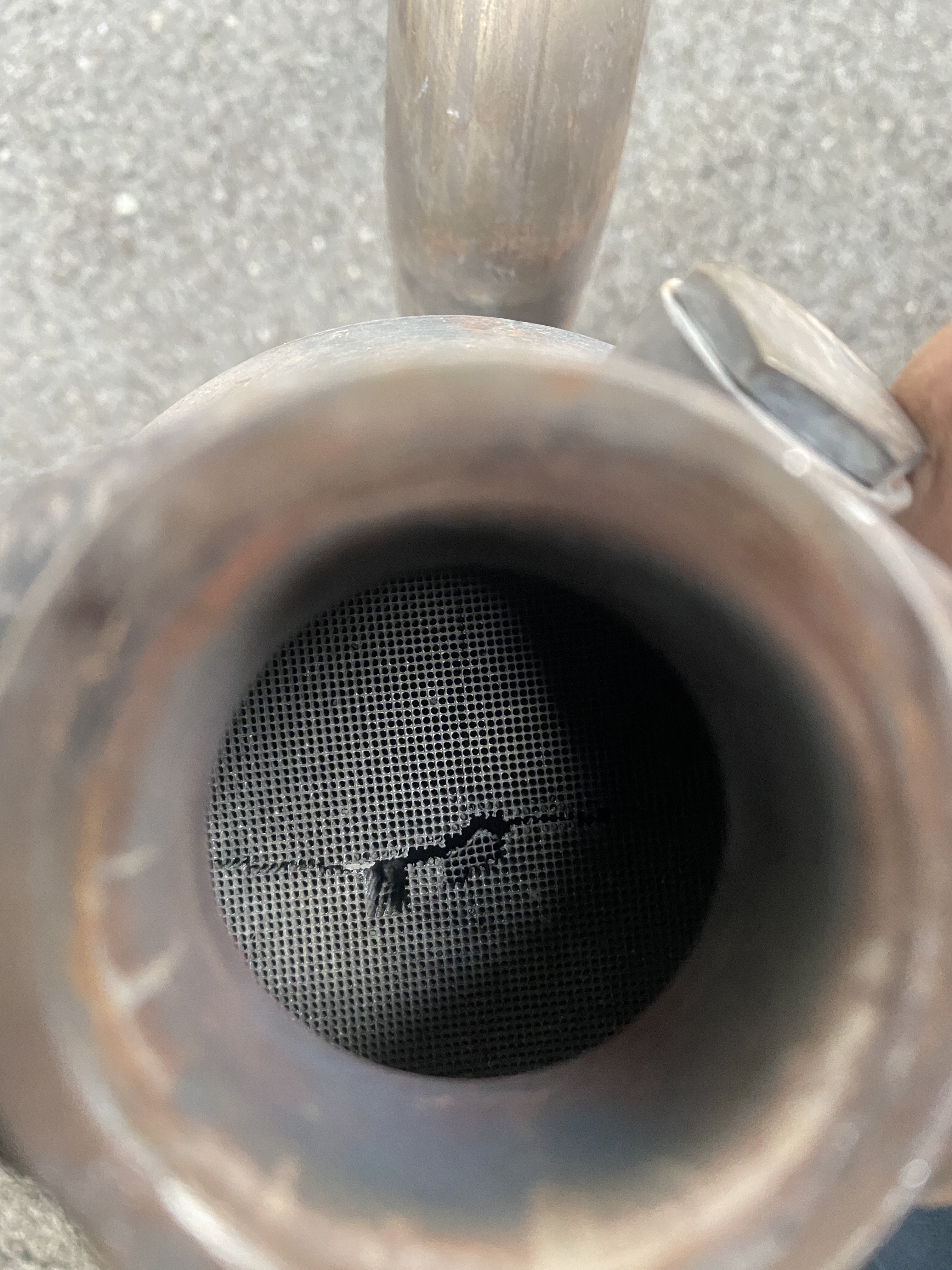

Update what looked like a loose plug wire doesn’t seem to be the problem. Quick recap. I had hollowed out the old cat while I waited on a new/used cat. During that time when I ran the machine it still stumbled and ran like it was bogged down but the exhaust tubing including the diverter valve did not get cherry red but it still stumbled like before . I later received a good used cat no debris in it honey comb looked clear I installed it and that’s when I found the loose spark plug wire. I ran the machine today with the replacement cat and the spark plug wire secured. Machine ran for about 15 min smooth then a slight stumble and then the same issue with bogged down. This time the exhaust and diverter valve cherry red.
I think I have two problems . I will take out the replacement cat an see it it fell apart it is a used one so maybe it fell apart and more junk in the system clogging up the exhaust and that probably why the cherry red exhaust. The really need some help .

Yes I thought that too but the diverter valve is extremely smooth and it’s in the bypass mode anyway so I doubt it’s at the valve. I also just took off the replacement cat that was used and when I looked inside of it it is now damaged . I looked great when I put it in but it was used and someone took it out of another Machine for some reason. So probably not good.
I put the old one I had back it has been hollowed out and basically not cat . I ran the machine ant at about 10-15 minutes it Boggs but the exhaust is not turning cherry red. I does run a little better but that’s probably because of less resistance. What would cause a cat to get damaged like that anyone have any ideas. I also ran a snake camera in both ends of that exhaust system from the bypass side and into the diverter valve and it all clear.

Sounds like it needs a tune up. ( new coil packs and plugs/wires and clean mass airflow sensor. I’ve replaced cats that have been cherry red in 3/4 ton 6.0 vortec pickups due to misfire. All the Unburned fuel toasts the cats and the rapid cool down will also Crack the insides along with the extreme heat. Also determine that your thermostat is not stuck open. engine would be using more fuel to make up temperature.
