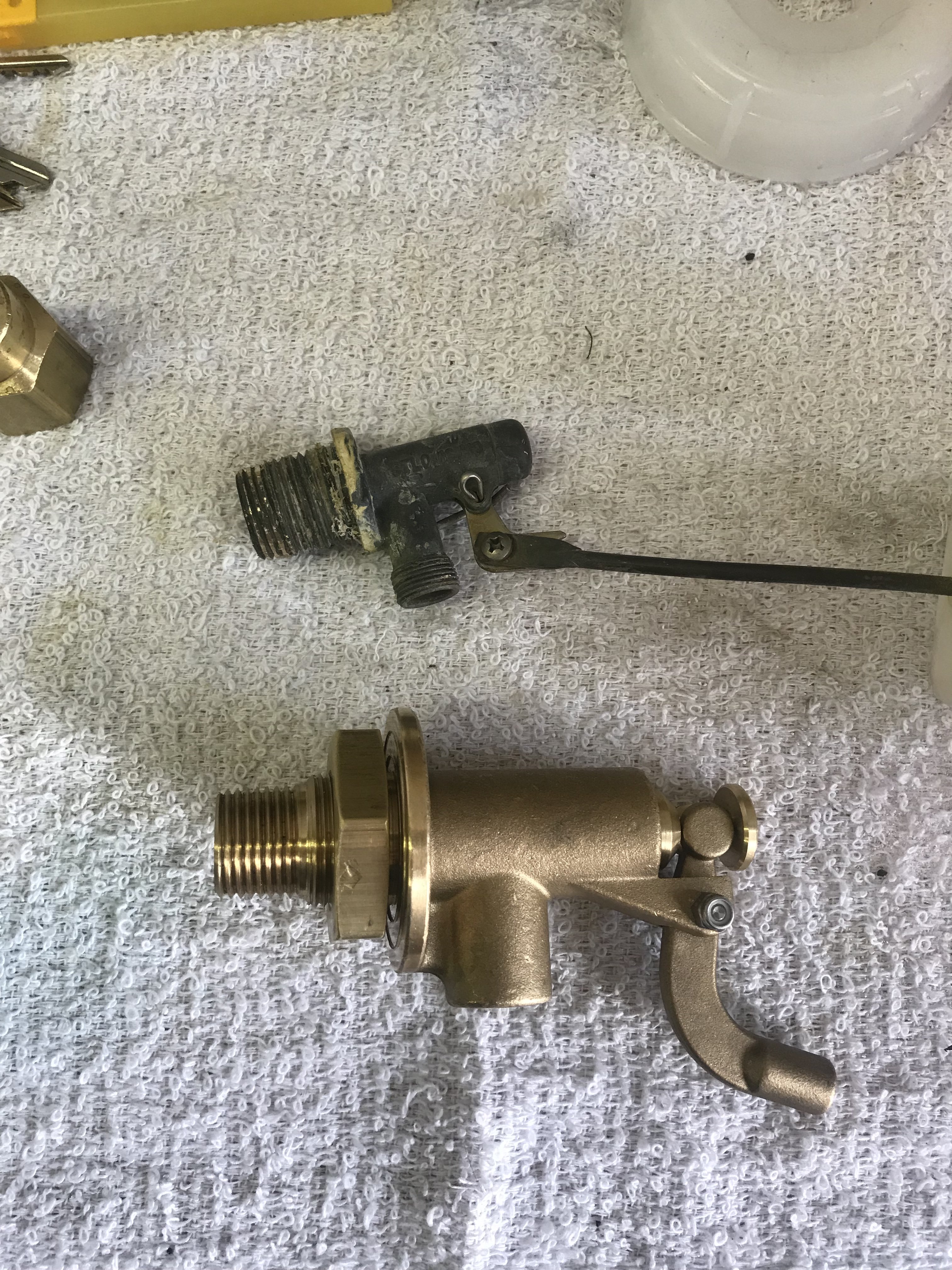

Time for a new float?
Trip Moses

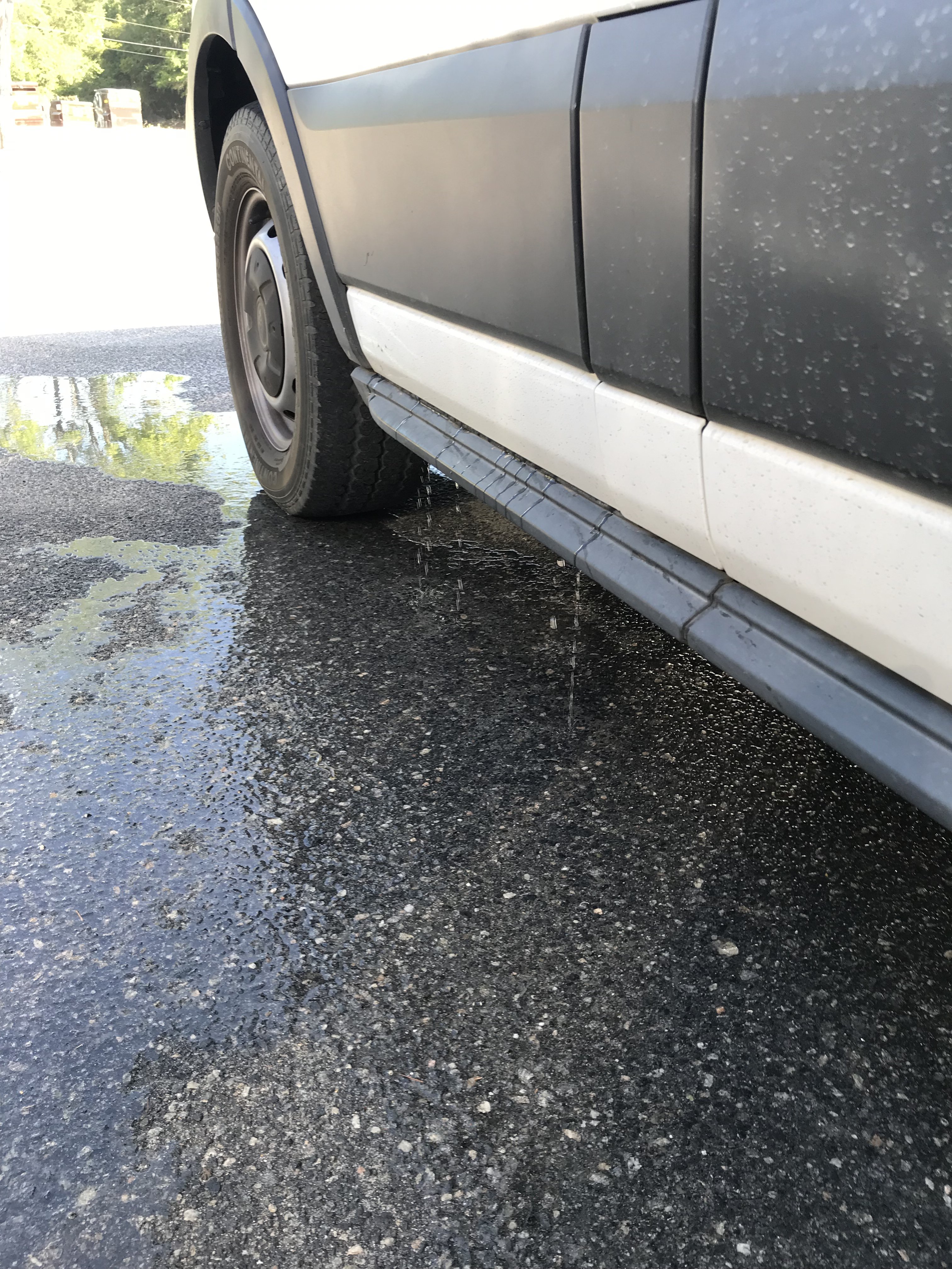

I hate when that happens. Because of all the sloshing around it plays hell with you shut off. We put in an overflow tube using stick radiator hose. A few simple fitting and most of it will drop through the floor warning you.
I’ll do that

Mine did that this week and it only needed a little adjustment. The float was going too far down when the tank was empty and was getting hung up and wouldn't pop back up when I filled the tank. There was an easy adjustment bolt on the arm of the float that took care of it.

I had the issue last week. I use a dema float. Very reliable but when they go, they just go. I like the idea of an overflow hose. Keeps it out of the van at least.
Reactions: Trip Moses
Check the rubber nipple on the plunger too. They are a wear item and need replaced periodically.

How long is the float rod and float.
The shorter the better.
