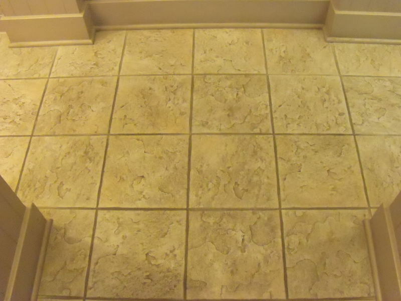

One of my regular accounts finally let me at the Tile & Grout. What do you think ?
Before

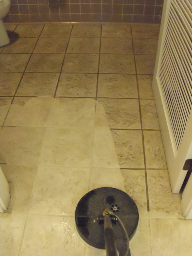

During

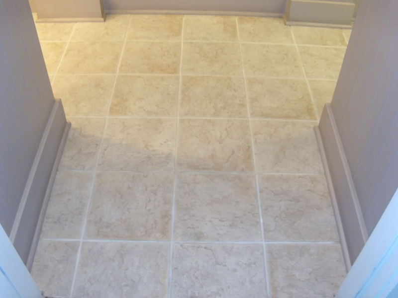

After

I would like that one for a brag book. Nice.
The edges do still look dirty from where the spinner couldn't get. Did you get those by hand to make them match? Do the "turbo tilt".

Yes we had to do some hand work due to the muddy mop water being pushed wall to wall. Turbo will not tilt.

LOVED IT and was blown away. He had never seen the true color of tile or grout.

Edges are a pain.
I usually like to run the Gekko edge tool around the perimeter before blasting with the spinner.
I've been playing around w a couple different tile and grout cleaners.
I like the Cobb Powermaxx but was very impressed w the Judson O2 last couple times out.
What cleaner did you use?
Looks nice...

Turbo Tilt = Lift one side of it and spray the bejeezus out of the wall and edge of the grout.
Works like a champ. Do it and never look back.

Use your tile brush against the baseboard and scrub the lines accross the tile the best you can then lift the turbo and spray it out and suck it up. It by far is the quickest and best way to get the base. If the customer has gotten the tile filthy on the edge then they have already gotten the base just as wet as you will.

Good job Chris!
