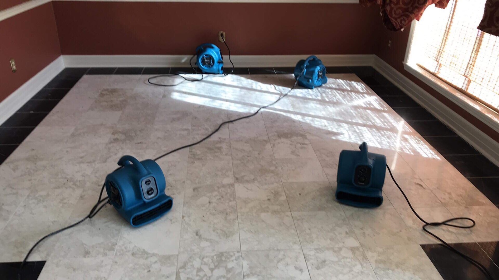

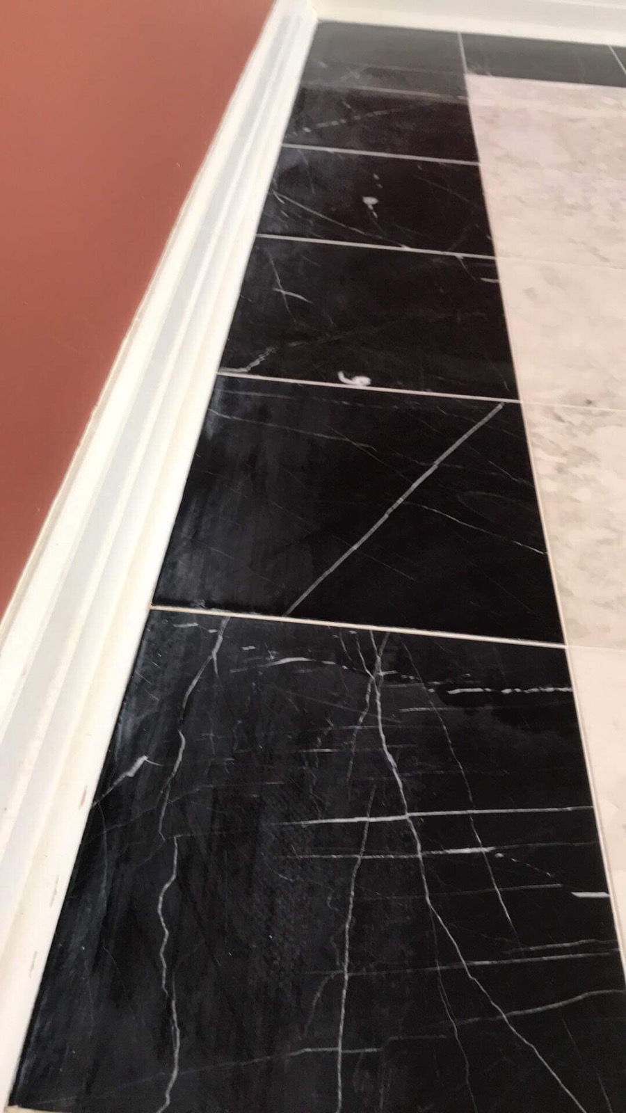

new guy uses RA's Grout Master, which is Magic Wand's Oxy Blaster on a polished marble.
Cleans up well but due to the 02, is now dull.
So he uses a pad driver under his 36 pound Rotovac 360i and polishing powder to try and bring the shine back.
Now the haze of the powder isn't coming off..
just awesome.
