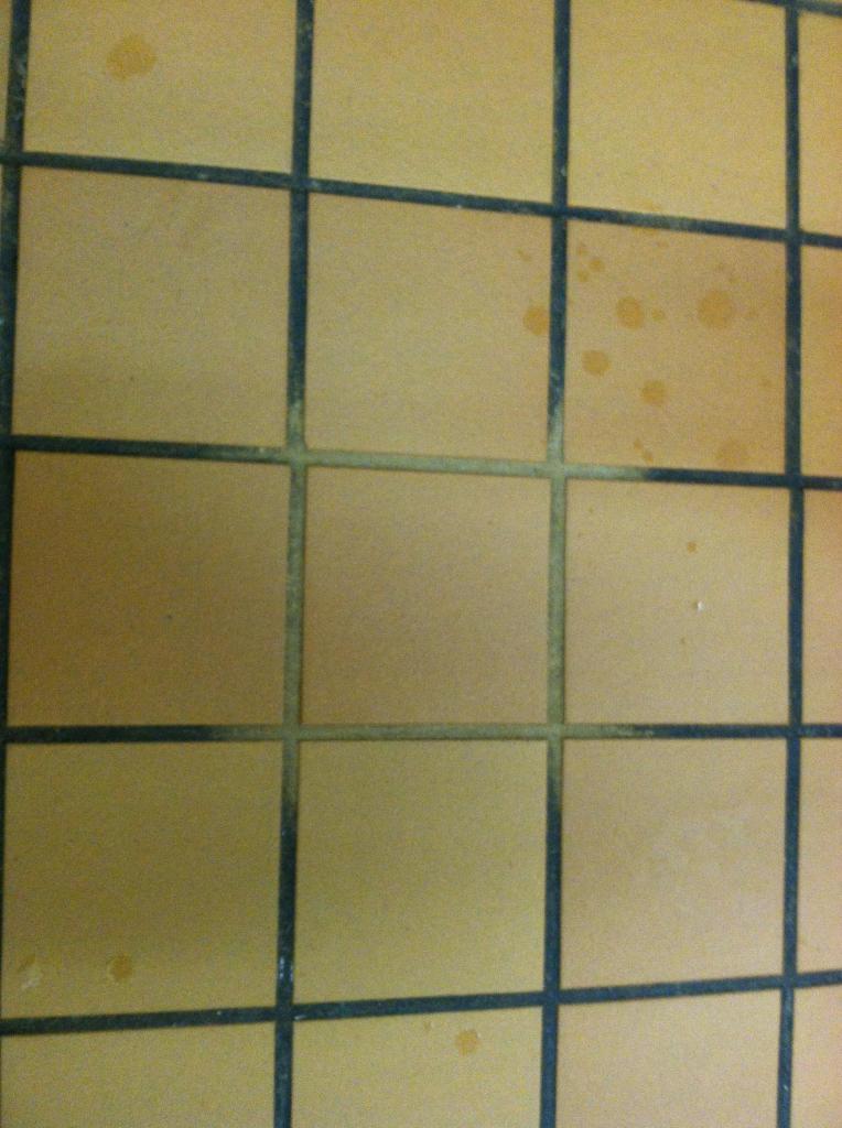

Do you recommend sealing a commercial Kitchen??
Looked at it today, 20 yrs old 6 inch quarry but they are tan.
Nasty grungy grout joints. Never been steamed. Gets mopped 3 times a day.
Don't want to rip them off if it wears off in a few months.
It's a Battered/Abuse center for Women.
Flex straight from HydroForce with soft brush for demo
S
Shane Deubell
Mikey and anybody else
Not in general, kitchens usually use bleach or other harsh chemicals that will eat sealer off pretty quick.
