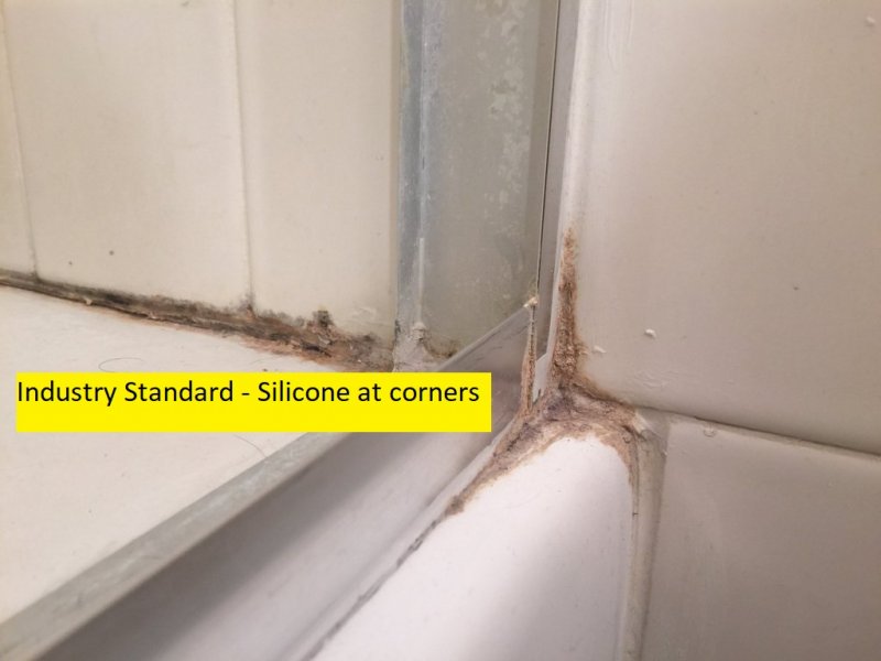

TCNA does require sealant for change of plane areas, I mentioned that before, scroll up and you'll see that I probably mentioned that a few times. It's no secret. Silicone happens to be one type of sealant, there are others and that information is available online to the general public via The TCNA website for those who would like more info that.
Yes, SGA has not been approved by the TCNA, nor is on our list of things to do. We, and what I mean by "We" is that the Tile/Grout restoration industry understands that those recommendations (as that is all it is, a recommendation by the TCNA) are outdated. Again, I'm not alone on this. I said it before and I'll say it again, there is a HUGE disconnect between the Tile installation industry and Tile/Grout restoration industry. The TCNA is centered around new installations which is the exact opposite of the restoration industry. Most contractors, or non contractors who install tile rarely ever see there work again. However, the restoration industry are those who actually see how these outdated methods are performing.
Why is it that I get phone calls everyday from individuals who want to know more about SGA because silicone doesn't work in wet areas. I'm talking homeowners, DIY'ers, Contractors, Non Contractors and Hotels. My Youtube channel has been a great resource for this common issue.
Now I'm sure you will have something to say about how SGA is not TCNA approved and that you live by the TCNA handbook because there's a reason why epoxy shouldn't be used at corners, but I just did that for you so no need to keep repeating this debate.

Here is the problem Jason, as a contractor, my concerns are your epoxy trapping water behind the tile. Or Any near waterproof “sealant” for that matter.
Whether it due to Florida shower construction, Florida hard water or other factors, cutting to remove perimeter caulk and having water flow out, and often 30 minutes latter it still flowing, tells me there is water in the wall cavity. This is why caulk mildews in first place. Now we’re going to replace the water proof silicone with your waterproof epoxy grout.
Do you not see the potential problems?
Impregnating sealers work well and have there place, however like you said, your not going to water proof the wall structure in a shower.
I find it kind of ignorant on your part to assume every shower is build like you build it.

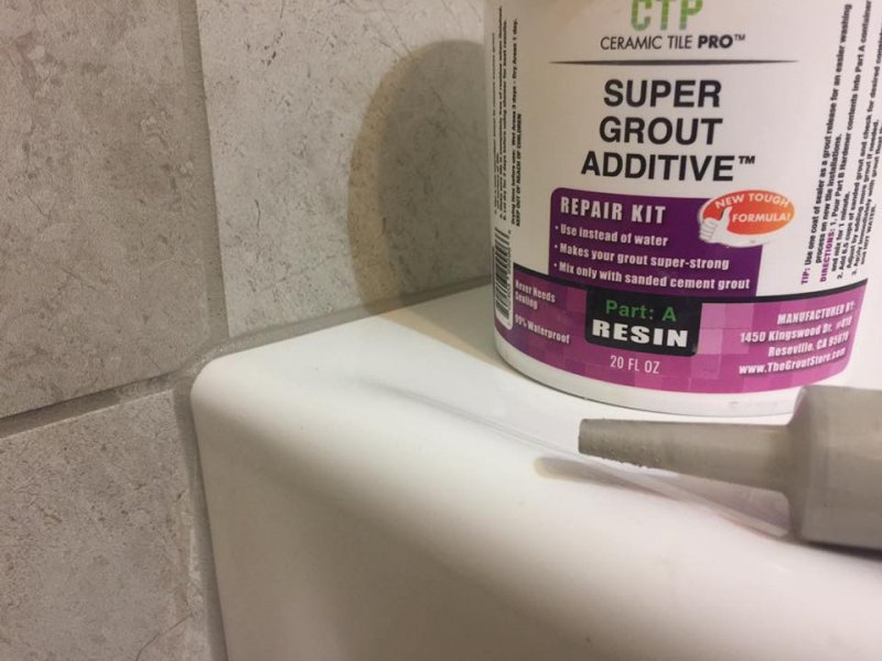

1. This was introduced to me after I left the field full time. It was brought to my attention by Mike Holm (Caulkmaster) who is a longtime customer of mine. He is incredibly meticulous and detail oriented and so I trust him when he tells me a product works great. I contacted Jason and became a distributor approximately 10 months ago. My hands on experience with this product is limited to its application
2. I do have several customers that have outright replaced caulking and silicone with this and so far have had no issues.
3. The name of the owner/creator of ColorClad is Mike Skala. He passed away nearly two years ago and is no longer available to comment. I had many conversations with Mike about his product and other chemicals. He was an incredible wealth of knowledge and taught me many things. He was a true asset to the industry. With that being said, his opinion of grout being the best option around a shower floor perimeter only applies in certain regions
In CA, it is required by code with a new installation to use a flexible joint material, such as siliconized acrylic caulk, silicone, or a urethane material where the plane changes. So where the floor meets the curb riser, seat, wall, etc., you must, by code, use a flexible material. Being on one of the largest fault lines on the planet, I see why this is the code.
HOWEVER, just because something is a standard, or a code, doesn't necessarily mean it is the strongest or best option.

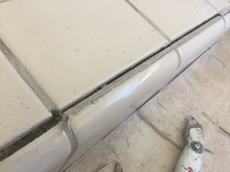

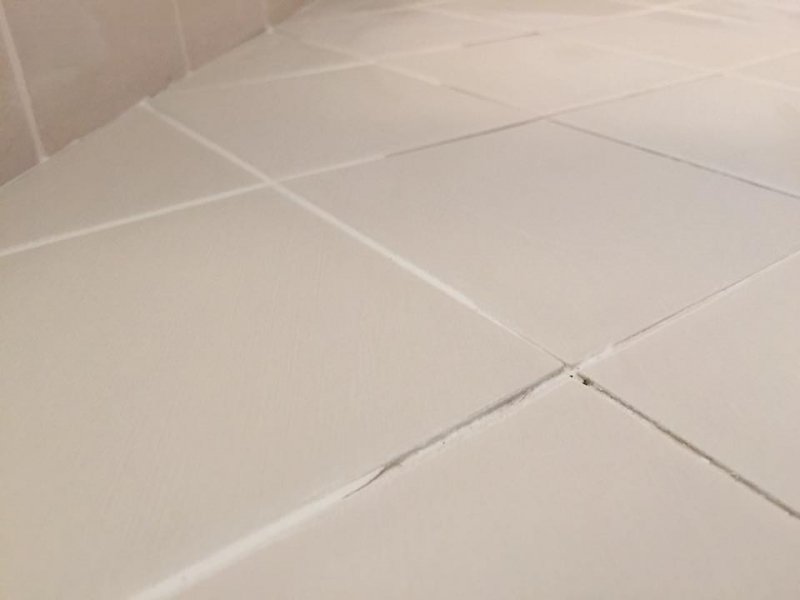

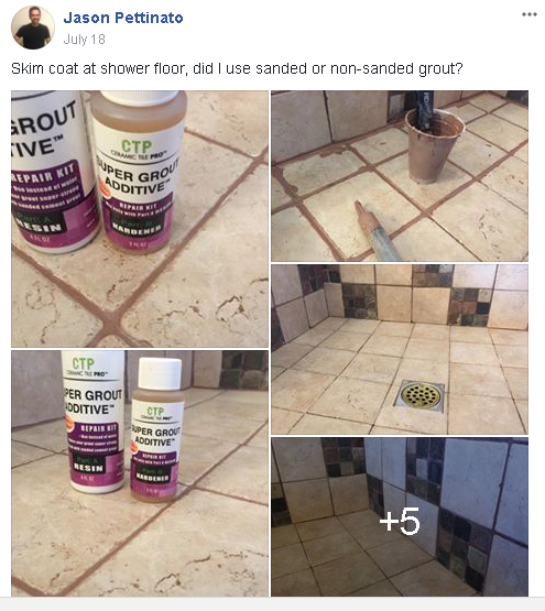

In my shower in my shop, the one that is used for training, was installed about 14 months ago. It cracked in the corners and around the floor after about 4-6 months. Non-sanded grout in the vertical joints, sanded grout around the floor perimeter. It was replaced with SGA and so far it has held up just fine. Obviously, this is a short amount of time to use as a gauge of durability and lifespan.
Some of you know my experience, some do not. While I am not a tile installation expert, by far, I have a lot of experience with all the steps, from concrete slab and studs to finished product and the restoration and repair of showers after the fact. So far, I have been impressed with SGA and I have no issues recommending it. Yes I am a distributor, but as most of you know, we offer a limited selection of each type of product so we only offer what I would consider the "best of the best."
SGA isn't for everyone. Some people will not agree with it's use, some people will love it and use it exclusively. Some people will use it sometimes. It doesn't matter, every product has fans and people that don't like it.

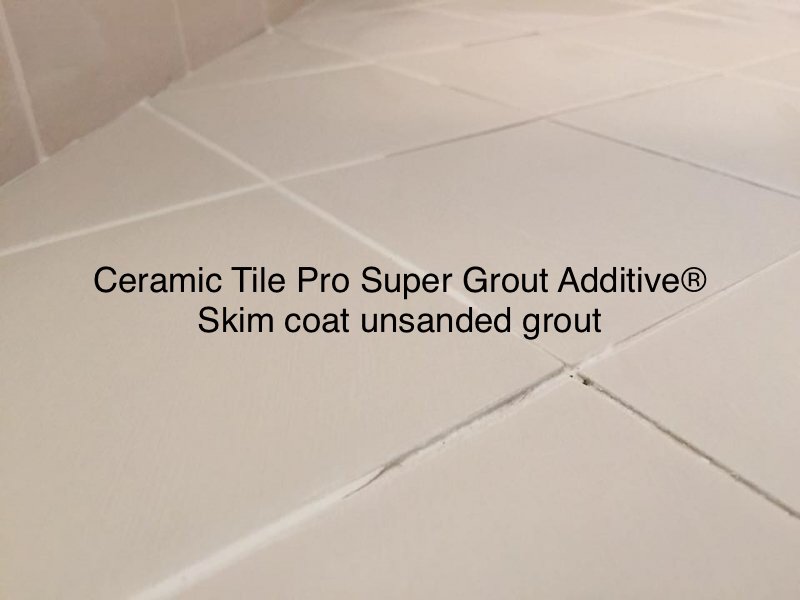

One of the HUGE benefits for me, is that it cures with a matte finish, like grout. It does not cure shiny like silicone or urethane. It is very strong. With a utility knife, you can cut out non-sanded grout. You cannot to the same with SGA mixed with the same non sanded grout.
Also, it cleans up with water. It's not as simple as wiping once or twice with a sponge, but the fact that it is water clean up is amazing.
One more thing, it doesn't alter the grout's color that much. It ends up a tad darker, but not so much that it's an issue.
If there is enough movement, SGA will crack, or possibly cause the stone tile to crack/break, but I would expect something like this to be a significant event, like an earthquake. I mean like 4.0+. We have earthquakes on a weekly basis here, 99% of them are not felt, but there is literally constant movement.
I am incredibly optimistic about this product and I think it will help a lot of people that install and service showers. If I was still in the field, with my limited experience with this product so far, I would have no issues offering a warranty

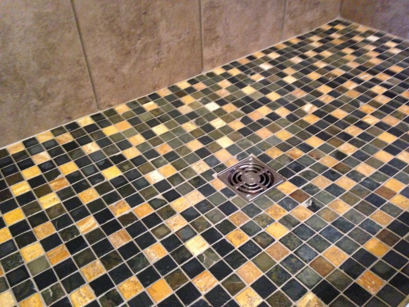

Let me know if you have any questions on the Ceramic Tile Pro Super Grout Additive®. I am the inventor and distributor and can help answer any questions about the product. It's a 100% solids epoxy, nothing magical but it works really well as a silicone/caulk replacement. We have a number of grout cleaning/restoration companies using it nationwide including a few well known franchises that are also on board. I personally use it for my tile contractor business including new shower floors. Please visit my Youtube channel for a number of videos that show me mix and apply it. thank you - jason

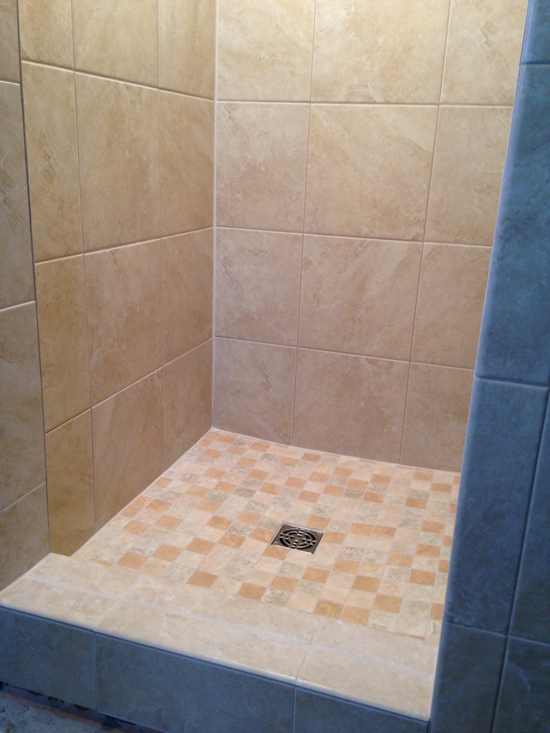

Jason, I'm intrigued enough with Super Grout Additive that I've ordered already, to use in new walk-in shower floor tile install over KBRS Tile Basin (over mortar base on solid 3/4" subfloor). My question is, how do I apply SGA (mixed per your videos with Mapei unsanded grout) into gaps for pebble tile on floor, mainly because of the variable width of gaps, which can exceed 1/8"? Do I simply allow more cure time, or should I apply in multiple steps (deeper application first, allowing to cure between second app)? I'm just concerned that the extra thickness/width of material will have difficulty curing properly.
Thanks in advance for any advice
