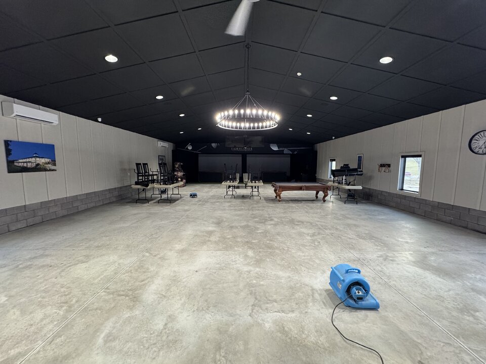

Well I just wrapped up the job. It was about 2200 sq ft of concrete. Took 6 hrs total but that included getting down and sniffing around a lot identifying where the majority of the smell was coming from. Flushed it really slowly after prepaying sections with Saiger sauce. It’s all brand new. Apparently the construction company poured the concrete then put the 30 day sealer on it. Then when they went to put a polish look coating on it, had a horrible interaction and it was all messed up. So the coating company told them they had to strip it all off. And they did but it left this terrible chemical odor.
I followed the advice above and opened all the doors and set air movers outside blowing inward all day long. I did notice when I went too fast in a section, you could tell there were some jet marks where it was taking off some sort of residue. From getting on my hands and knees I could tell that 80% of th odor is coming from the cuts in the concrete. Where there was some sawdust or othr crap crammed in there that probably soaked up that stripper.
Just left and the smell is much much better. But will see how it is now that it’ll be closed up for a night. I told him if the smell is bad again we should try air scrubbers. Since I don’t own any, I told him I could either order one or two and rent to him. Or he could just buy them himself if he has use for them at other properties. Definitely one of the more interesting/ challenging jobs I’ve ever had. IMG_4996.jpeg
