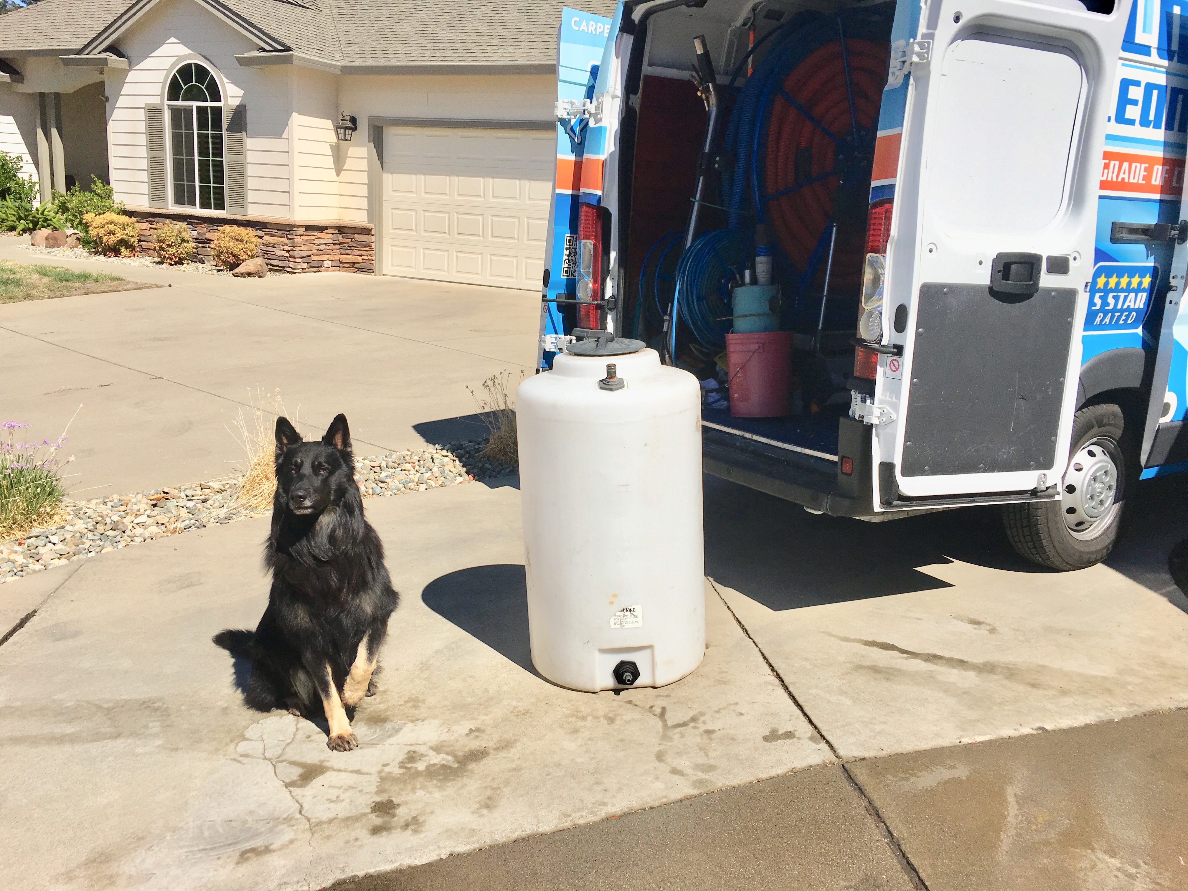

Today I was going to clean and organize my garage.....again. Well, that didn’t sound very fun so I decided to install a 65 gallon fresh water tank in my van that I’ve had sitting around for about 15 years.
This fresh water tank is a little more work than I thought. Having to go back and forth to Ace hardware many times for fittings. When coming home on my motorcycle with a backpack full of parts a bee 🐝 smacked my neck and stung me right on my adams apple. It hurt like a bitch. The entire way home I thought my throat was going to swell shut and I would die. My family would be told I died in a motorcycle crash, never knowing the truth that a bee had stung me in the throat and my airway swelled shut, causing me to pass out and slam into a power pole. All the people that told me Motorcycles were dangerous would come to my funeral, look into my open casket, and say, “I told you so”. They would never know the truth of the painful bee sting and how I died gasping for my last breath as I tried to get home to my wife and kids, oh, and my dog.
Anyway, I’ve still got a little more plumbing to do but it’s coming together nicely. My roomy promaster is quickly becoming packed again.

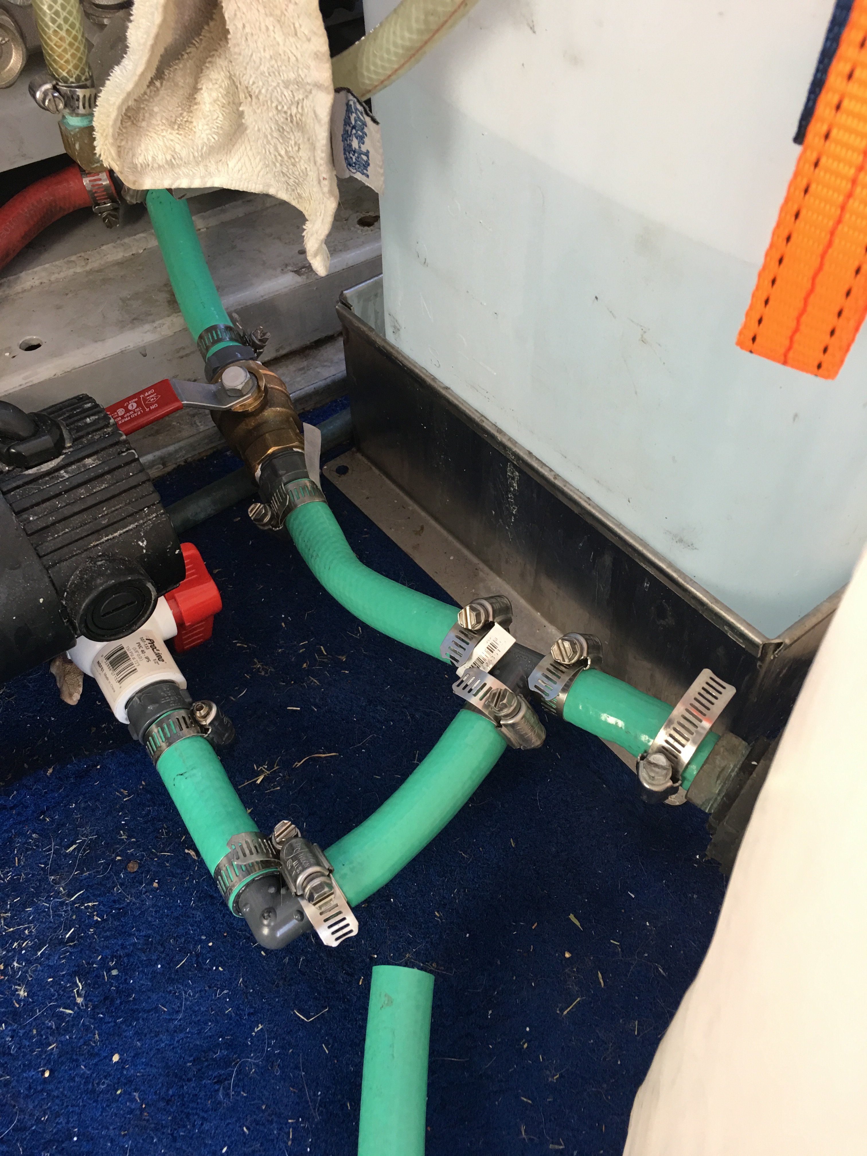

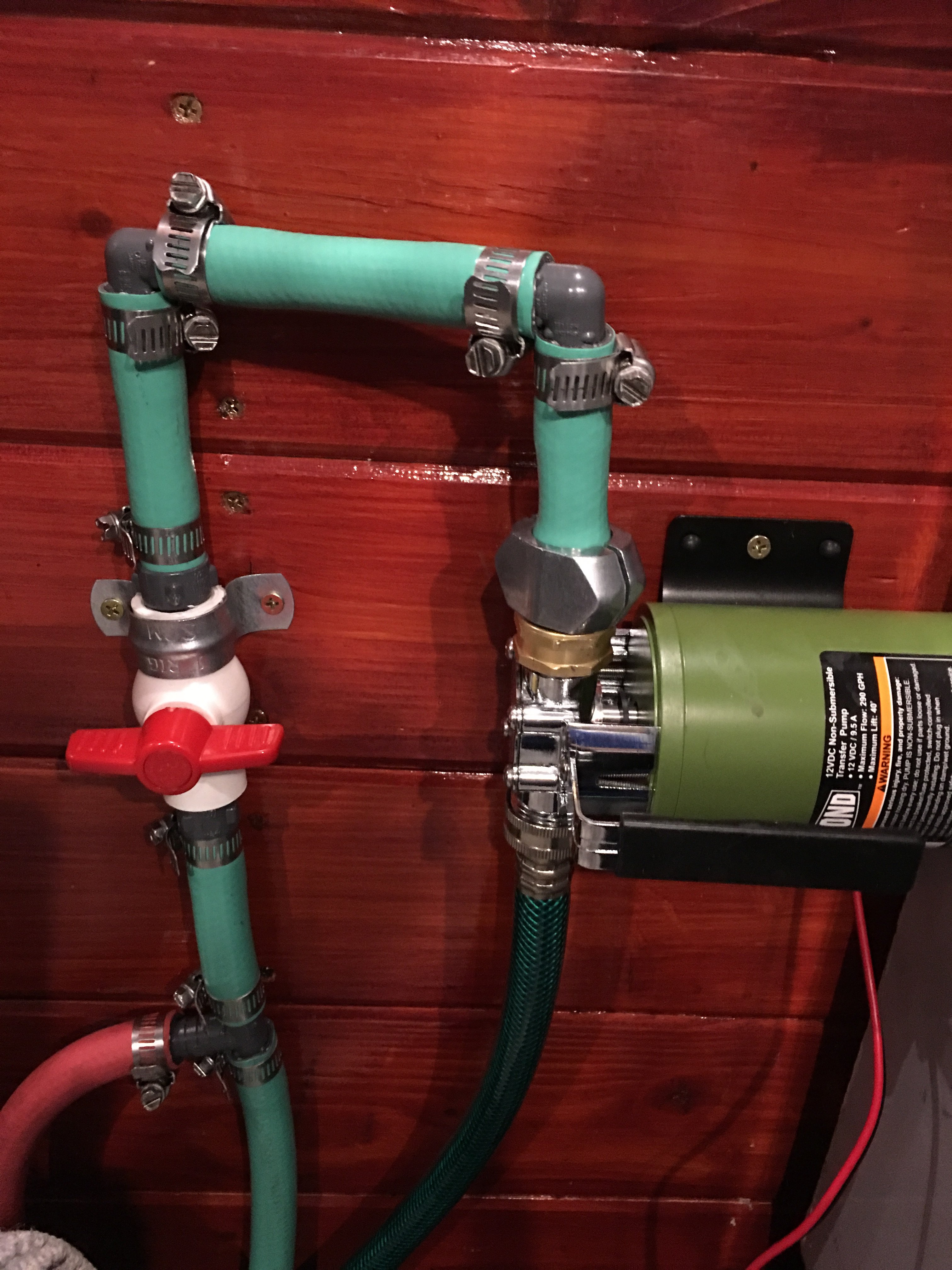

Got my tank in. Its plumbed abd wired up. All is working great. Do you like my Oaklahoma plumbing job? I alos put in a bypass also to keep the pump from overheating. I’ll be adding some clamps and making things a little neater later. But its working and thats all I really care about.

J
JS41035
You need a check valve. The hot water from the water box will backfeed and nuke your transfer pump.
