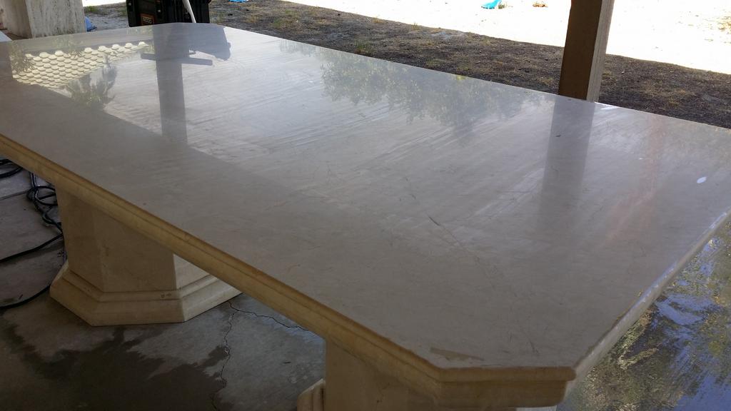

This is 800 Grit on Crema Marfil

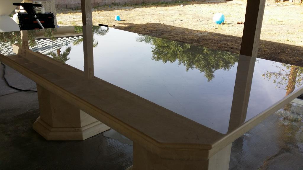

This is 1800 grit on Crema Marfil, no polish

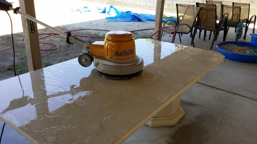

This is my test table in my backyard

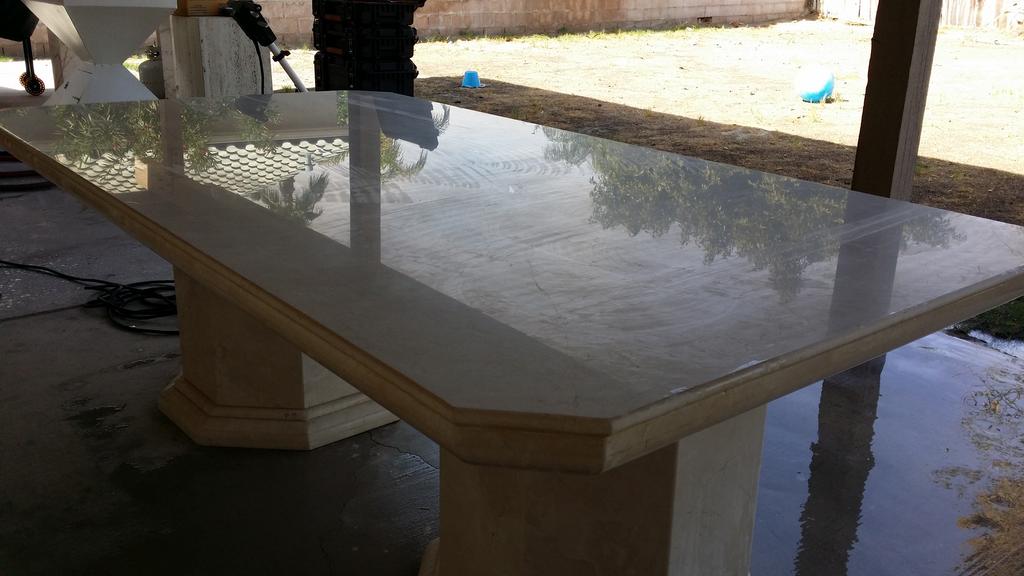

And here is the finished product after our Dynamite 5X

Bammm! Fantastic looking table Cameron. Cameron and Rob have both helped me out a lot. For me Cameron is more diamonds and technical (think stone specific), Rob is more universal. Both offer great support for their products and are there when you need them when you have questions. Support either of these guys or both...they are worth it.
