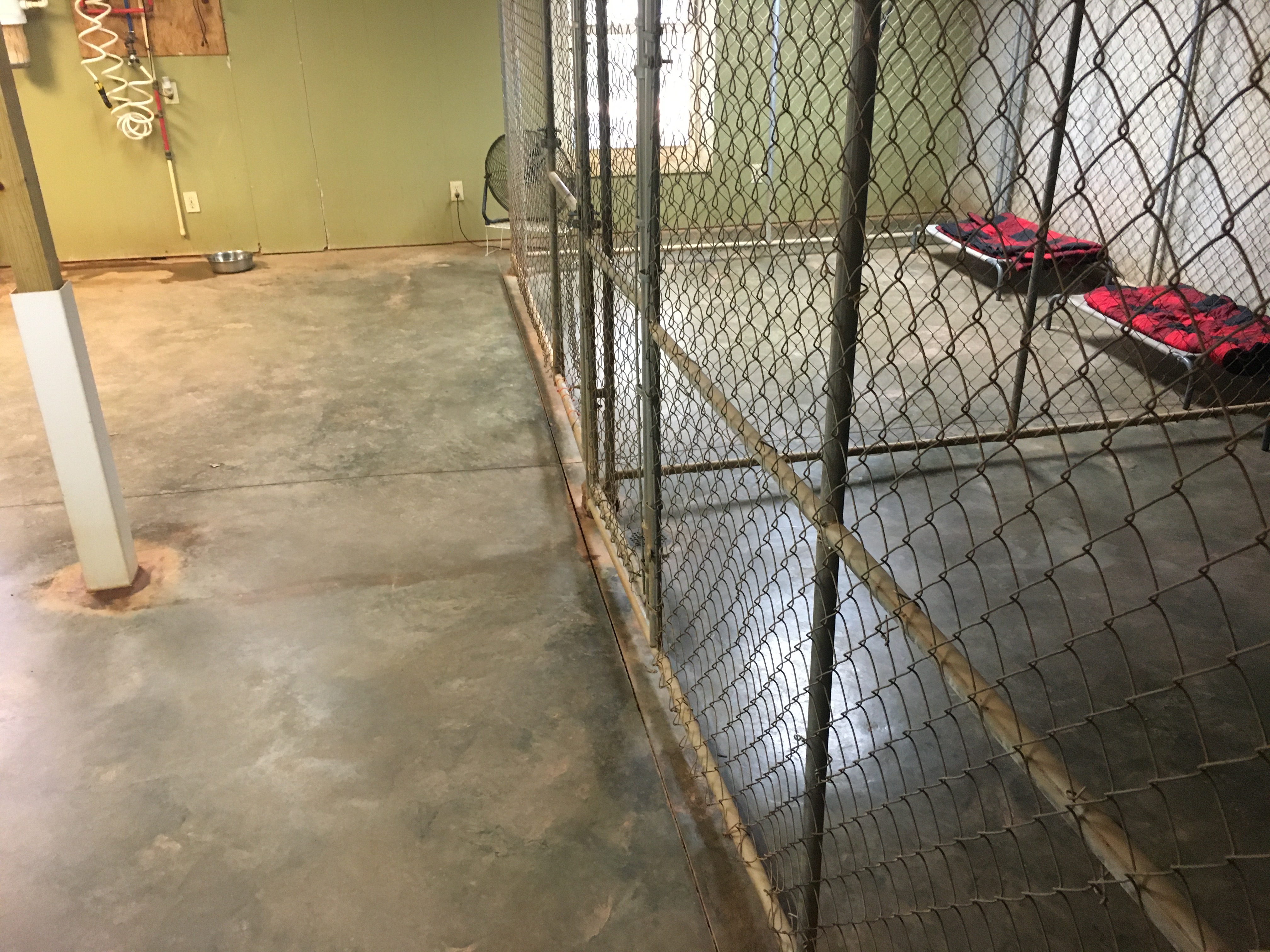

I want to know everyone’s choice of treatment on removing odor and funk

I know it'll be impossible and the homeowner knows it to. She's running some dog business out her home and this is in her basement. The room I was standing in was the other half of the basement which is a normal living area with a living room and bedroom. I'm thinking she's just wanting to get the smell under control. So they won't smell it in the living area
Is there a chance I could damage the surface of the polished concrete with etching it if I treat it with an acid rinse or an acid tile cleaner?
