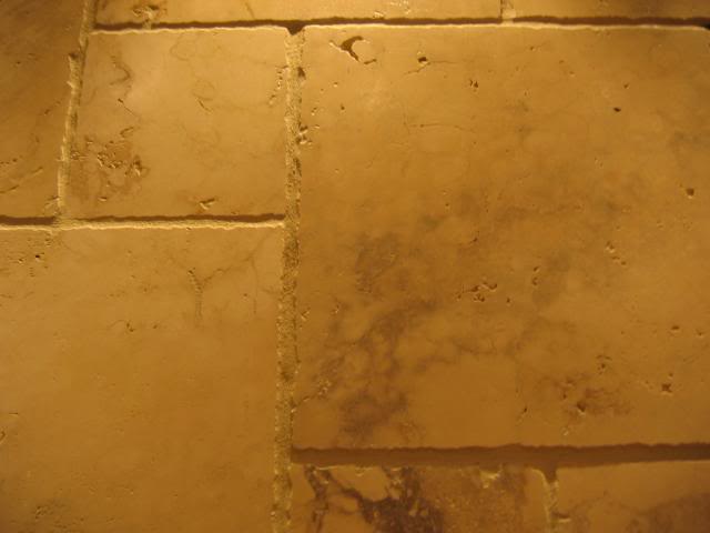

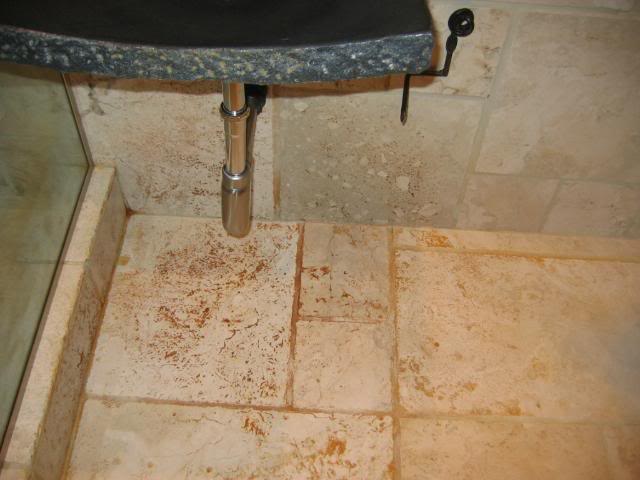

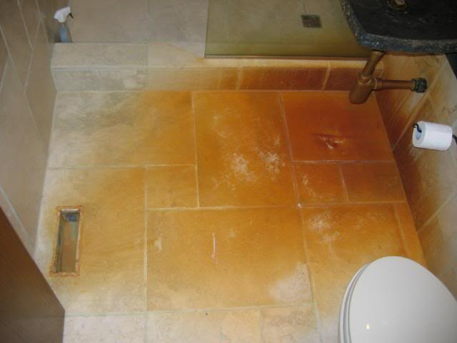

Attended a water loss recently, bathroom sink overflowed while customer was gone for the day. Well water with high iron content left staining on what I think is limestone.
This is a closer photo of the stone looks yellow because of no flash.
Can this staining be removed? Not 100% sure if the adjuster will accept things if they dry out or if he will decide to tear the bathroom out.

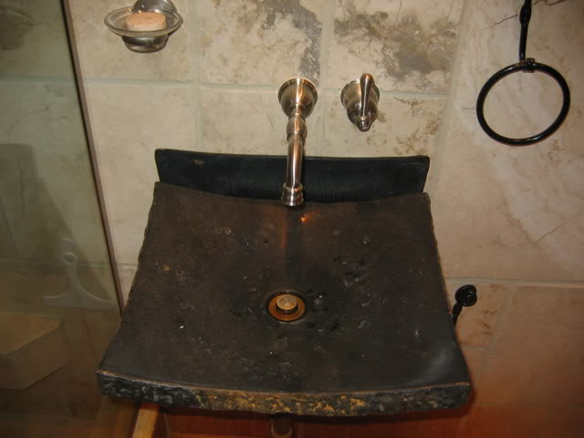

Also sink basin is made of unknown rock or ceramic and is stained. Anyone have a guess what it is made of?
Thanks Jim

Need better pics. possible using osr from pro choice to oxidize tile. Need closer look at sink.

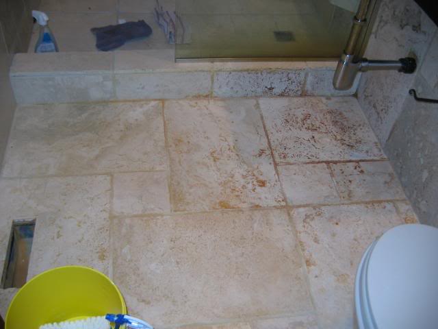

Better pics. The sink is most likley pre-cast concrete , looks to be about 1 1/2 to 2 inch. stay away from acids on sink and floor. Try using the osr from pros choice in small area for testing. let set for about 10-to 15 min scrub with a brush and rinse and see what kind of results are achieved. You may want to try stone tech klenz all on sink edge with brush, also add some chemspec energizer to the klenz all and try it on the travertine floor.Test in small areas first. I had some very good results on some white limestone that a cleaner used a red pad that crock on to the floor leaving it stained pink.

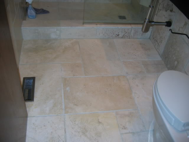

I thought you were kidding about the 40 vol.
All I have is some 20-30 vol...they arent specific in the msds and no way I was gonna mix that on my first stone clean up. I batched oxy blaster per directions and scrubbed away.
The results were great but was not able to get everything out.
What can I do to get the remainder of this staining out? Should I go to the local salon and try to buy some 40 vol.
The remaining staining is kind of blotchy and is in the grout also.
Stains did not want to come out of the pitted areas in the concrete sink either.

You can try a mix of Iron Out and flour in a poultice. If you need directions on how to make a poultice let me know and I will provide it for you

I think it's going to require an acid treatment to remove the remainder of the rust.
Mask off the unaffected areas and treat with an acid product and poultice.
You could use a oxalic acid (poison), acid power polish, or a phosphoric acid containing product.
Fred's suggestion of a reducing agent (hydrosulfite + bisulfite) is good for slight discoloration, but I think this deposit is more than slight.
Probably will require some polishing as the last step.

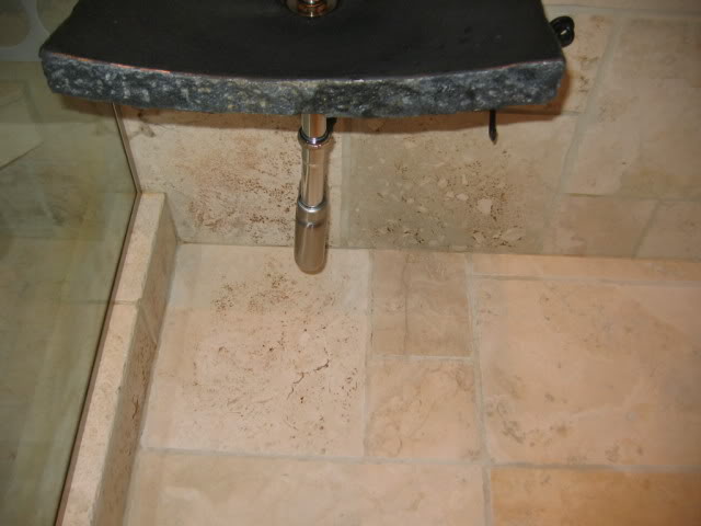

Thanks for all the help. Mike and Fred your suggestions worked great. The Iron Out was the icing on the cake...
