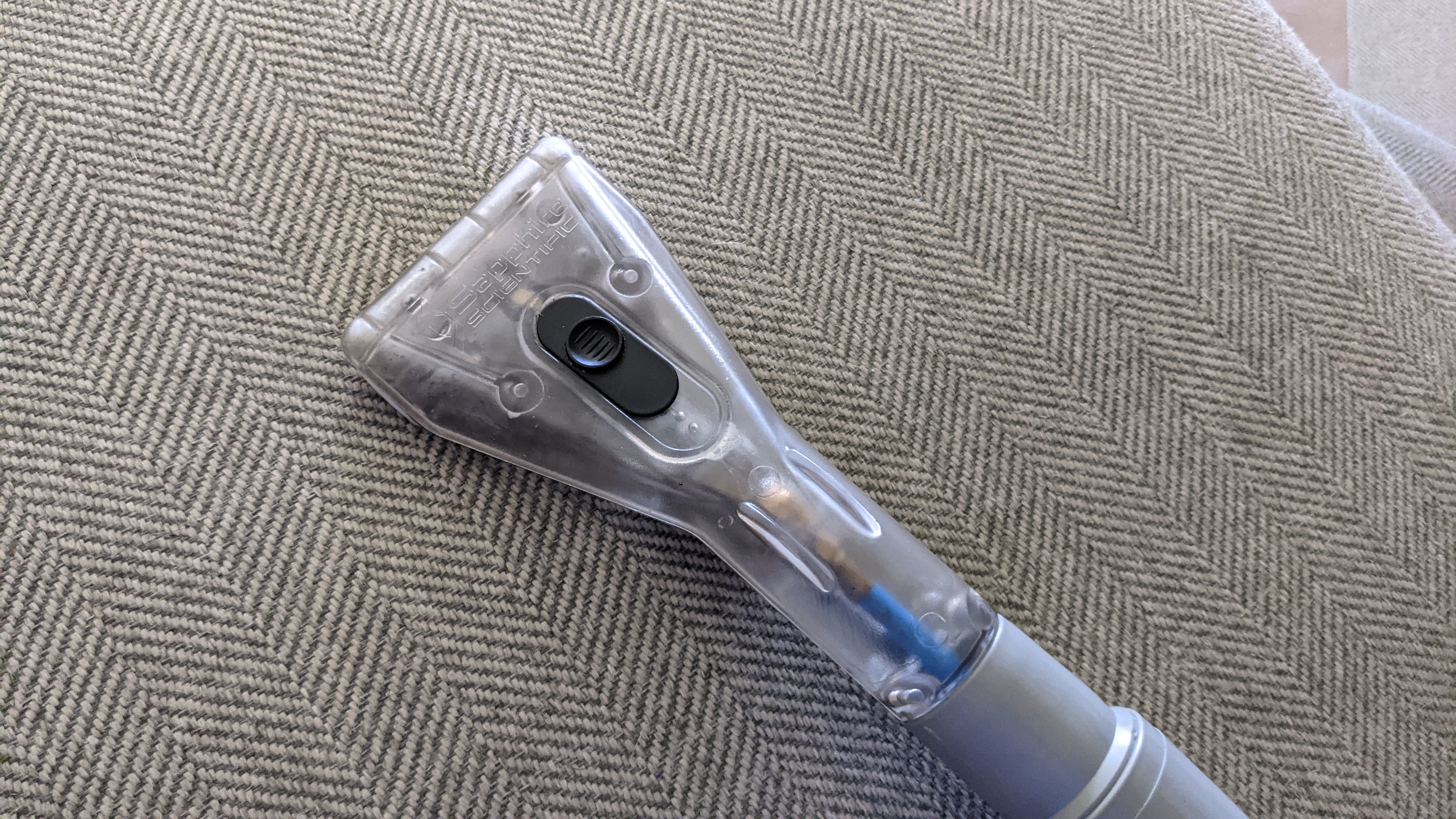

117,345
I presprayed with Silver Solution and rinsed with AFR.
the Dev window told me where to spend more time rinsing.
They're Jdubs so I'm sure ill hear about it if it wicks, again
whatever was spilled there isn't getting flushed out (or can't be flushed out normally due to beyond the backing)
sell 'em some poker chips .
so when the pre-spray makes them disapear, they'll know where more flush is needed
