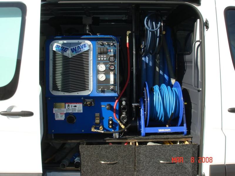

I have a customer with two sprinters with Blueline Bluewaves running gasoline.
He bought aluminum fuel cells from Summit Racing and installed a vented filler neck run to the outside wall of the van. He doesn't have a filler door just a cap. Looks a little funny but it's DOT approved since it's vented to the outside.

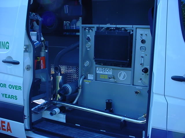

I have three Mercs now. 2x Sprinters and 1x Vito.
My two Sprinters are 2002 and 2004. The 02 is empty and used for furniture removals, carrying heaps of drying equipment, collecting supplies etc.
The 04, has has a Genesis 59SS in it from new, before they brought out the diesel. Awesome machine and mid mounted does not compromise the handling/safety aspect of the vehicle.
I removed the spare tyre and it's carriage from under the rear and had a fuel tank manufacturer custom make a unit for me. It has it's own guage in the front cab too.
The spare tyre thing doesn't worry me as most of it's work area is within 20-30 minutes of our shop, if we go further, we just put it in the back on the van for the trip.

rich ,i bought a dune buggy aluminum tank for 200 bucks of the internet , new. 14 gallon and mounted it under the van on the drivers side. a local welding shop put in a filler cap that exists the drivers side.
one of the best things i did is utilize the high ceiling and build extra shelves under m machine.
i have 12 inches of storage ( i have the shortest cieling as well)and five feet deep drawers.
