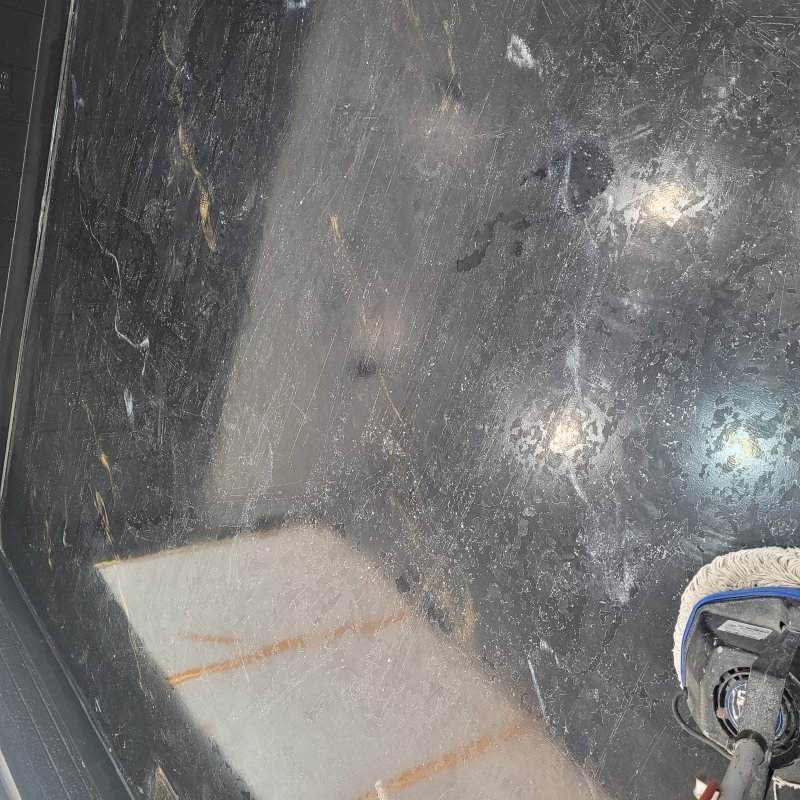

If you zoom in , you'll see flaking off already in the progress. I wanted to spark curiosity and responses, so I didn't mention that I took care of the problem for old time's sake. To make matters worse, they applied sealer with a mop head ( I'm not even sure it was a clean one) , and didn't let it cure before the subsequent coats.
Hopefully, they learned a lesson.

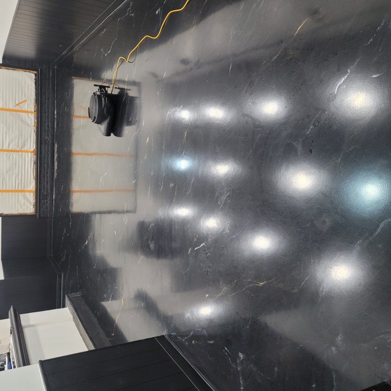

Too many things went wrong. I was hoping for one coat only , but I was wrong. Scorching hot water mixed with ZEP stripper, and a lot of TLC did it. I suspect that the epoxy floor wasn't done right to begin with,
