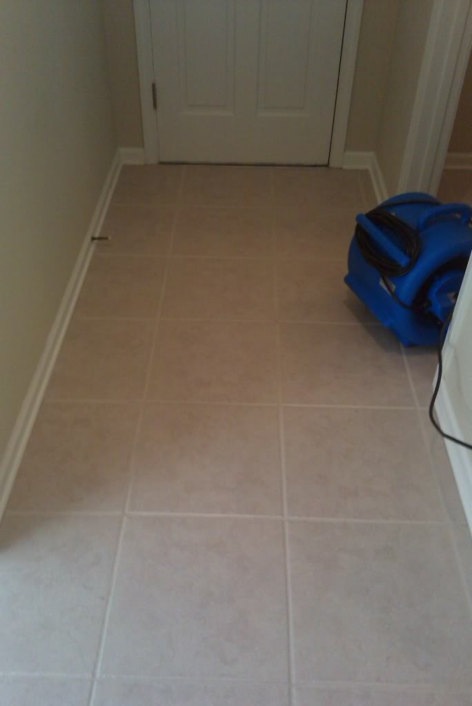

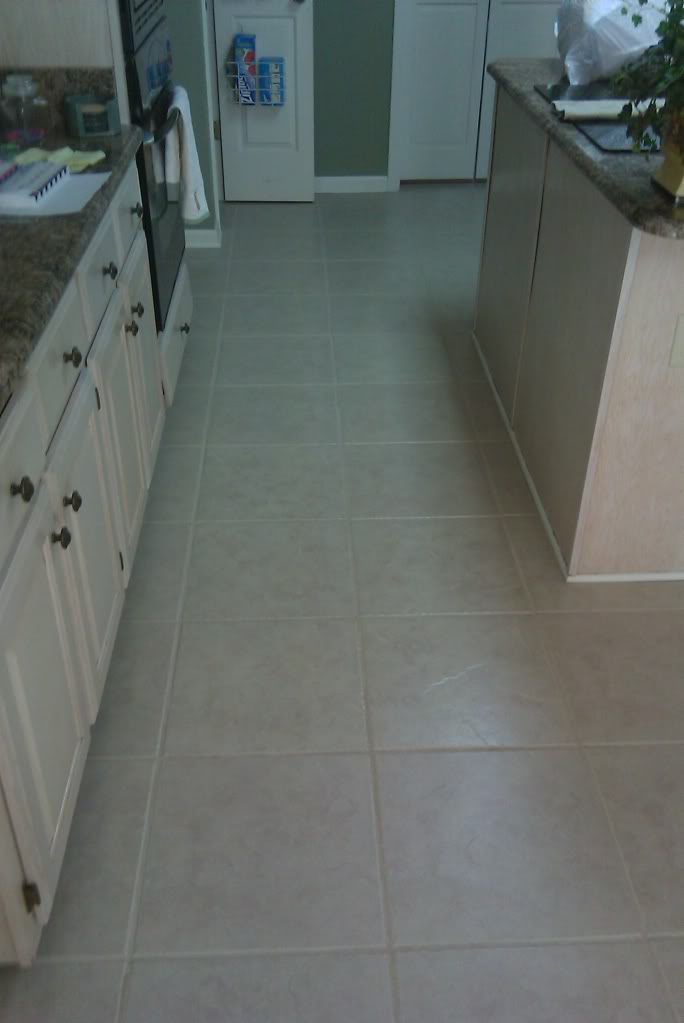

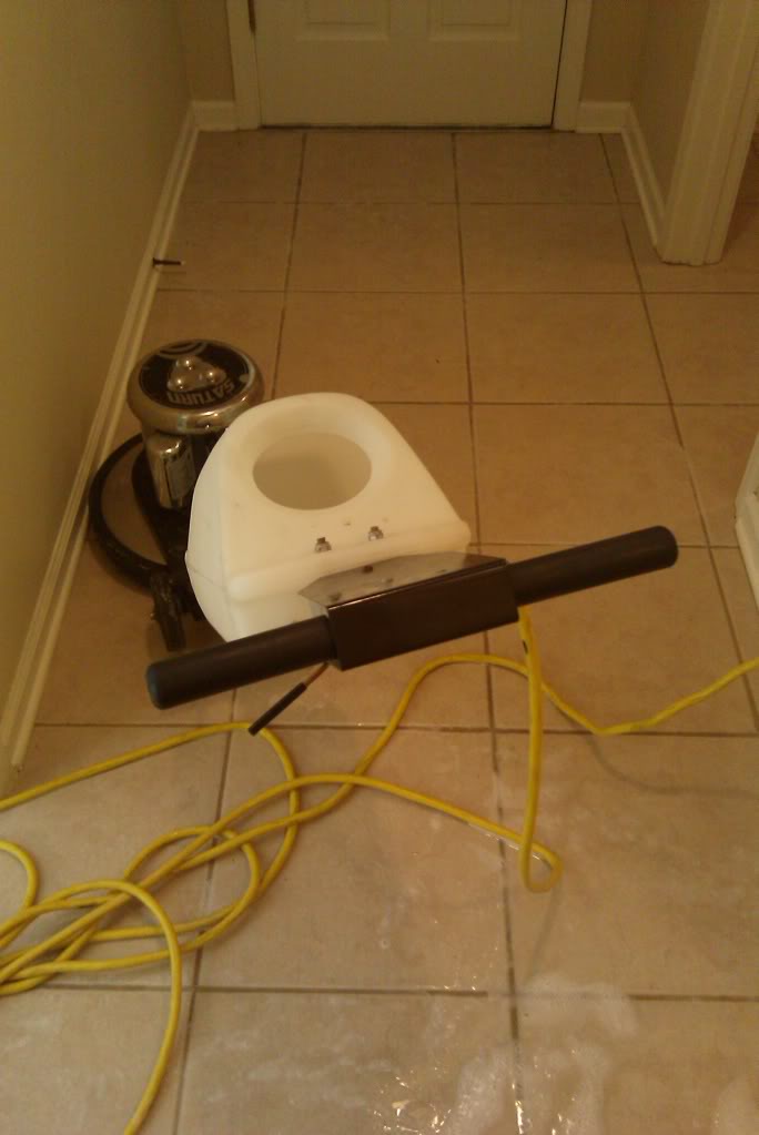

I really need to get a brush to scrub under cabinets and corners. I currently use a regular grout brush to hit these areas first and then I go over the whole floor with a 175. I spray the floor first and then when I go back with the 175 I shower feed solution to keep the floor wet. I have tried the 200 dollar stiff nylon brush that is really for scrubbing concrete and a adjust a glide brush. My brush is pretty worn so today I took the glide section off. The brush still glides over the top of the tile and doesn't dig in unless I tilt the 175 up on its side. I feel the chem will do its job if enough dwell time is given but sometimes I run into a situation where I have to go back and scrub the floor. Now I put extra effort into the aggitation portion. What do you do to scrub tile?

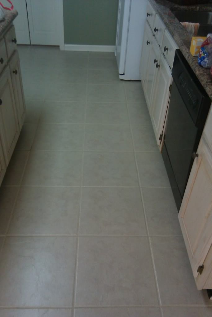

I have tried several tile cleaners including strippers. If the floor is dirty they will clean the floor with dwell time. If the floor is stained from the customer mopping with mop n glo or pine sol it is going to need to be scrubbed. I have a new chem I am going to try next time. I hear it just needs to be spread around and then sucked off. We shall see. The photos are after scrubbing for thirty minutes with a 175 and grout brush.
