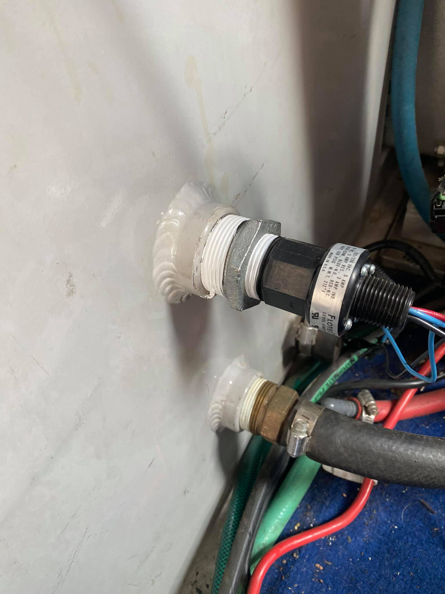

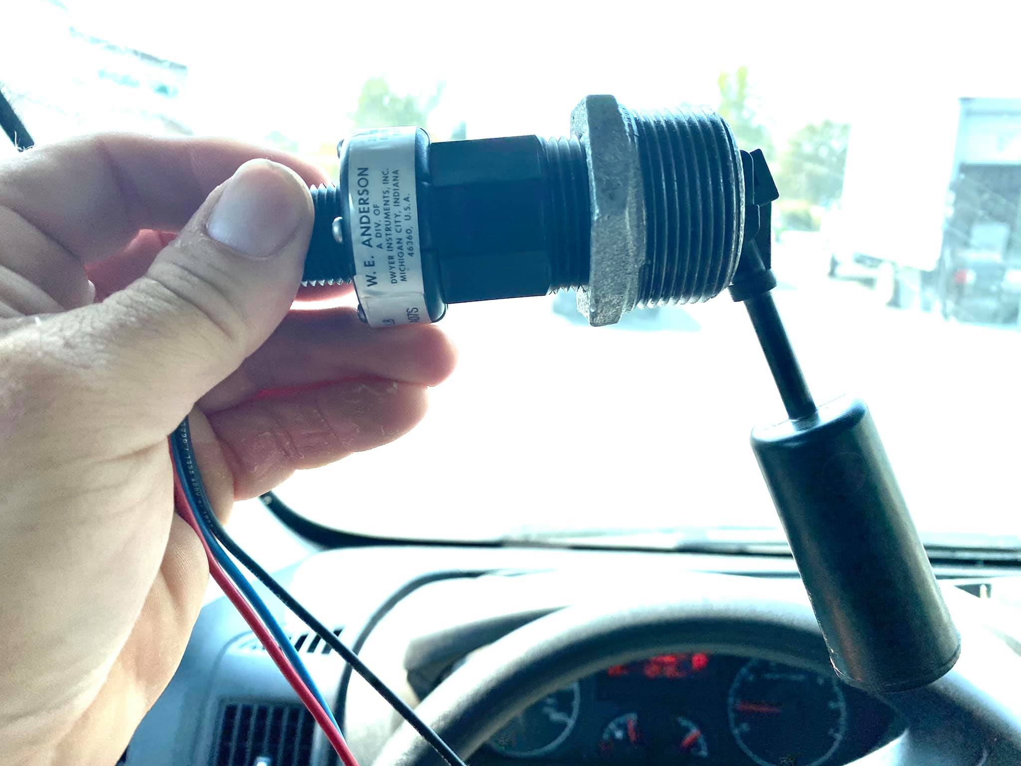

I finally switched out the float for a different brand. I bought the float switch off Ebay for about $35 and got a second one for $28. I believe new they are about $45-$60. The floats I ended up getting are called "Flotect level switch L8". The new switch was a bit smaller than the Harwil so I needed an adaptor to reduce the hole on the waste tank. A simple fix with a trip to Ace Hardware.
The new switch seems better built than the Harwil. The plastic housing is thicker and just seems over all better built. Switch has been installed a little over a month so far and working great. I hope to get much longer life out of it when compared to the expensive Harwil. The pick below is of the float with the reducer installed. Then the other pic is it installed on my waste tank.
