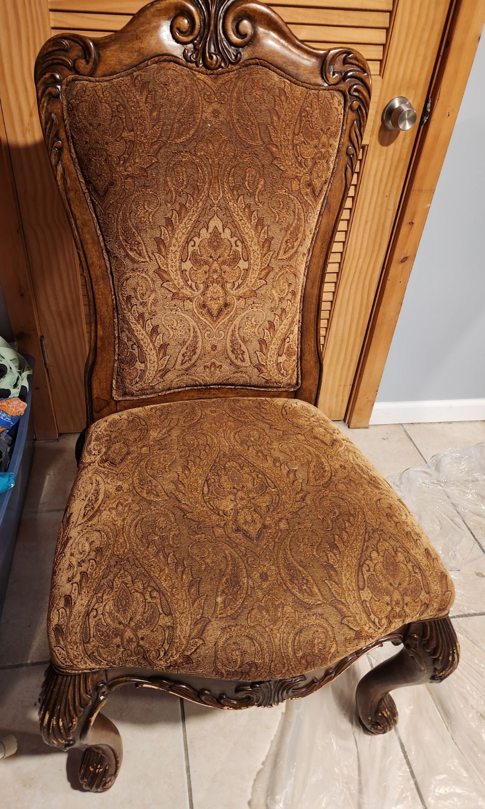

Apologies in advance for the long winded description. I'm walking into a potentially very stupid job tomorrow morning at 8am. The client has 7 old dining chairs, likely upholstered with cotton or a cotton blend, with an attached cushion on the seat and back rest, the rest of the dining chair is a wooden frame. The customer complained of an odor in the cushions (likely foam cushions but not sure yet), not from urine but rather musty from being stored in a garage or basement.
So far I am planning on informing the customer (my wife and secretary is currently in training, and so am I 😄) that since the cushions are attached there isn't anything I can do without risking damage to the wood frame and the natural fibers it is upholstered with due to any effective treatment causing it to remain wet for an extended period of time. Letting them know I can attempt an off-site deodorization that will cost them 4x as much, have a high probability of damage, and they must sign a waiver of liability.
If they agree deodorization isn't worth the attempt, then proceeding to use an OP method with distilled water for even wetting (misted lightly) and a neutral cleaner (Bridgepoint's OxyBuff, again misted lightly), followed by rapid drying, and time is the only safe (possibly effective) remedy for the cushions. If they prefer me to take it off-site and sign off accordingly then scouring through all the old relevant posts I can find here and asking for more current pointers from you wizards tomorrow night. Next time inform them of all this on the phone during the initial call. Does that sound like a decent plan or still pretty stupid?

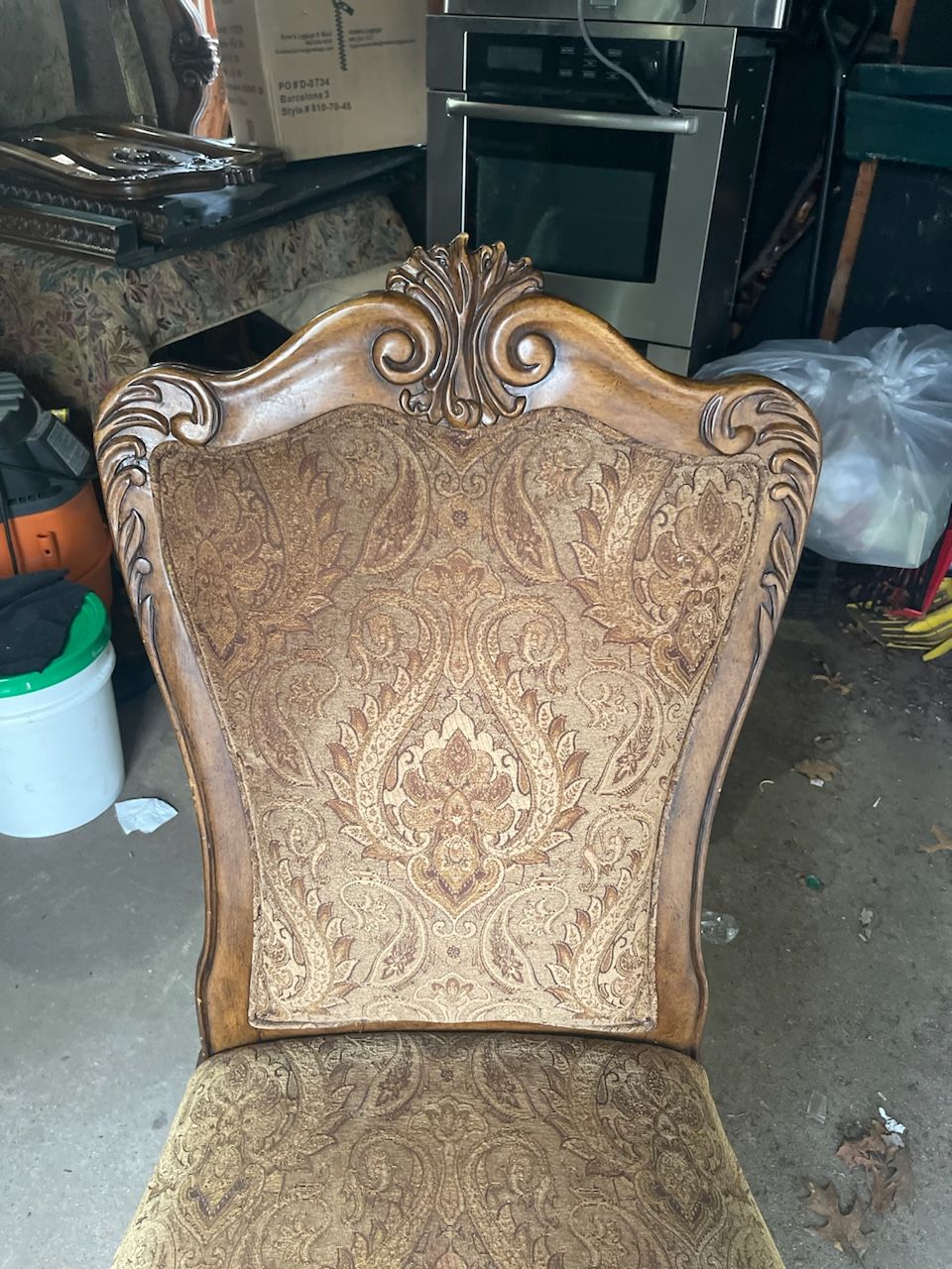

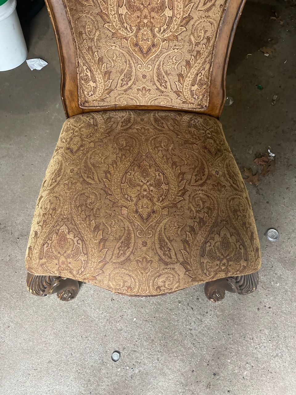

These.
Do those dark regions look like browning or soil? Dampen a cotton rag with an acid rinse and weigh it down on the dark region for a bit to see if it pulls brown to identify the cause of discoloration?

I'm sure it's unlikely, but are you able to get a piece of fiber from an inconspicuous area?
Do you know if the customer ever attempted to clean them?

Well, you were right
About what, that they look pretty cool?
Good call, I'll check all 7 of them to see if can get a piece of the fiber off to burn. Does it look like it could be a weird material? Didn't think to ask them about previous cleaning attempts. I will in the morning during our chat and inspection. If so do I do a ph test the dark areas or something to make sure I don't pull colors?
Its hard to tell from the pics, but it looks like something hungover the back of the chair and it sat like that for a period or time. Possibly could even be some UV damage.
You're more than likely going to need to treat the fibers as a natural fiber. I wouldn't worry about trying to do any type of PH test on the dark areas.
If it were me, I would hit them with a VLM approach to start with. I would start with Encapuclean Green DS and a hand buffing tool if you think the fiber is strong enough to handle it. If it does seem weak or brittle than carefully horsehair and hand towel. The PH is almost neutral in this product and should help correct any ph shifting and help limit any bleeding.(I don't think bleeding will be an issue, but you can always DyeLock) It will also help limit reactivating anything stinky in the cushion.
If you think you will need to HWE these chairs, I highly recommend the Avenge products from Bridgepoint or Prochem Upholstery products and rinse ( The liquid versions).
Air movers to speed dry on either process.

Awesome, Thanks for the tips man. That's really interesting about something possibly hanging on it and causing the dark regions.
I suppose Encapuclean Green DS will be gentler than the Oxy Buff product I had thought to use?
I don't have an eye for it but I've read silk has a sheen. If I do a burn test and smell hair, in this case would that likely be silk? If so can vlm technique still mess it up if I'm too aggressive?

There's already damage, note that to the customer
I would prespray ultra TLC pros choice, had a great citrus fragrance.
I prefer a sapphire upholstery tool rinse with last step.
Lower psi use the flow valve to lower flow on tool and crack the vacuum relief.
I use a hand sprayer to mist the pre spray on
Terry towel any excess off wood, rinse with low flow tool.
Agreed as above.
I can walk you through the deodorizing options if you would like to call my cell. I’m up and happy to help Bryce

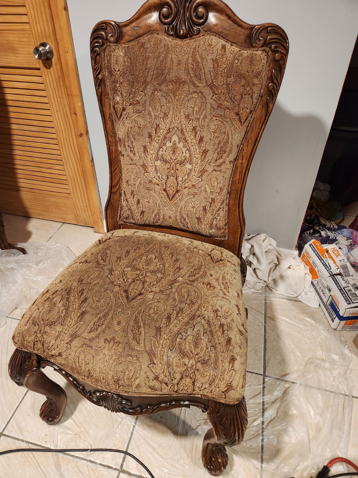

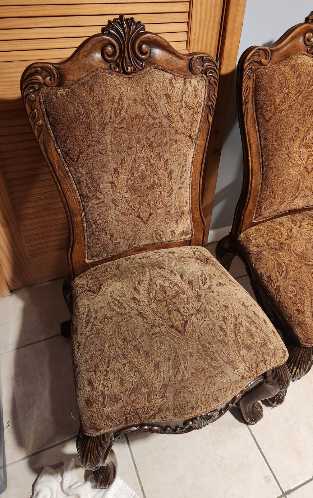

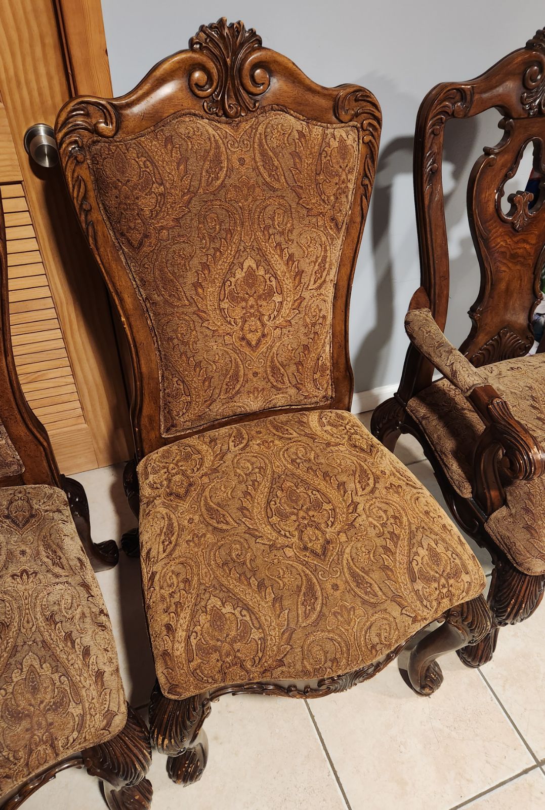

Happy Easter friends. The cool looking and possibly stupid to clean dining chair job went well yesterday 😁 I may of been foinked without you guys. Hard to say how grateful I am for all the pro tips, but thank you..!
When I met the client first thing he said is "can you clean them mon?", then I pointed out the chairs were already damaged and that there is a fair chance I can't effectively clean them at all, but we'll find out. I also inquired about the odor and described to him the limitations of deodorizing the attached cushions without running major risks of damaging the wood and upholstered natural fibers. He wasn't concerned about the odor, and I didn't detect anything substantial either.
Burn test showed it was cotton, and testing my neutral encap cleaning solution pulled a little bit of soil onto a cotton rag, but not much really. So I told him I can safely clean the fabric, however it may only improve slightly and I wanted him to be fully aware of that before I proceeded. He understood and was content with moving forward.
Vlm/op method was only making very slight improvements so I decided to carefully do a warm to the touch water extraction with minimal water through my low moisture upholstery tool first, followed by low vacuum gentle dry passes, then used a clean cotton rag with the orbital buffer right afterwards (which pulled a surprising amount of moisture and more soil from the fabric), then quickly put each chair in front of an air mover after I finished. Grooming each one with a horsehair brush.
The client sat and watched me the entire time. He was impressed with the process and I used the opportunity to educate him about the chairs while I was working, carefully tending to every part as I was cleaning. He seemed really impressed with my knowledge, professionalism, and attention to detail. In the end it took me 3 hours to do 8 dining chairs, next time it will take me around 2 hours in a similar situation. He was pleased with the results and gave me a tip. It definitely helped build my confidence and gave me a foundation to base future (higher) pricing off of. The chairs didn't make a miraculous improvement. But they all certainly improved, some a bit more and others a bit less. All in all it felt like a success!
