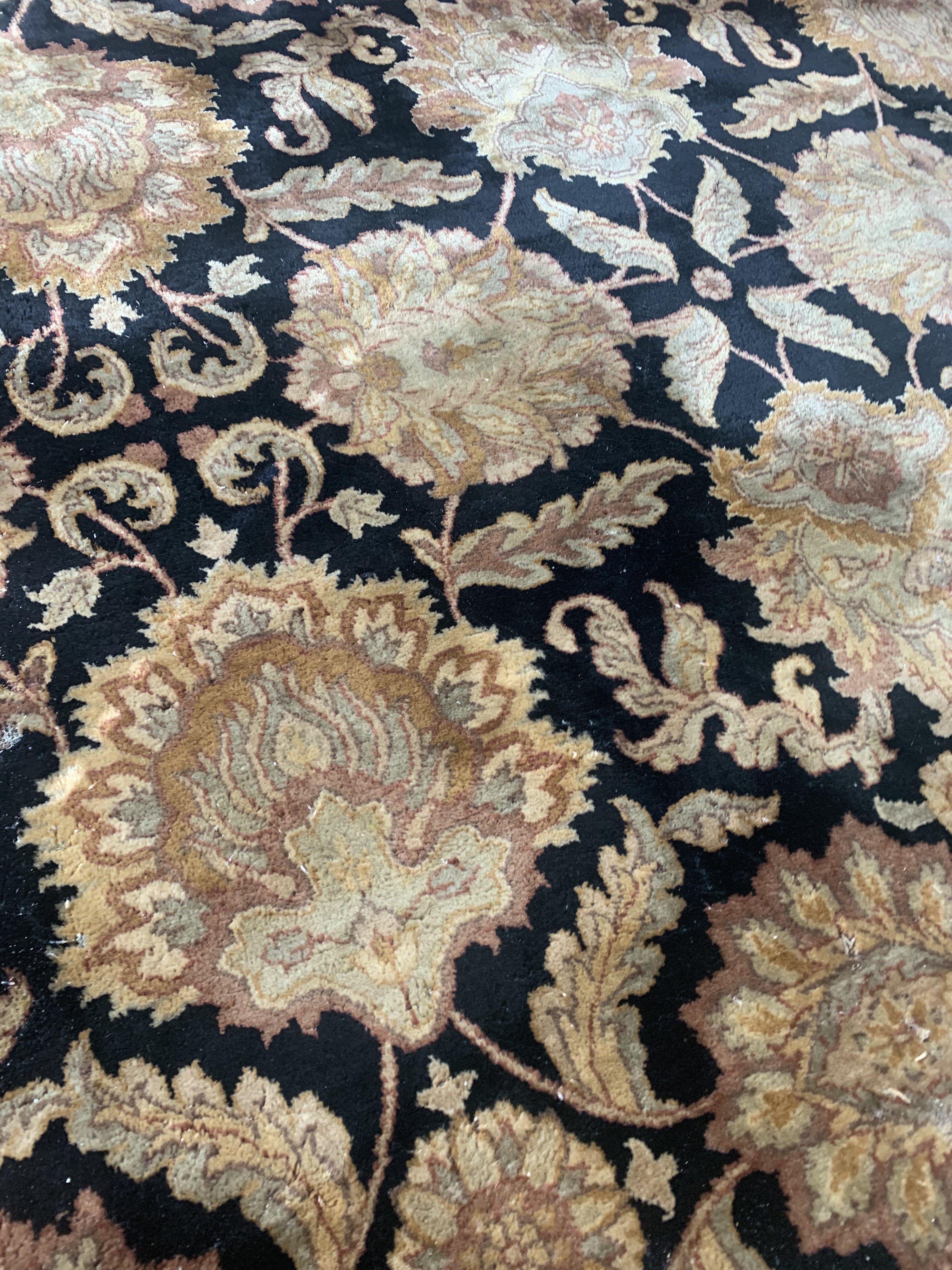

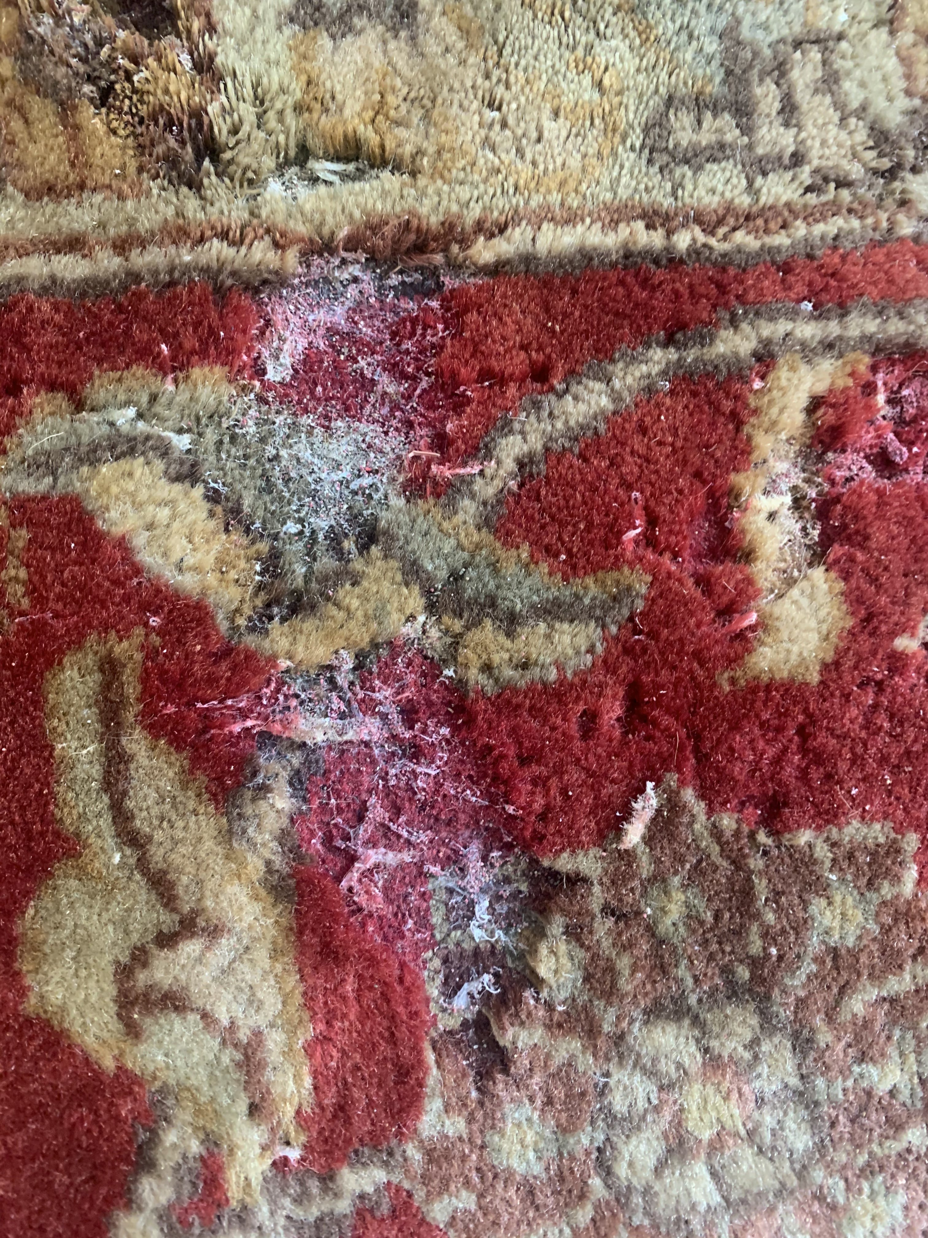

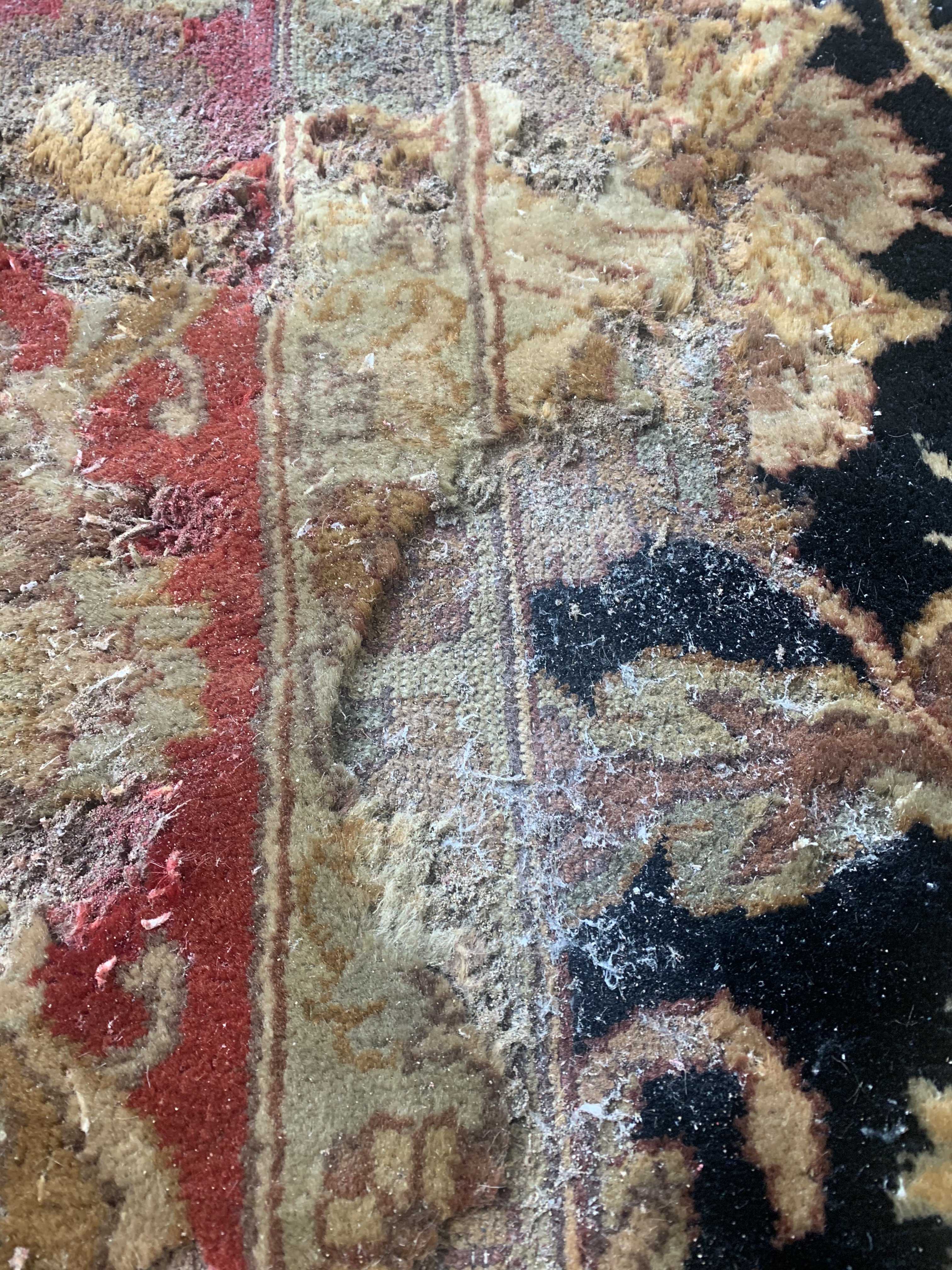

I got a 12x12 wool rug coming in. Its loaded with moth larvae or bugs that are eating it. I’m going to throw it in my big chest freezer for a week. Any suggestions on a chemical this should be treated with? Also the guy wants to knownif I can repair it. @Brian H , want to work something out and I’ll ship it to you if he wants to make it happen?

I'll get more pics loaded once I get it. Not sure if you saw the pics I loaded in my OP. I loaded them later.
