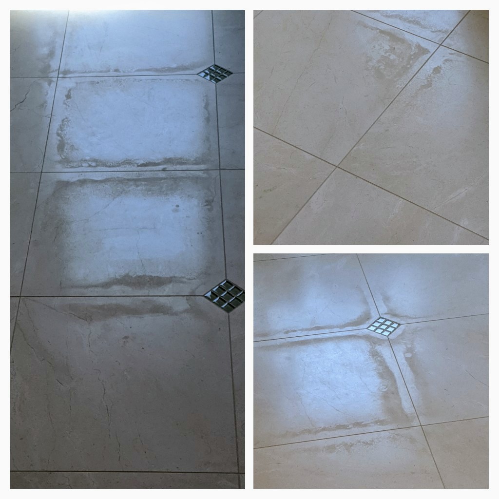

$1810 to fix her vinegar and baking soda grout cleaner for idiots tip.... 20200430_141352-COLLAGE.jpg

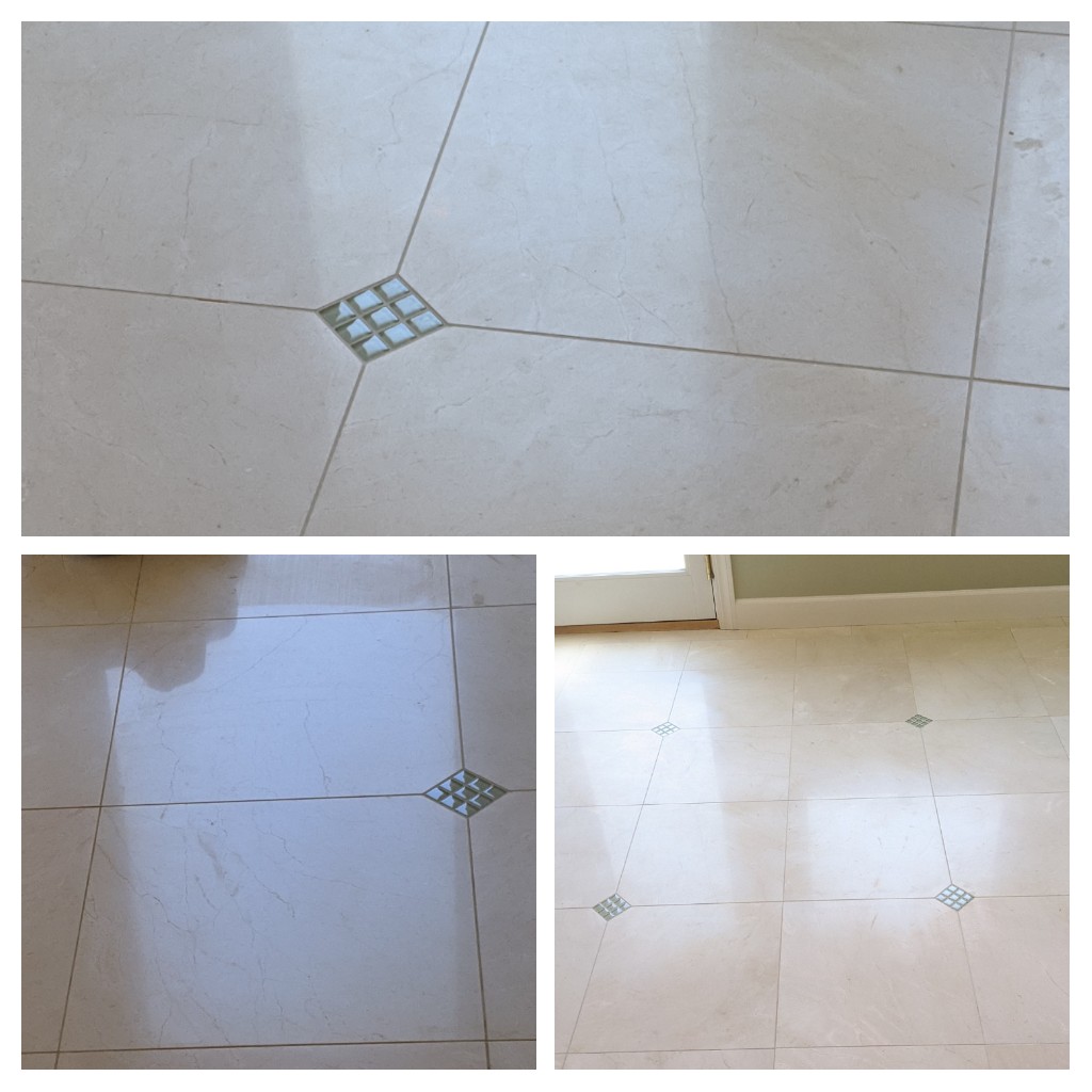

I had a guy that wanted to surprise his wife while she was on vacation and clean their travertine with vinegar 2800 sq ft. big roops. Did there floor month and a halve before. I went easy on him the second time

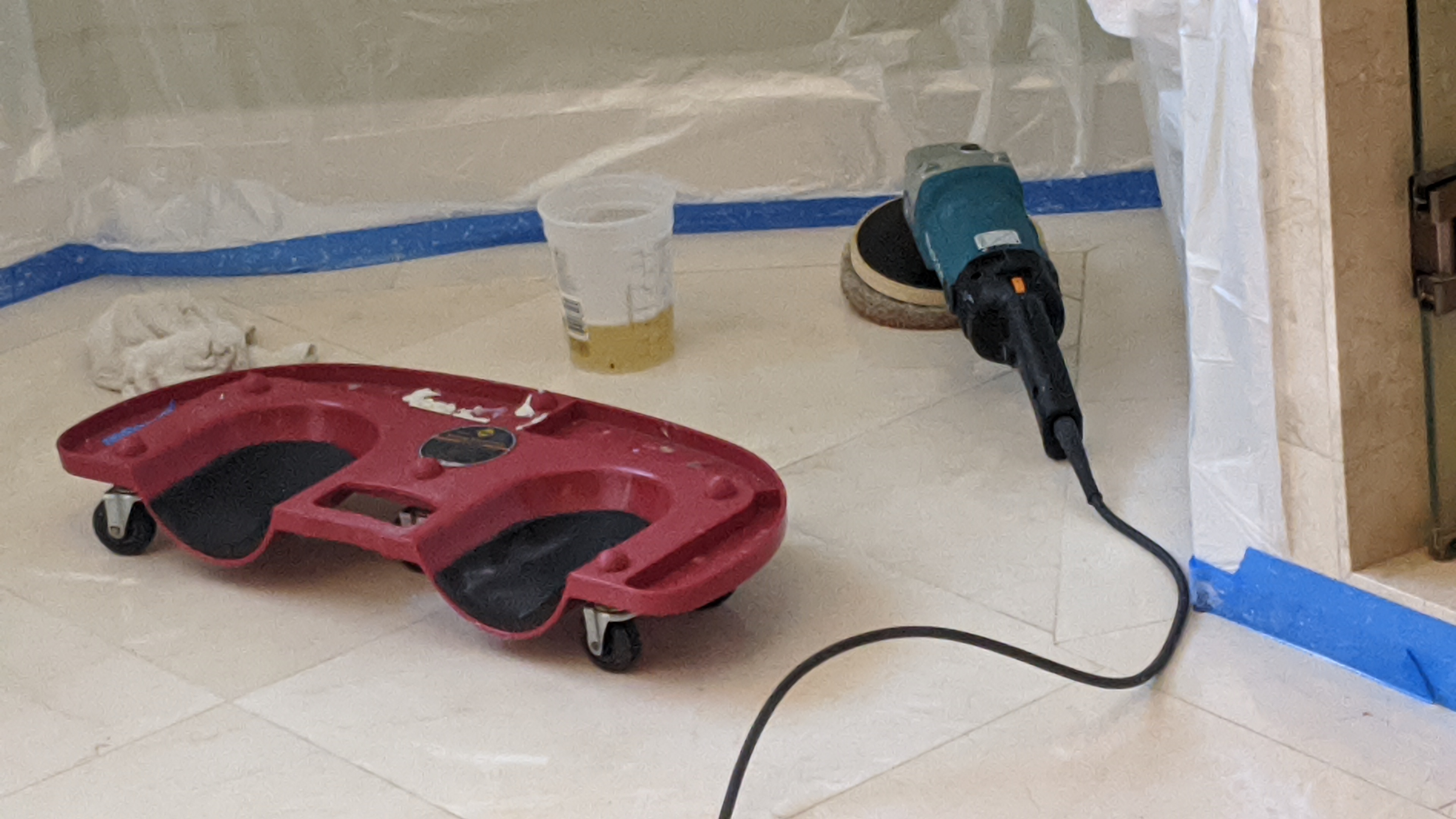

Inlays I cover with gorilla tape twice and watch carefully what I'm doing, do edges with mikata pia but havent screwed any of them yet
