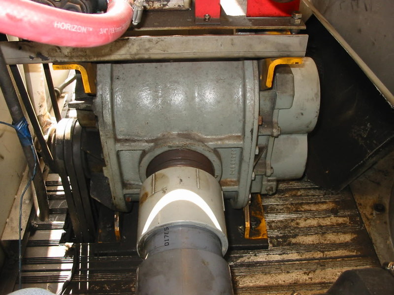

1,846
BradFenstermaker
This is my 777 59 blower foot. Excuse the venturi grease, before cleanup pic.
The blower is shimmed to match the pitch of the pto under the truck. I did have to put bearings in the 59 after this pic was taken. 3800hrs on the clock

Notice on Brads blower...all he has is angle iron holding his blower in place it is shimmed level and bolted down solid to the plate....
notice my old one....small little wings that both slots are not even being used...you can't see it in this picture but I have shims on the back side to level the belts.....
and now notice yours....probably one of the most rigid I have ever seen...nice and strong...but it starts to taper up to the right...the foot should of been shimmed instead of brought down to meet the plate....way to much torque on this...that blower is under stress.....and is causing the shaft to ride uneven......you can tell just by the way the bolt holes are not lined up from where you removed the one on the side.......be willing to bet it probably needs a shim or 2 on the other side also....
