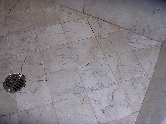

I took a look at the job today. A lot of small repairs (caulking around tubs, showers, polish, ect). The one I'm having trouble with is the shower floor (pic below). What appears to be staining is on the side where the shower head is. This part of the floor is more angled towards the drain so I'm not sure it's a drain issue with the pan. A quick cleaning didn't do jack.
I told her I couldn't guarantee whatever would be done.
What options, it's unsanded grout and looks like it would be a pita to take out.
1. Clean and color seal. How's the cs going to hold up and would I have to do the whole shower.
2. Spot repairs. Take out enough grout on those areas and re-grout.
3. Regrout the whole pan
thanks,
Albert
115,966
The High Chapperal
I would clean that with a Floor stripper and lots of 40 vol
Scrub the hell out it..
Polish it up the next with either Moneys or your diamonds.
Then dig out any moldy or soft grout and replace .
Then seal.
