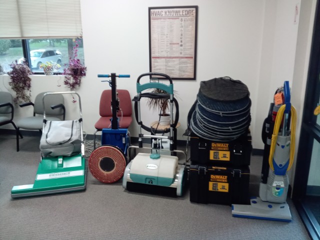

Instead of a Cimex I now have a 20'' Whittaker Trio that I use to scrub first and follow with Phoenix and bonnet. I don't do it that way on every job. Sometimes I will use a fiber pad on Phoenix instead of Trio.
Trio is definitely VERY LOW MOISTURE cleaning. It puts down a fine mist in front of 3 brushes with 75 pounds sitting on top of the 3 brushes. 15-30 minute dry times. It's a excellent scrubber

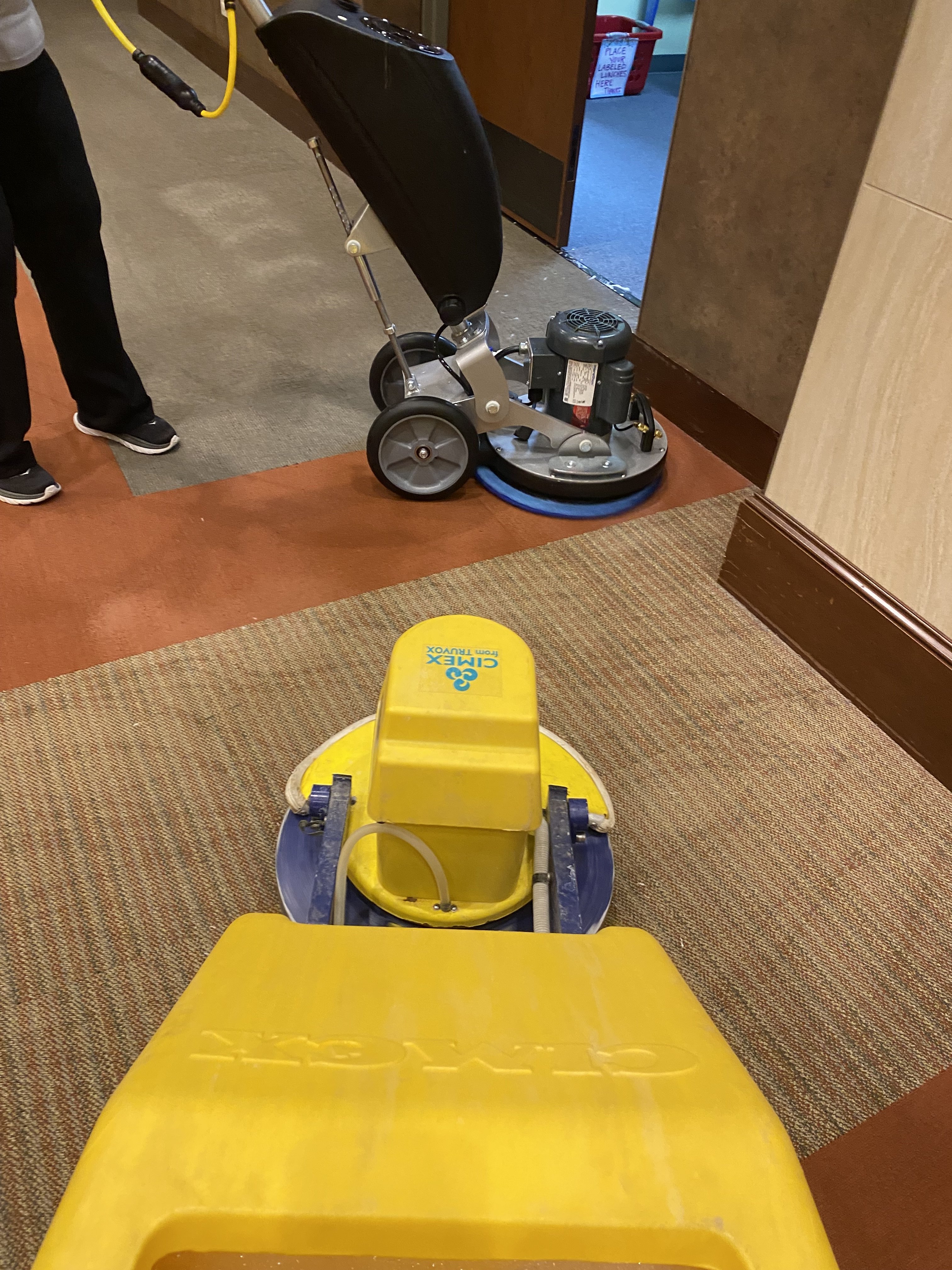

Churches are notorious for coffee as you know I’m sure. I use various methods to get the results needed. I use Brush Pros with renovators a lot to prescrub. A lot of times I’ll
start with spraying the coffee spots and use a 15” crb. Sometimes, we don’t have to use the Vibe. I use porty’s or truckmount. Whatever I feel like and is convenient.

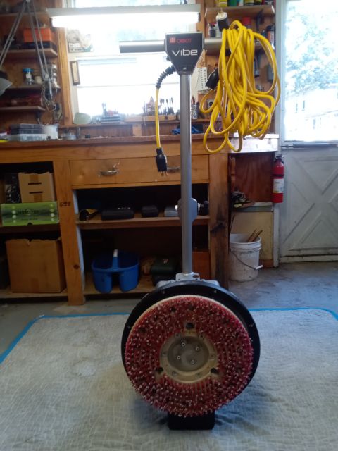

And I have a Tankless Vibe that I use on big residential so I know Orbot makes a nice OP
I bought that malish driver in 2015 for the SparyBorg. It makes SprayBorg/Vibe much more aggressive and digs deeper on residential carpet. Hated the velcro driver

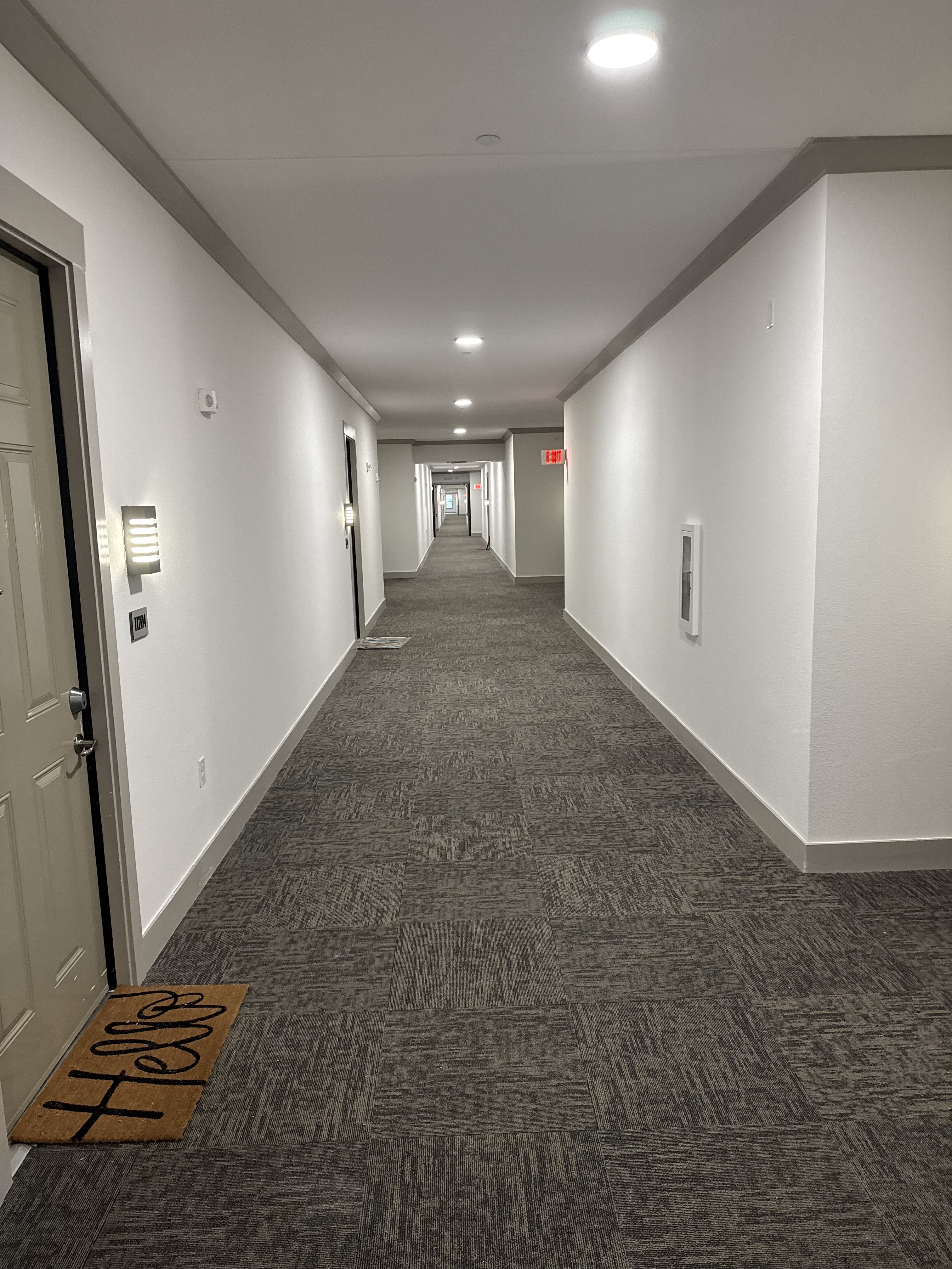

If it's all in that condition...
You can buy these from me or Rick but Direct Mop Sales is the imposter..
500 sf per side on that floor.
19"
If there are worse areas you'll want to pre scrub it when a brown 3M Fiber Pad, use the microfiber than follow up with a Glad Pad, which is a cotton blend that absorbs that gunk that the MF won't...
