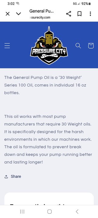

my manual says I can use 15w40 and it has over 500hrs with that in it now. That's why I'm asking. General pump says that across the board on this Emperor pump
the list chart of compatible oils is equal to 15w40 in the manual which is equal to General pump series 100
I'm looking in the site glass and that oil still looks new.

Thats good that the oil still looks new, it should. General pump series 100 oil is 30w ( im almost positive non detergent) so if you were to substitute a automobile or different oil it would be 30w non detergent. Or air compressor oil (also 30w non detergent)

The proper pump oil is expensive stuff. General Pump 100 series oil is $13 for 16oz on scamazon.
So thats 13 bucks a year or so or around 1.08 per month or around 3½ cents per day. thats expensive? What's your machine worth? Is it worth spending an extra 2cents per day to keep it in good shape? Mine is.

nah, just go buy some sae30 or 15w40 if its a general pump
