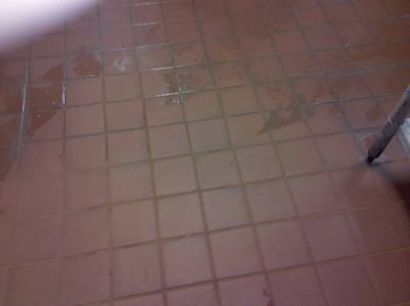

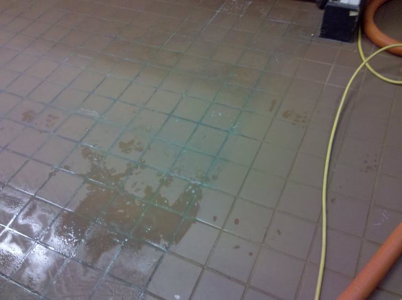

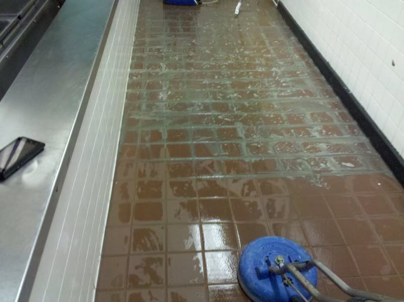

Be prepared to scrub grease.
That's one we did, there was an 1/8" of grease on all the lines. Add more cost to spend time scrubbing. And possibly having to go over it twice......
