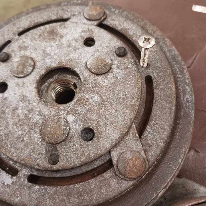

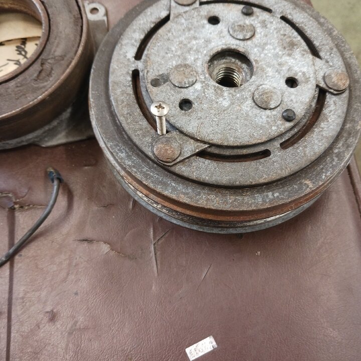

Im sorry, the clutch i drilled out and tapped is an old style obsolete clutch and has alot of space to bolt looks like the only way to do it on a modern style clutch is to remove the magnet and drill and tap inside the 6 grooves and use 8/32 machine screws. I did this 15 years or so ago memory's not what it used to be but with the magnet removed it shouldn't be necessary to tap just run a machine screw thru and put a nylon lock nut on the other end itll spin in the place once occupied with magnet
20250917_124220.jpg 20250917_124145.jpg 17581385944453484873898690930629.jpg
Reactions: Bryce C

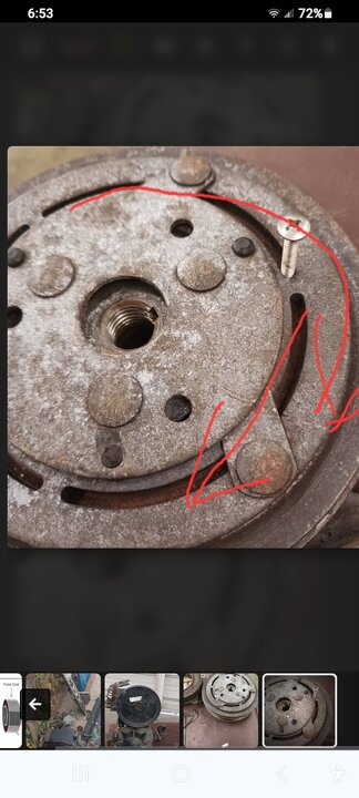

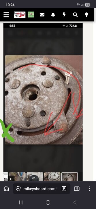

Just make sure that if you use machine screws that you place um where the armature butts up against them rotating see picture and if 1 bolt works 2 will work better

Clockwise according to your arrow. I suppose if the armature starts spinning freely and the pulley is spinning clockwise that makes sense. Would the armature possibly drift away from where it butts against the pulley when she comes close to a dead stop, and then nail it real hard upon starting up again? What if we stick one over there too to sort of pinch it both ways?
I was going to post a picture but I still can't post a picture! Argggh!!!

You just want the bolt to hold the armature so it cannot slip or move in the picture the bolt is in the proper place for clockwise rotation. If counterclockwise it would be placed on the other side of the metal partition (for lack of better word)

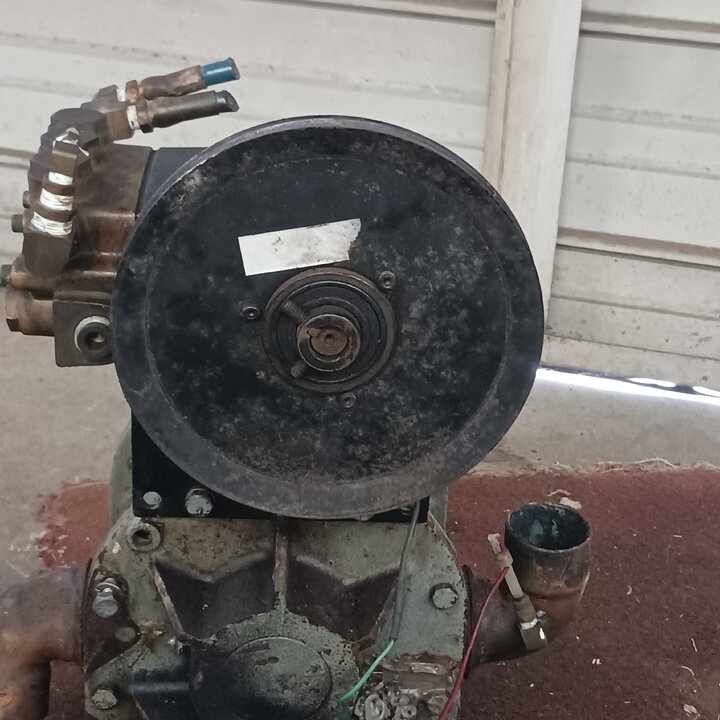

I fixed my pump today. Removed the magnet, drilled a few holes, and put a couple small bolts with lock nuts in to lock the armature in place 👌

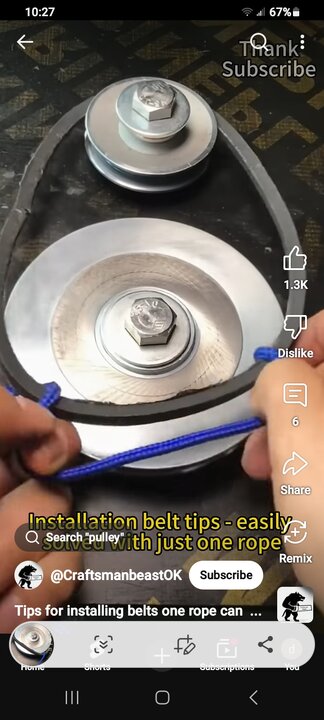

I'm having a hell of a time lining up my pressure pump belt, there isn't enough play to slide the mounting plate to make the 2 pulleys line up, so the vbelt is quirked 👎 Sounds fine but I bet it will chew through it prematurely, maybe even fry the bearing in my pulley eventually? I think I need to adjust the jackshaft and then realign my pressure pump pulley. I'm not sure how perfect they need to be but they are shamefully out of alignment.

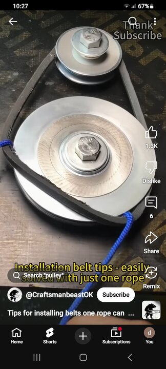

I would have to see what your talking about. I can't believe that there isn't a simple way to adjust your belts. Im glad i only nee a crescent wrench to hold the cam and a 3/4 box end (or second crescent) to tighten the bolt.if it wasn't for my tachometer sensor i could change my blower andpump belts in less than 10 minutes (including removing the cowling) with the tach sensor its takes 15 or 20 minutes now love cam adjusters! . Can you walk the belt on with an wire or piece of cord?
Screenshot_20250927_200403_Gallery.jpg Screenshot_20250927_200457_Gallery.jpg Screenshot_20250927_200430_Gallery.jpg Screenshot_20250927_222751_YouTube.jpg Screenshot_20250927_222748_YouTube.jpg

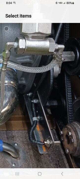

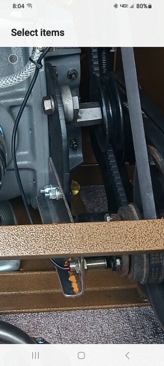

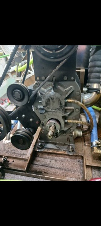

I'll take some pics and share them with you shortly. I think the problem is that I messed up my jackshaft alignment when I changed the blower belt a few months ago. It is positioned in such a way where the pressure pump, even within it's range of play, cannot line up flush with it...

Getting the belt on and off isn't an issue. Aligning the pump and jackshaft pulleys is. This is as close as it can get in its range of movement. It is way off. The only way to adjust the pump is loosening the 4 bolts underneath it on its mounting plate, which allows it to slide forward and back and wiggle a little to the left and the right. Looking at the jackshaft it seems only the read near the blower is adjustable, and it is one range of movement: up and down.
