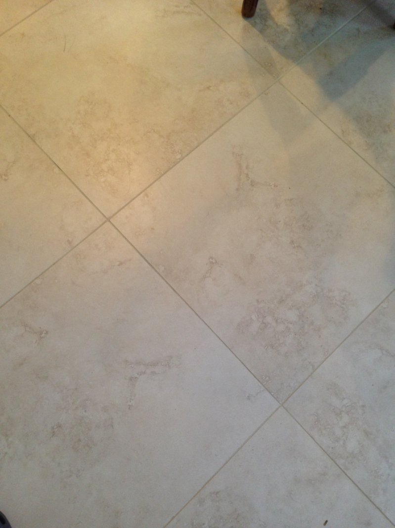

I cleaned this tile awhile back. It was a brand new install which they spilled syrup on. They spent a few weeks and just couldn't remove it all. It was a nightmare for me to clean. What gives❓I'd swear its porous. Today I cleaned his carpet and was very careful to not drop anything on it.
Every drop seemed to leave a stain. I will in the future have to clean it again. Is there a different product I should use to clean it. A different process.

probably couldn't hurt. he has extras. i could test one for fun. still, porcelain shouldn't be porous.

The cheap China porcelain is "unglazed" to give it a "matte natural stone" look.
The unglazed porcelain is "semi porous" meaning the lack of a glaze on top leaves microscopic porous uncovered so anything spilled on it actually absorbs / penetrates the top layer.
I would try a heavy alkaline cleaning first at 1200 psi at 180 -200 degrees and if that doesn't work try an acid cleaning followed by neutralizing rinse.....dry and seal with a penetrating sealer.
I have had to do this many times with "unglazed" porcelain tile.
Hope this helps

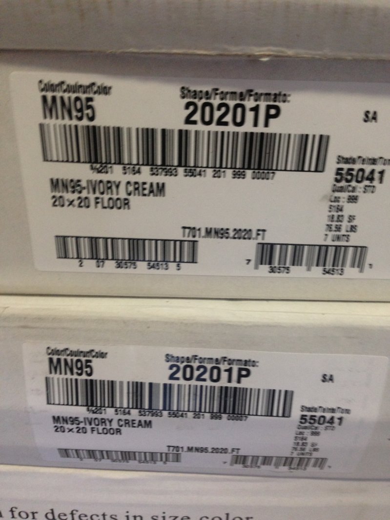

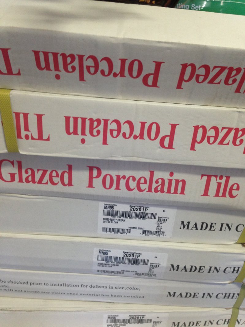

Says glazed right on the box, but also made in China so who knows.
