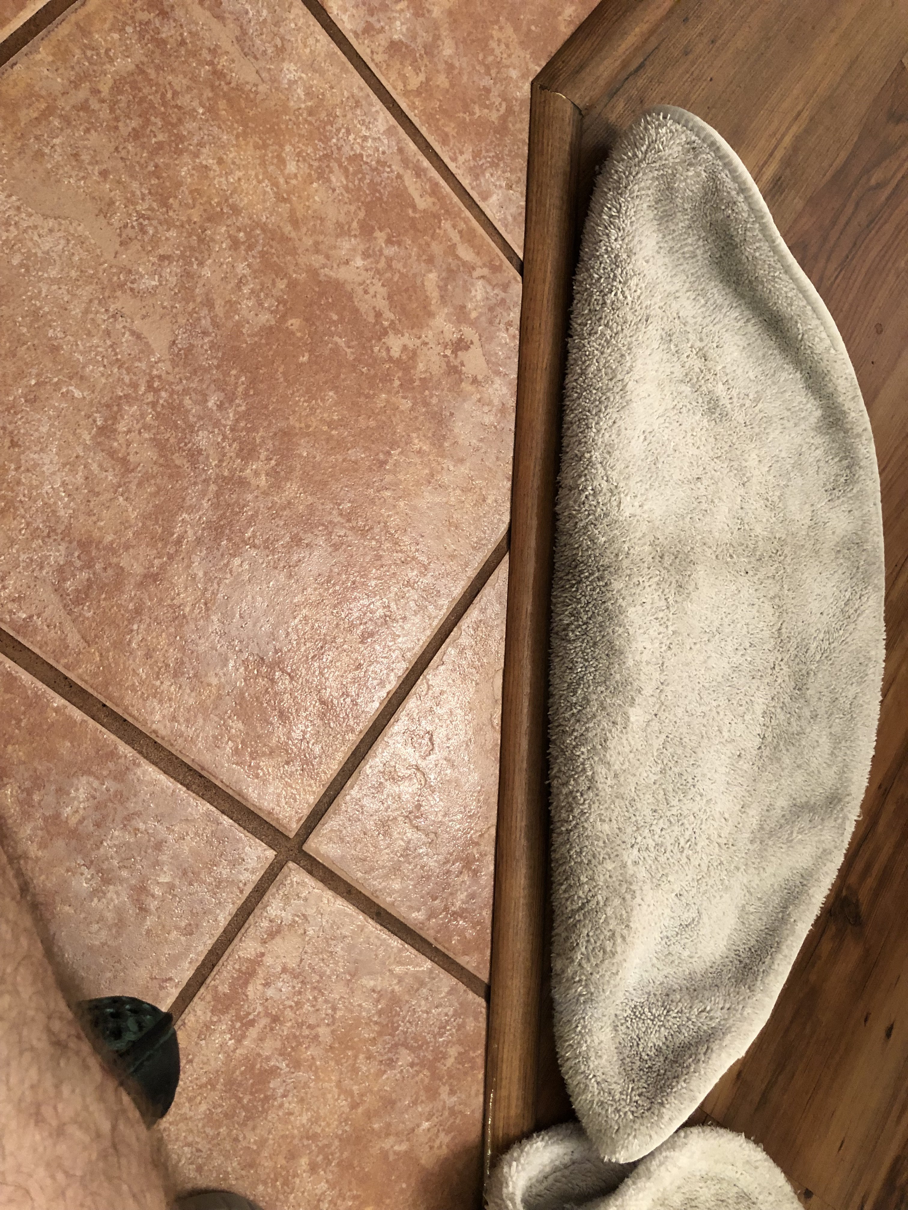

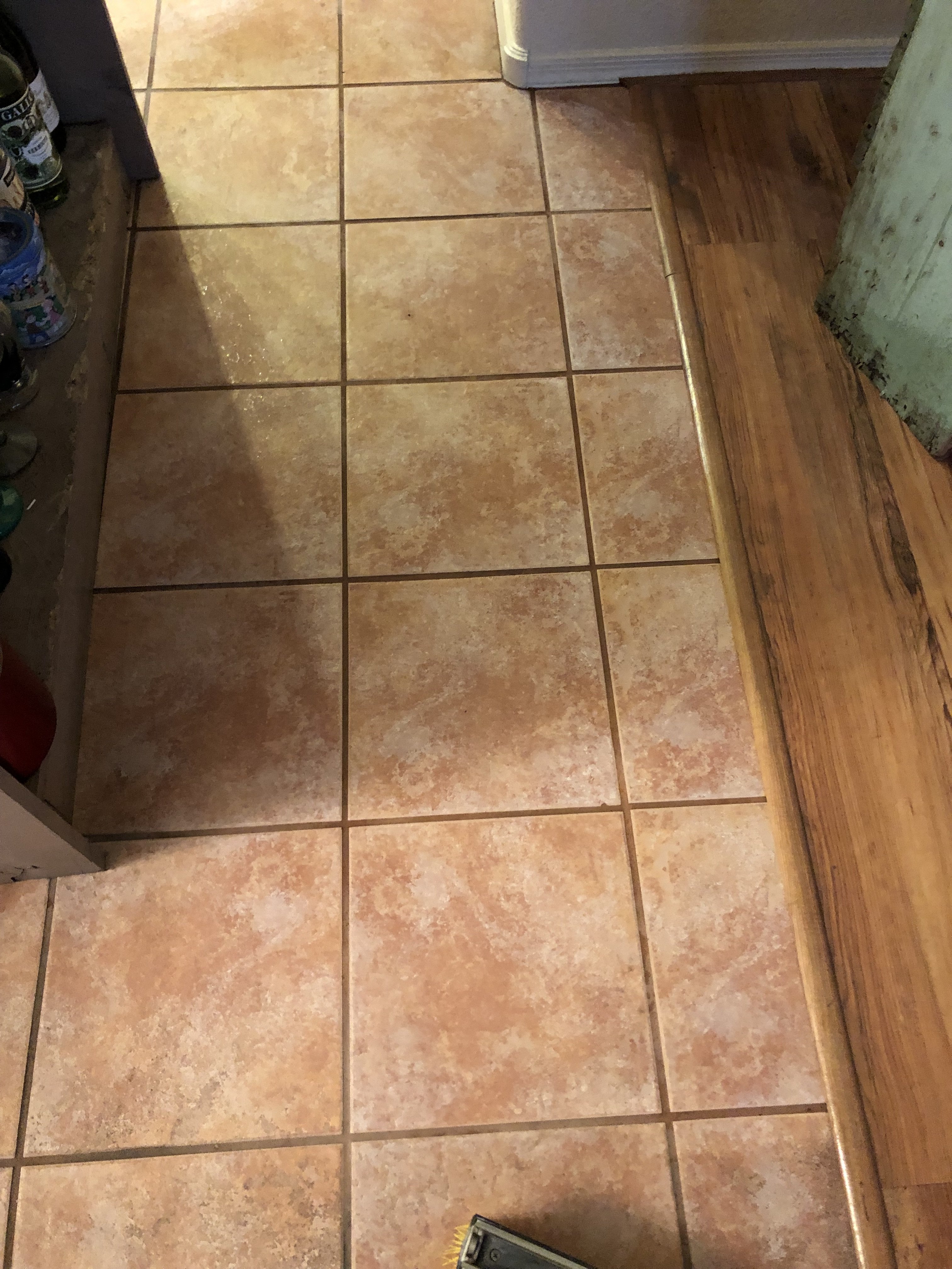

In the attached photo's is a job I did with the Trinity and an Oreck Orbiter because that laminated wood ran alongside the tile in every room.
They thought it looked good that way, go figure. I will not run a lot of water in that situation.
