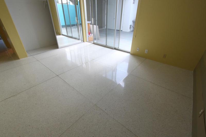

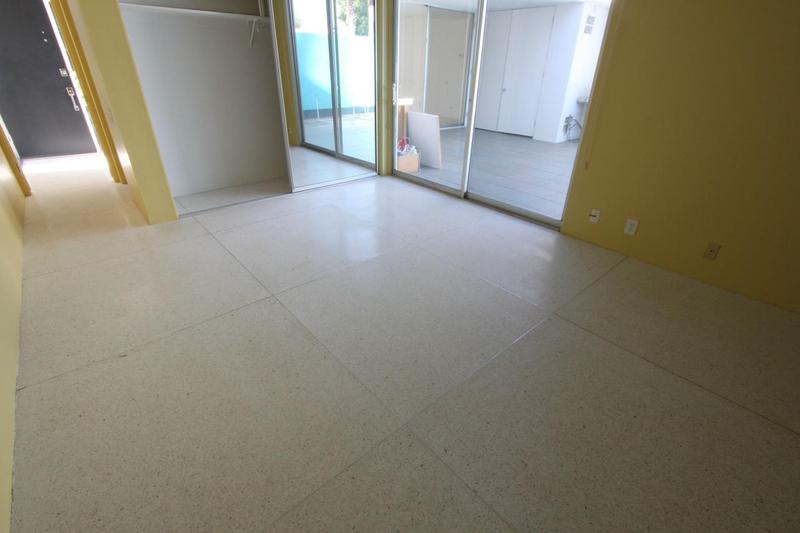

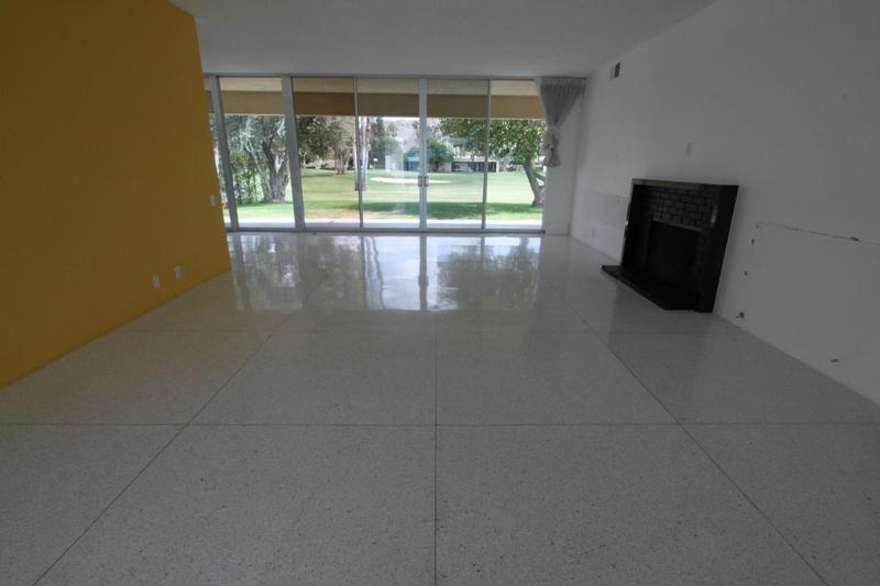

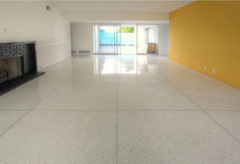

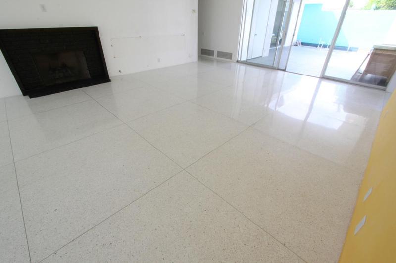

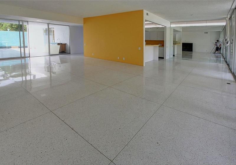

Finally hooked one of these people in these old PS condos. Now that we did this, we're getting ready for her neighbors house, but his is 3 times more work.

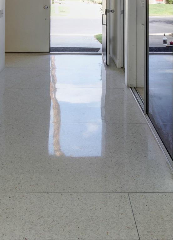

Between each expansion joint, there are stainless strips. The ground is so jacked up here that each square in between the strips curls up at the edges, so I needed to use the Cimex with the floating heads. Diamonds from 220 electroplated in some areas, up to 1800, then polished with MB-22. The crack was filled with marble chips and liquid epoxy, custom mixed on site.

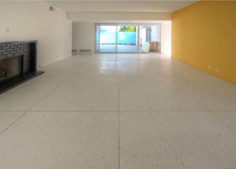

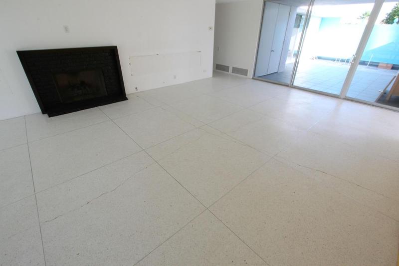

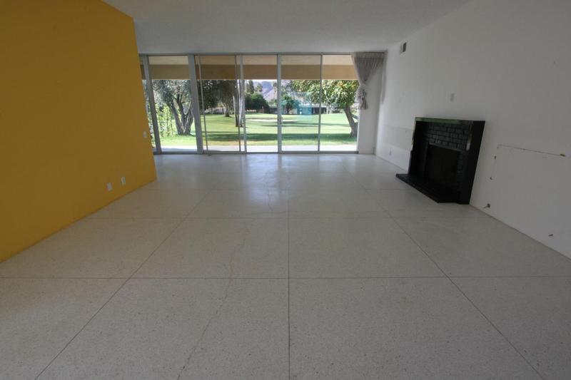

Huge crack running the length of the room, both ways

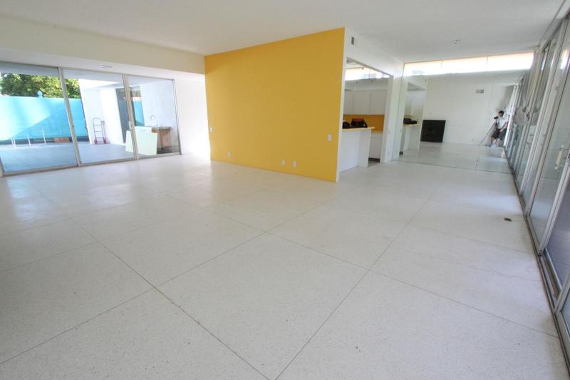

No more crack
This crack was wider than it looks

Looks nice! If the slab is settling, is it likely the crack(s) will reappear in the future?
Feb 5, 2013
527
cameron demille
It's possible, floor are always moving out here. We're on the San Andreas fault line, cracks are inevitable. This is probably 50-60 years old. It might shift a little, but I think the settling is done.
