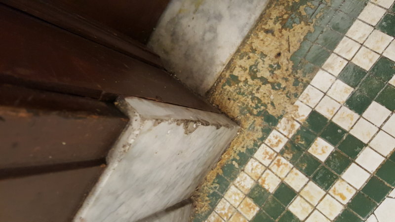

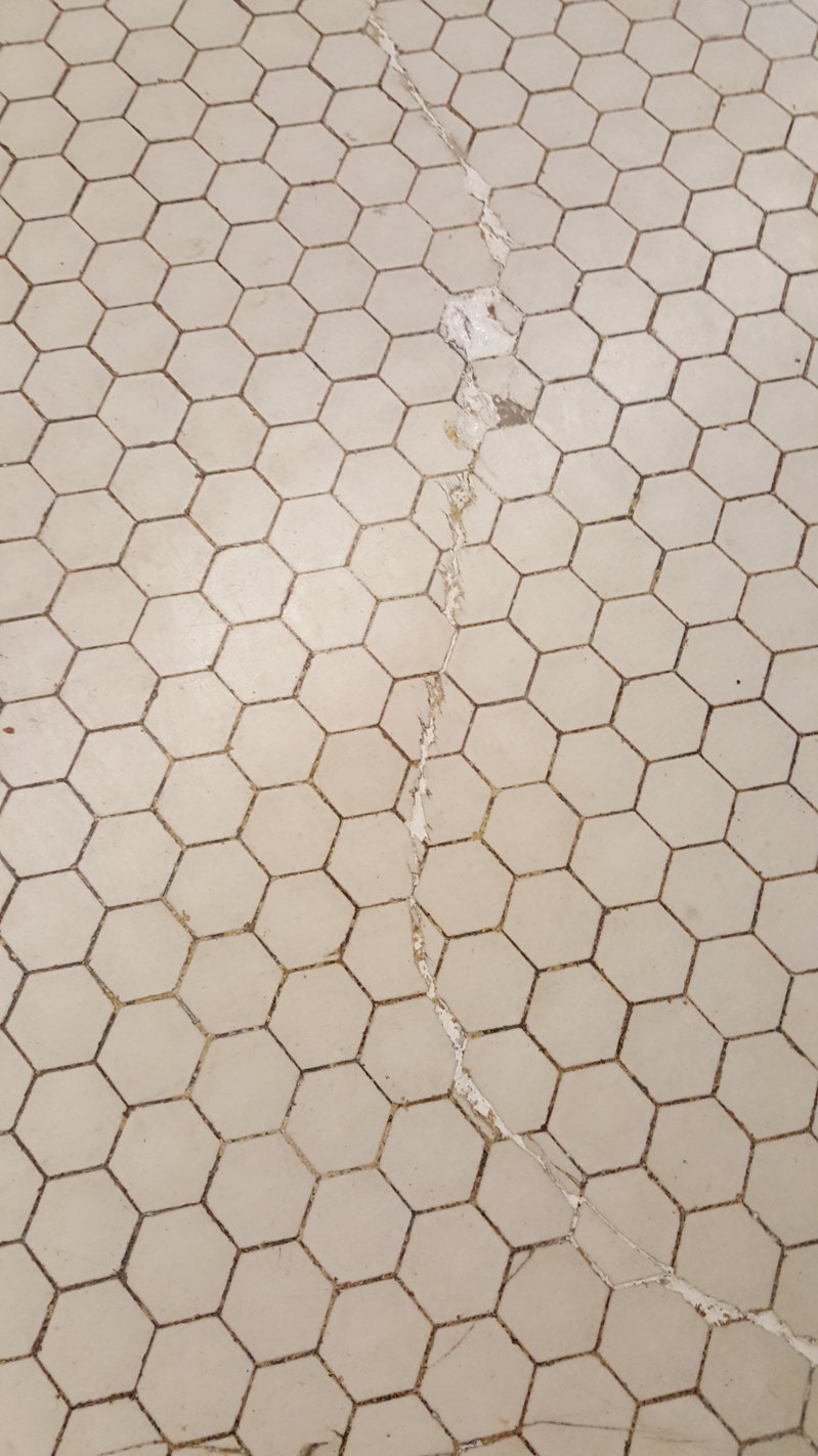

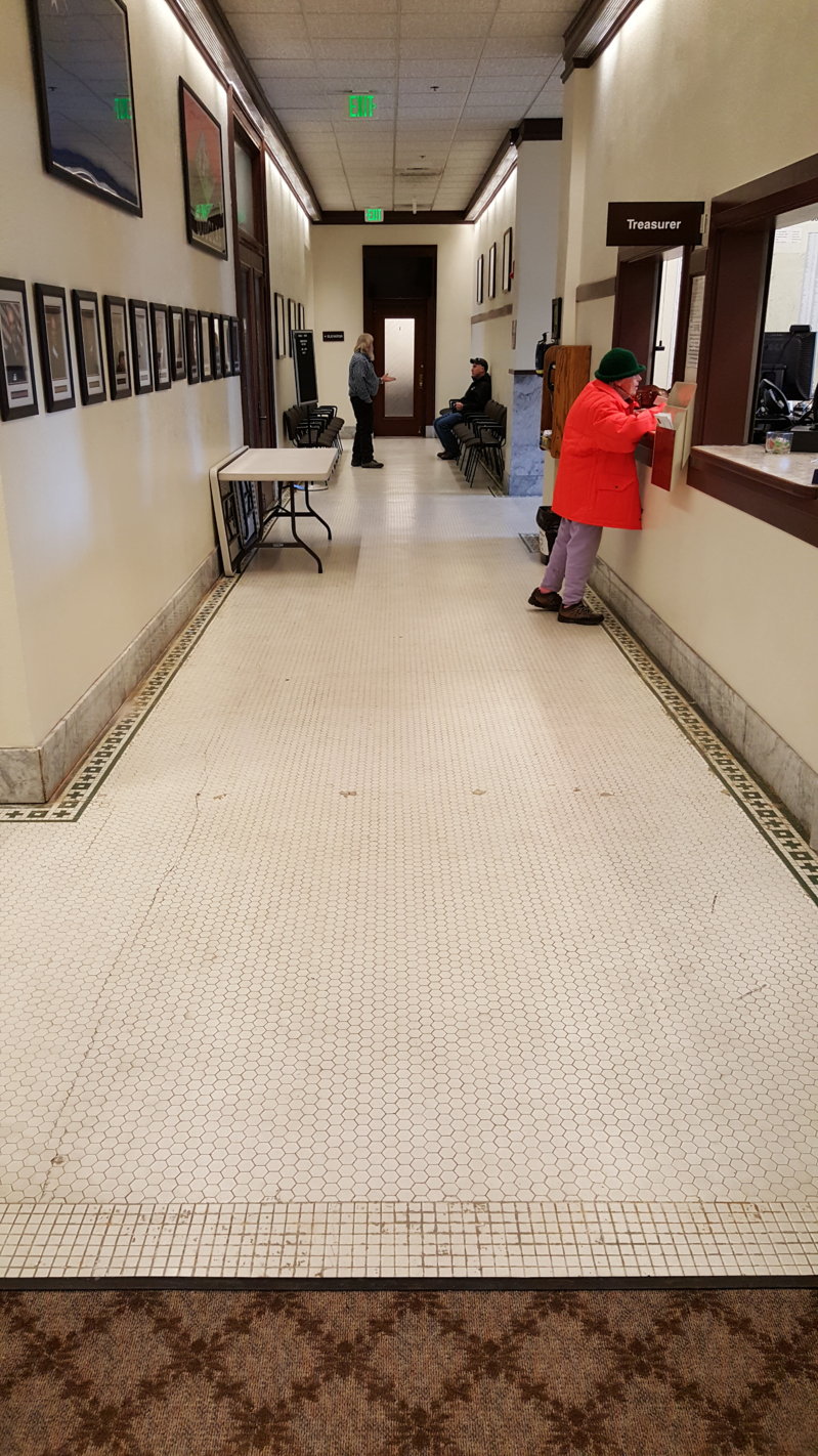

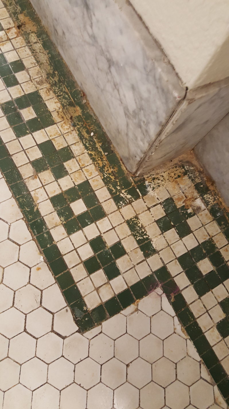

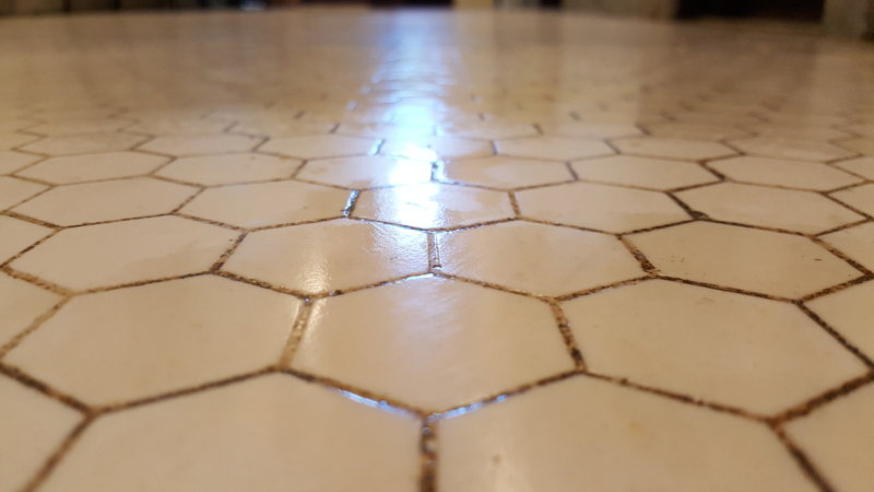

They were not too happy with the current floor guys so they called me out to inspect this 100 year old floor at the courthouse that was covered with carpet for years..
The other floor guys left this mess behind..
I did a stripping test and what ever is on there comes off real easy.
I'll put some grey silicone under the baseboards and leave it all unsealed as it has epoxy grout..
So..
If I use my two ply Devpro filter and a pantyhose on the inlet filter could I use the 370 to rinse?

That's a lot of filtration, and you'd probably be fine. But look at the downside if you get that "stuff" in your blower...Just get a wet vac and don't use your 20K machine to do that kind of thing Mike. Next to freeze damage and running out of oil, emulsified floor finish is the number three cause of massive equipment damage among my truck mount customers.

If you use stripper, that glue will hop off. Scrub with a crb, then recover with a wet n dry or a porty, or even microfiber mop. You'll have no problems and won't risk the TM.

That is plenty big enough, if you use a squeegee nozzle (Sears). Rinse and slurp. Repeat. Done.

Yes use a floor machine and a wet vac like Jim stated and get the bulk of the crud and slop up with the wet vac,
Then lay stripper again use. Brush on the 175 and go to town on it one mo time and rinse high pressure high heat dry and see what's left on it.
It will be a world of difference and they will be impressed.

12 hours, 2 gallons of stripper
who knows how many razor blades
two 3M black pads
two waste tank dumps
a haystack of rags
and my fingers are still tingling
and I got another must have tile job tomorrow...

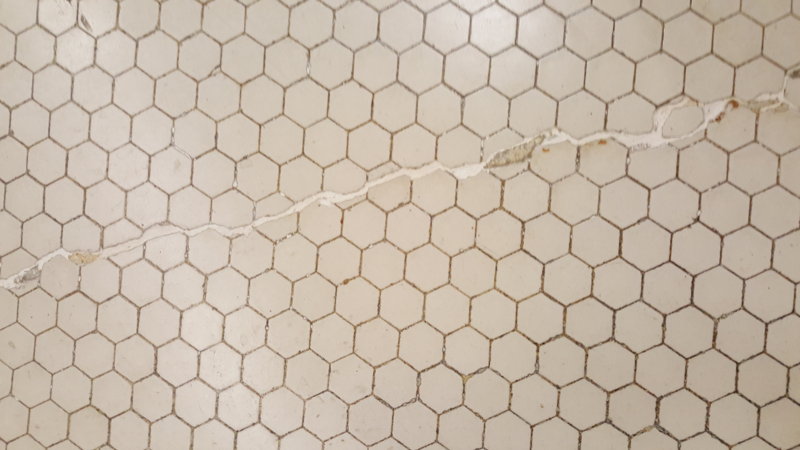

Well done, Mike!
Did you do any of the repairs or will someone else be doing those?
