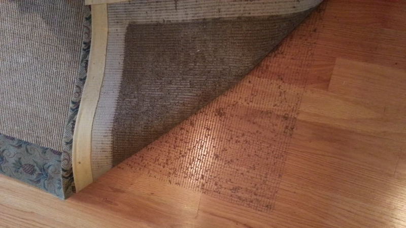

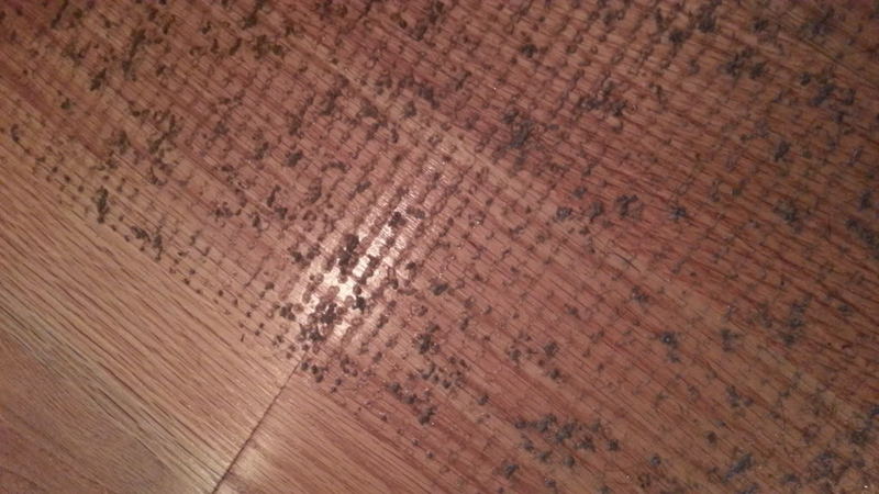

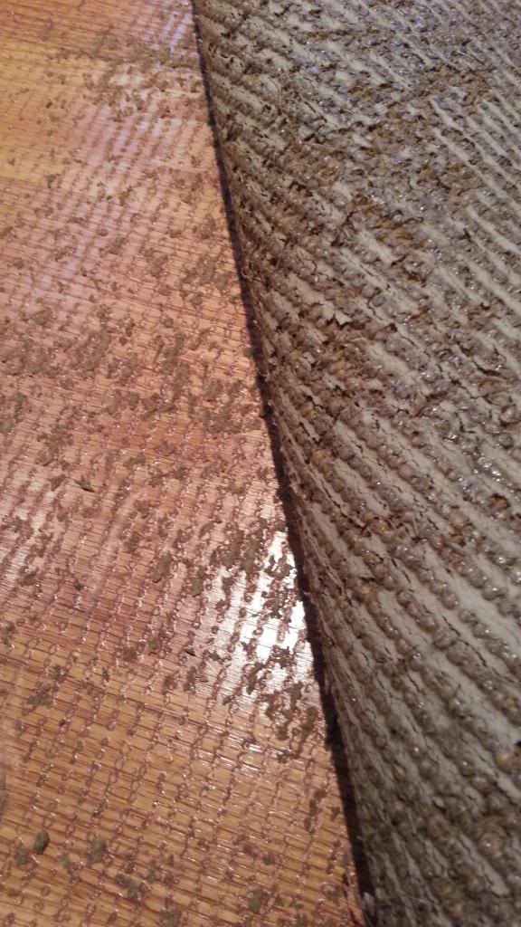

one hell of a residue on this Wood Floor....looking for advice.
117,285

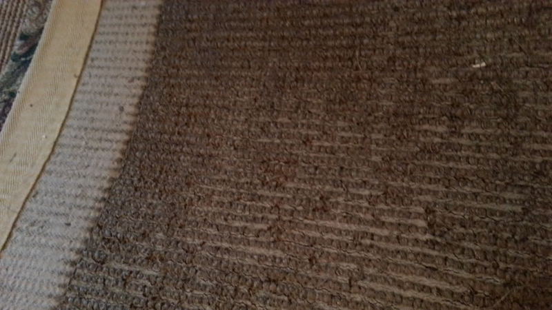

the rug..
the non slip built in/on backing..
the proceeding mess...
I'm thinking a de'limo based solvent/prespray, a 175 and old red pad and a hard floor wand rinsing..
I'm sure there will be plenty of evidence left behind in the form of discolorationand pattern of the rubber but at this point they just want the goo gone...

maybe a plastic/nylon scrapper tool to squeegee off the gooey chunks first

Razor blade scraper then a red pad with spray buff cleaner.

I don't care who does it or what you ****ing use it won't come out of the wood, I have see this on stone Saltillo wood and even ceramic . It won't come off.
117,285
the sticky residue will come off the chicken pox/ostrich skin type pattern will not, and THEY KNOW THAT
