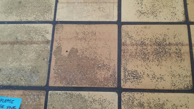

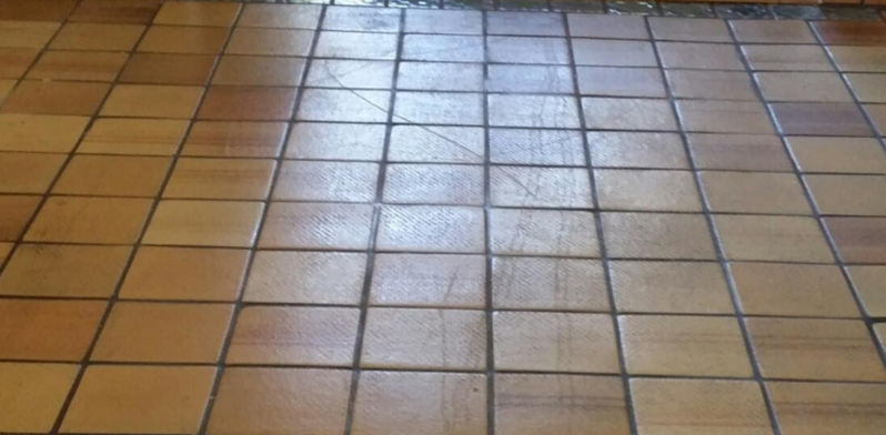

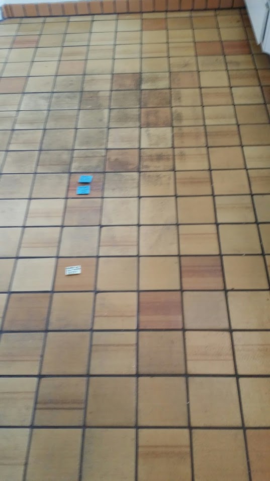

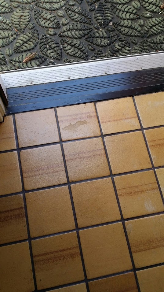

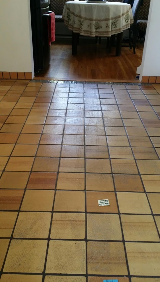

OK Tile experts what is going on here?
117,273
and how would you proceed?

Looks like surface damaged super saltillo to me, the plant in Jackson is now closed BTW
14,632
I would be filing an insurance claim after my dumb ass tried to use floor stripper to remove the wax. I didn't know it was a tile that was saltillo.
So I'm watching this thread to see what the right way to do it is. Thanks Mikey

By any chance is that a dye job?
I can't tell if the glaze has broken down or the color is coming off.
So what are you doing with it?

No. He had applied some sort of sealant over soiling, whenever. Well, somebody had. I know because he gave the elves a partially-used gallon!
We used stripper and superheated steam, as well as a CRB. Eventually it all evened out and looked dandy.

You real;y need to test, for results
Some pain sometimes not
Do you see the dimples created from the no-move rug pad?
That there tells us that this project is a two day event.
