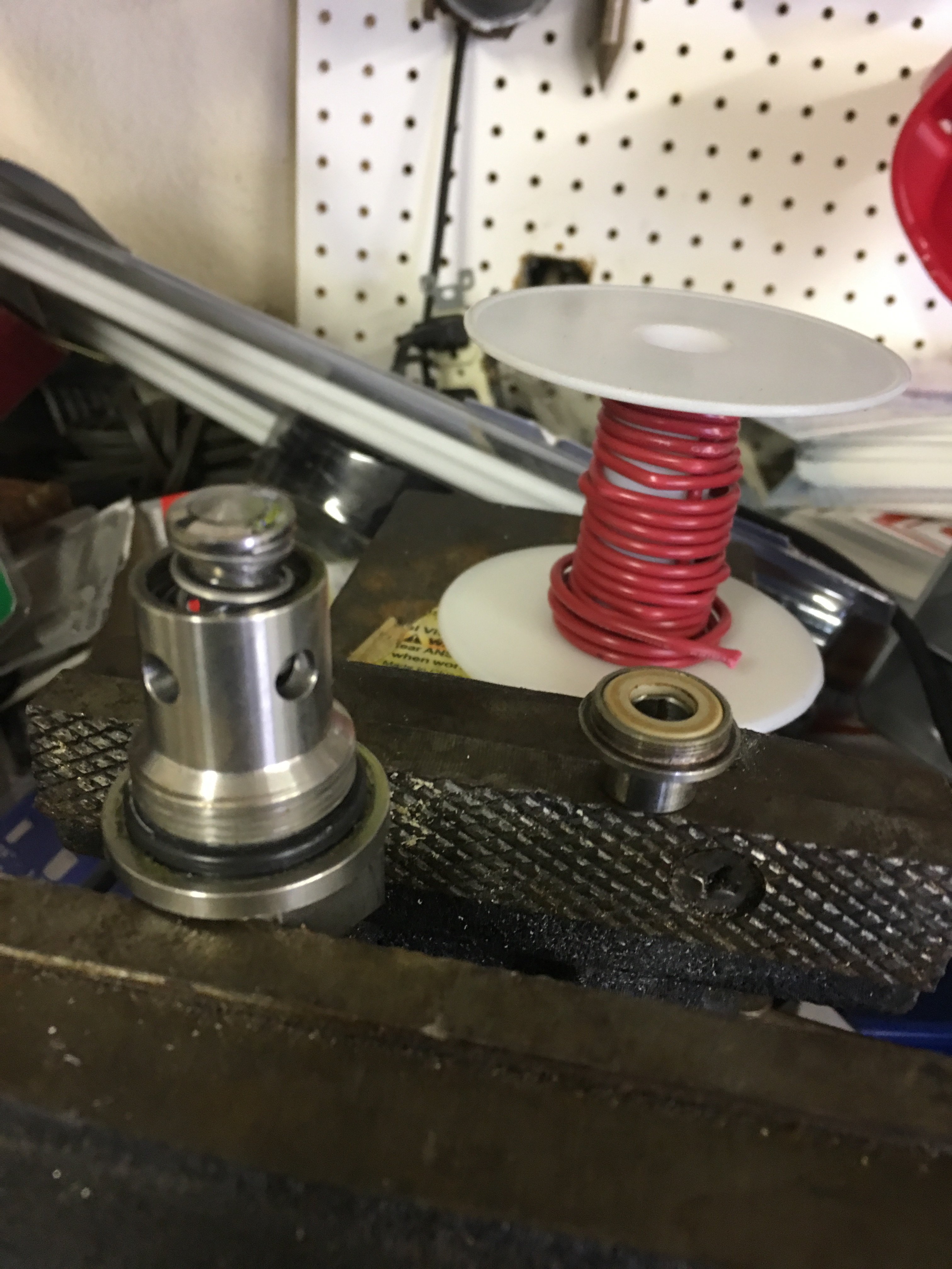

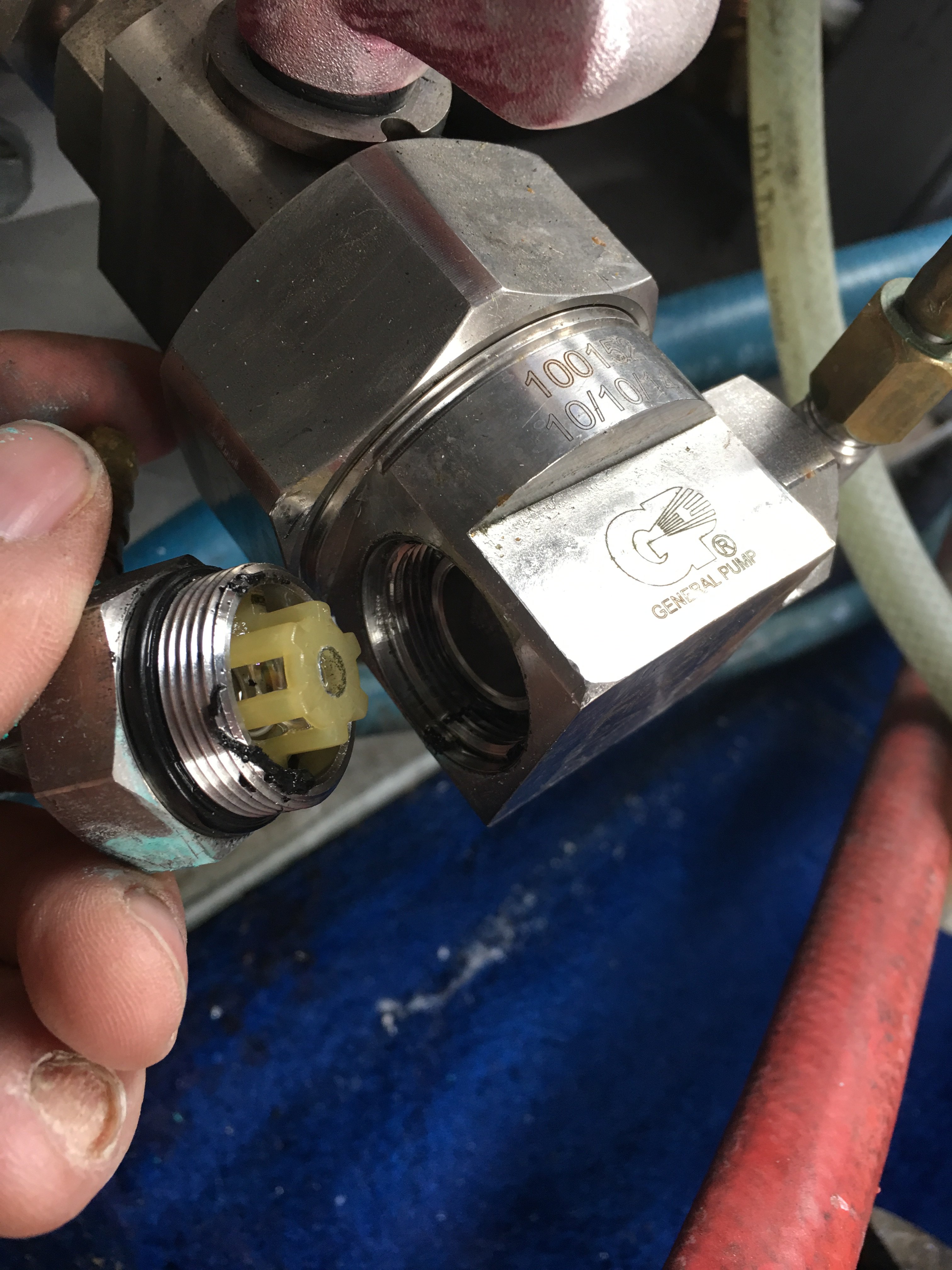

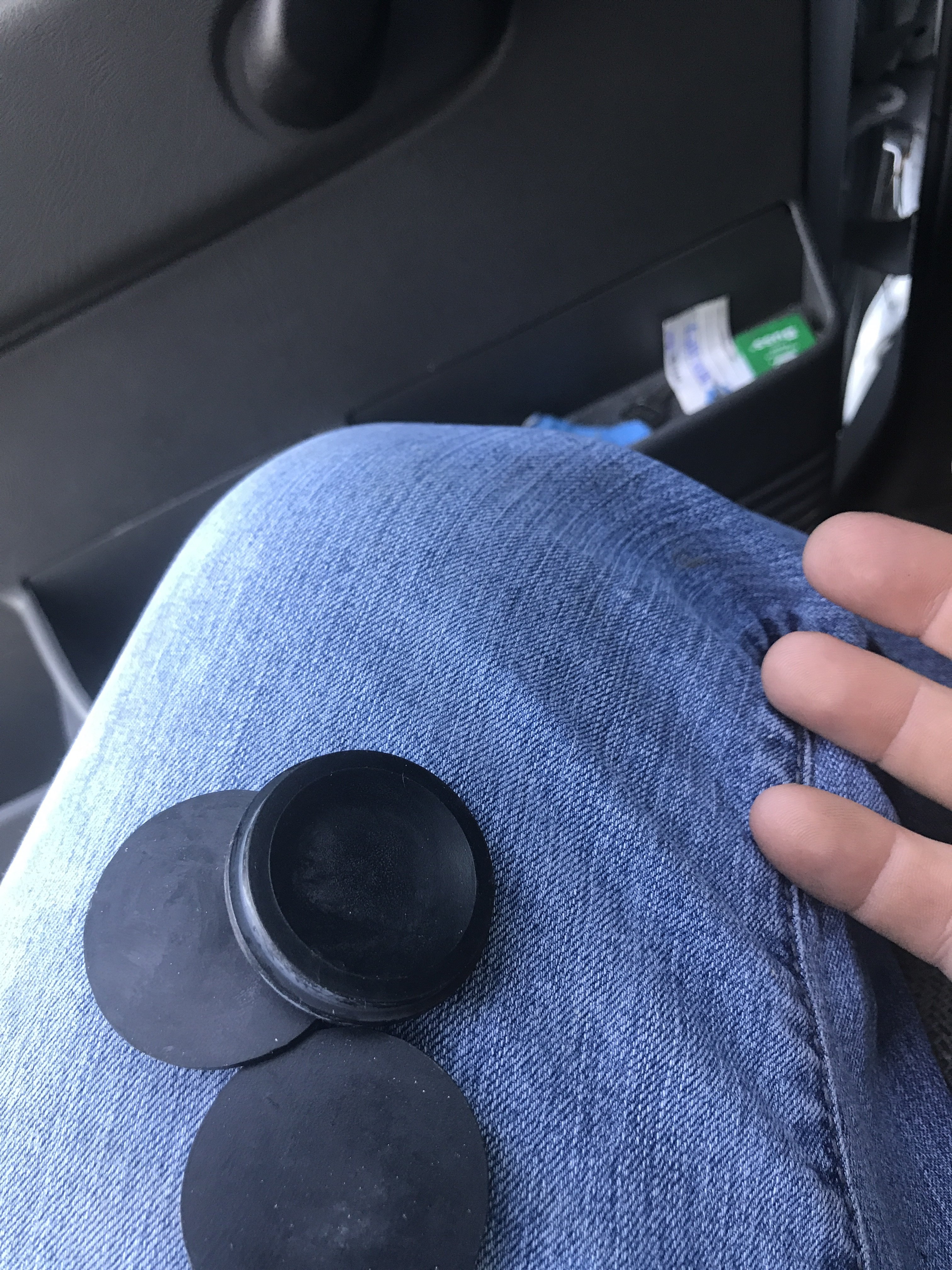

Would this be beyond use? I probably made it worse by taking it out to check it.
Reactions: SamIam
You guys and Meg aren't going to believe this. I flipped that disk around, put back in the chewed up diaphragm, and it snapped back to life. Ok, back in business. I don't know how much longer I have with that diaphragm but I have new ones on the way. Thanks for the video Mark.
You are definitely living on the proverbial "borrowed time."

Dear Lord..dont touch the APO..that thing should last year's trouble free...just flush it out with clean eater now and then...your o-rings and diaphragm on the chem pump are being desolved by your rinse chemical...over time it starts to deteriorate them...between that and the high PSI when cleaning tile..1000 to 1500 hours is about what they are good for......the only thing that goes wrong with APO's is when they are left sitting to long and not flushed out...or if there is no in line filter and crap gets up in the check vavles...other than that they are pretty bullet proff....

Yeah I leave the pump on but the chem switch to off with tile. I never need to go over 900-1000 on tile. I don’t like blasting grout. The heat and chems seem to work for me. But maybe I’ll start turning the pulse pump off just to save wear and tear. But I can’t complain. I got almost 1400 hours out of it.
