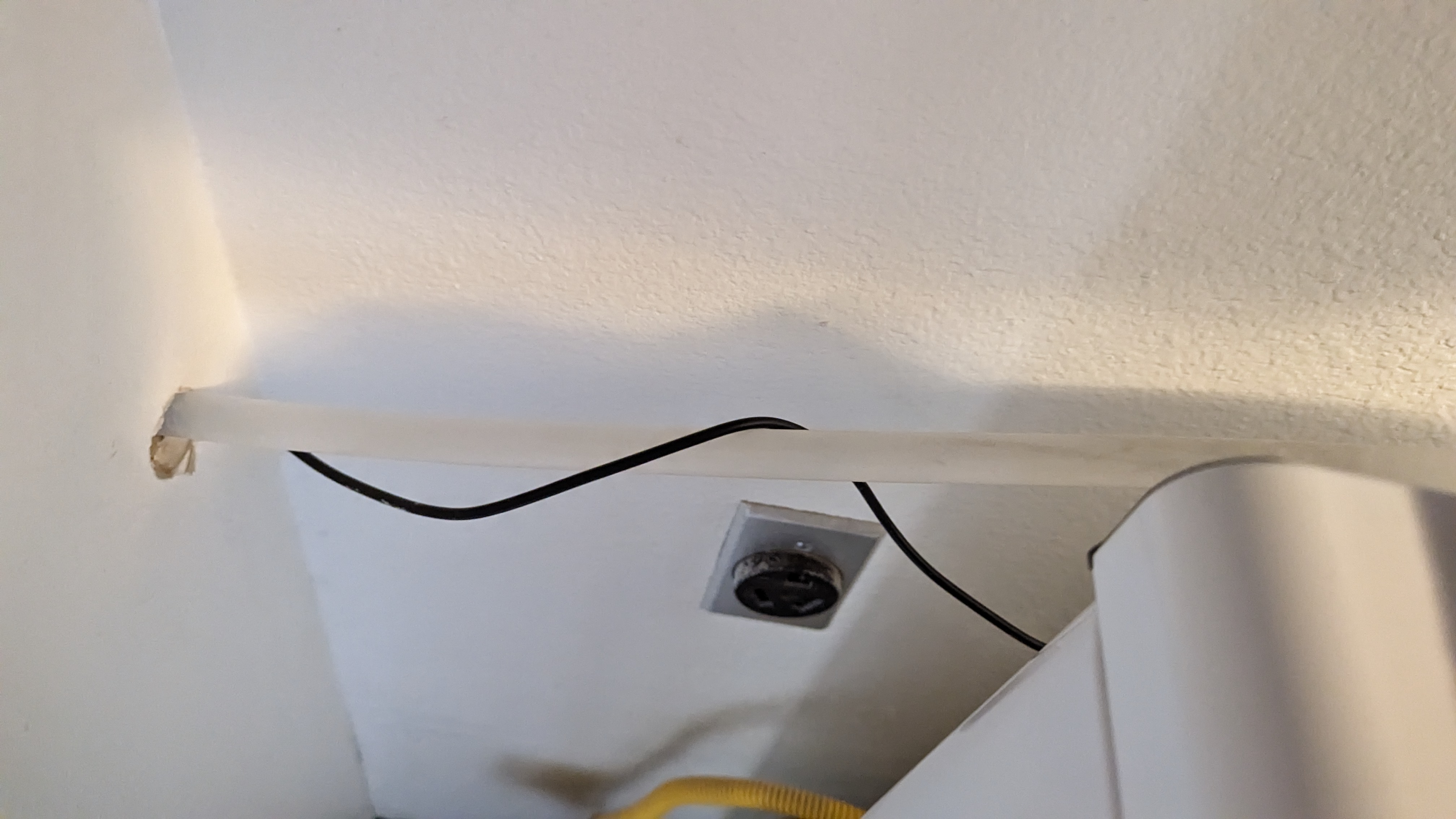

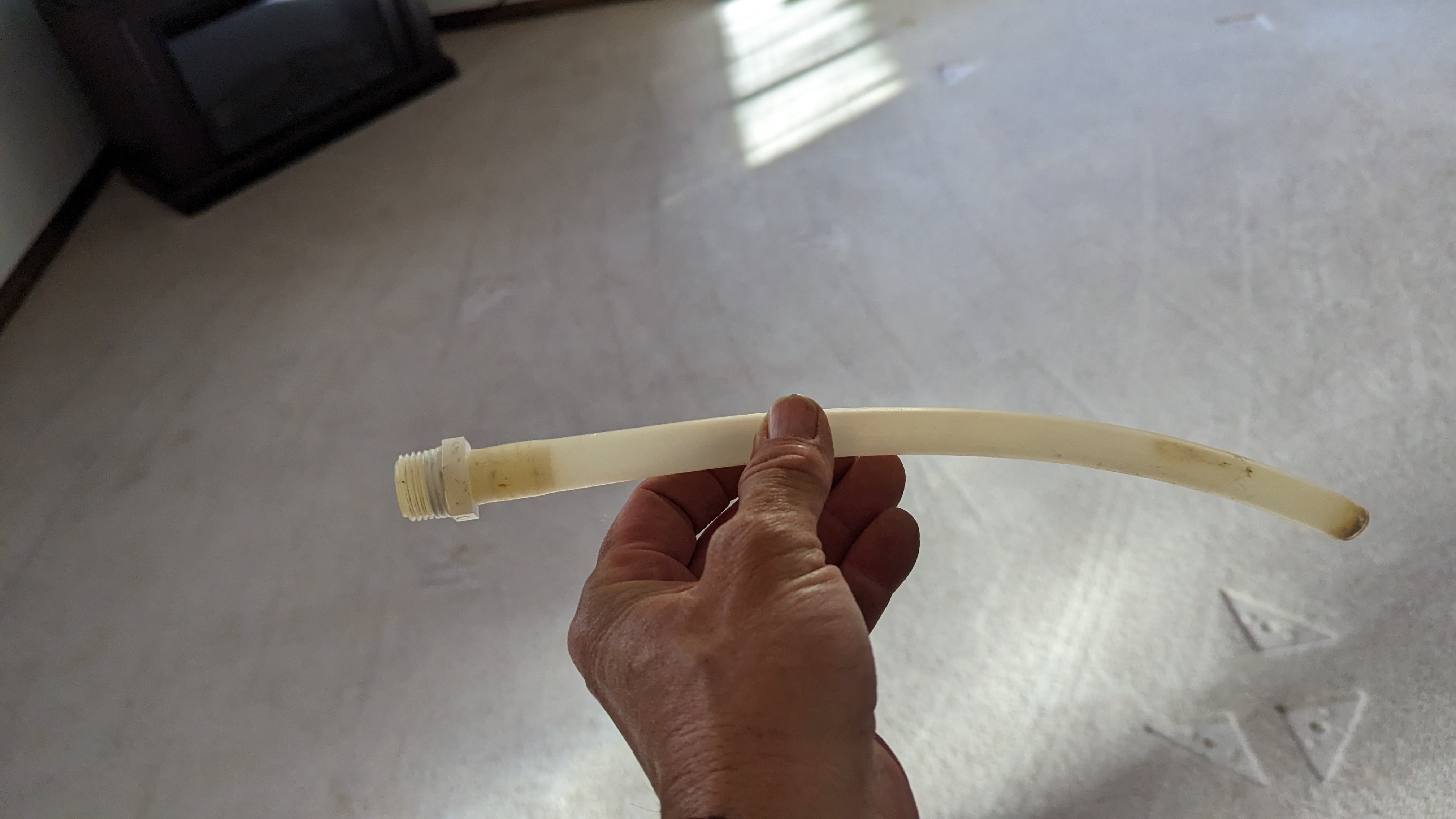

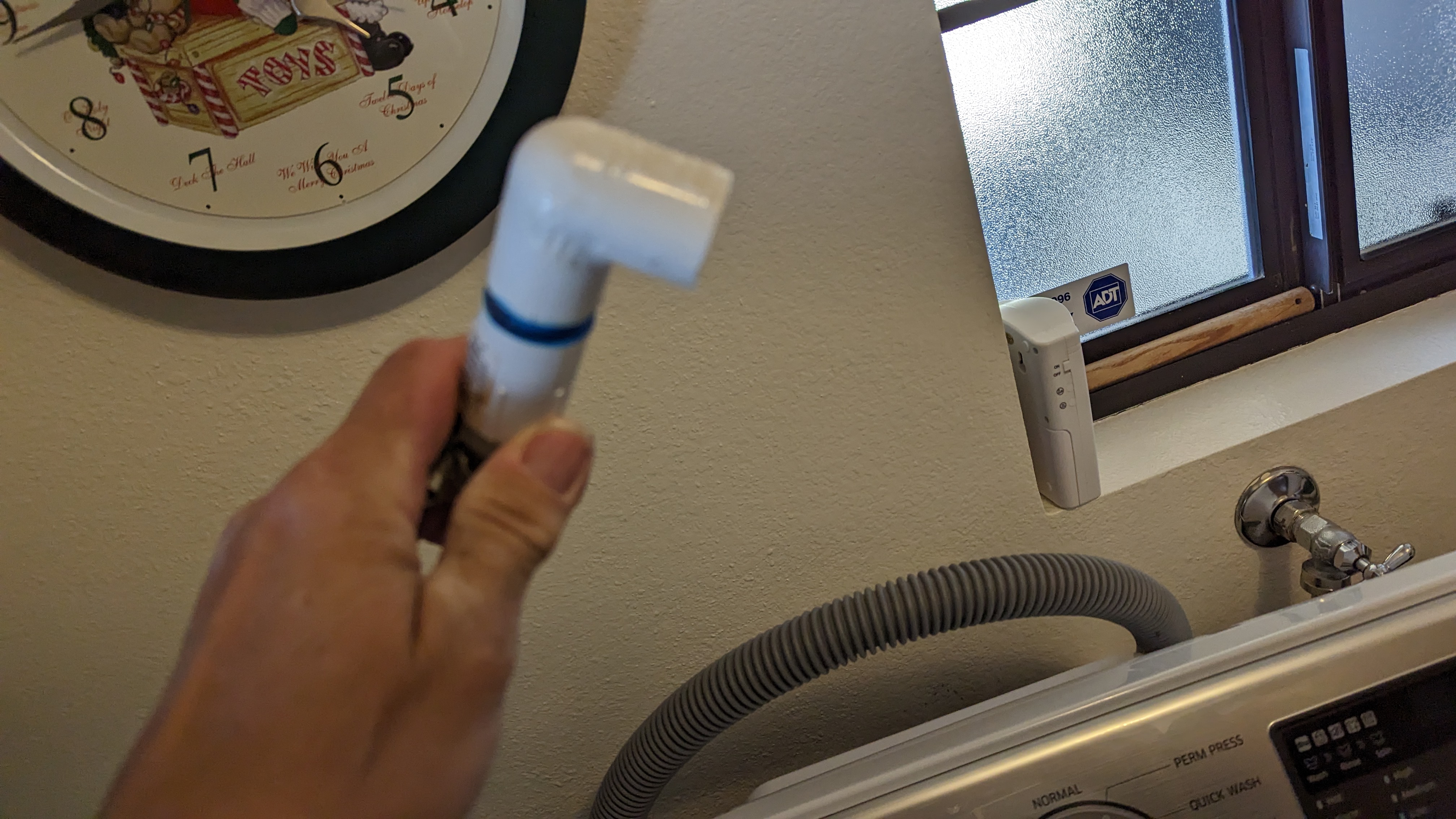

So then I follow the tube for recharging it through the house to the drain in the washing machine.
Sure enough the plastic elbow snapped and the hose was hanging loose.
It recharged when she was gone and leaked water into the house.
