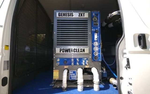

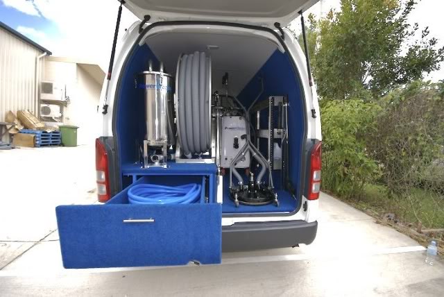

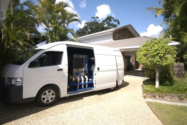

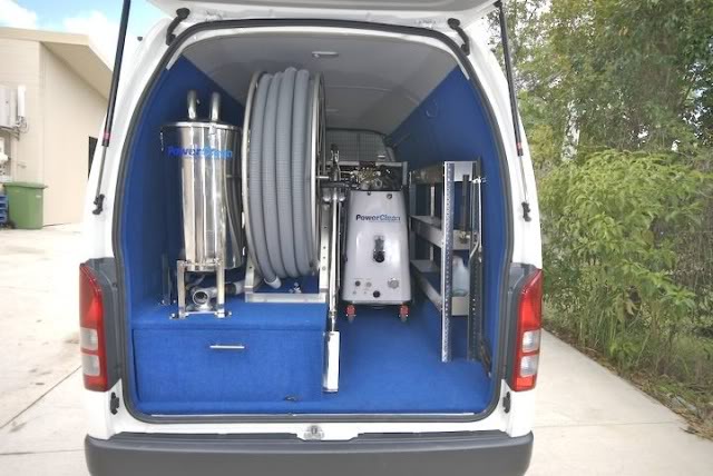

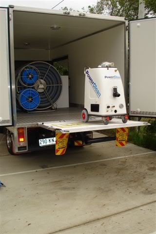

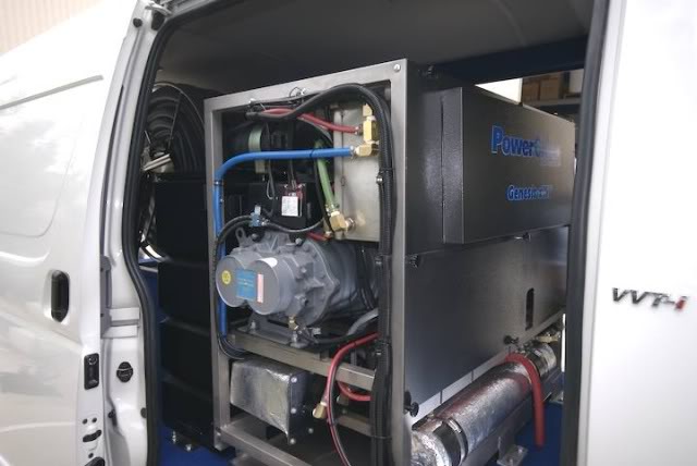

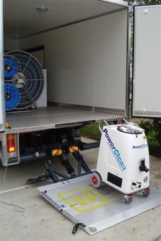

More installs as requested...

1st CLASS all the way. Our American distys SUCK in comparison. There is NO comparison. Most American truck mounted vans would be condemned if they we're houses by the government.
PURE, PURE QUALITY!!!!!!!!!!!!!!!!!!!!!!!!!!!!!!!!!!!!!!!!!!!!!!!!!!!!!!!!!!!!!!!!!!!!!!!

Those look terrific! If I had been able to get a setup like that when I was purchasing from Powerclean I would have. That is some nice looking stuff.
Do you know if those of use with a couple year old Genesis can get that new "larger" waste tank? It appears to be the same width from what I can see, but it is taller.

That really is amazing. I am quite impressed. I love the look of all that stainless.
Why can't we get that in America?

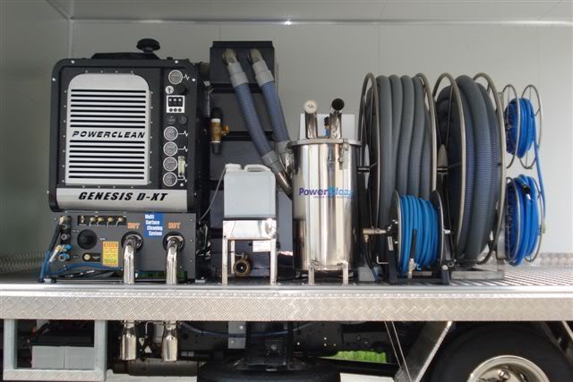

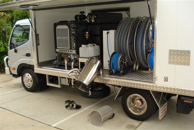

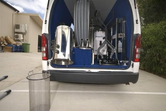

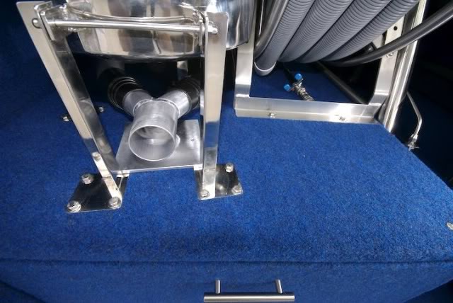

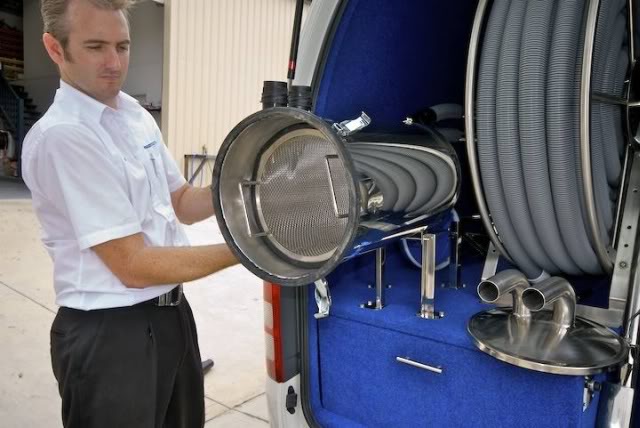

Very nice installs on both trucks. I like the idea of using more Stainless.
I think that since the equipment costs more over there, that it is installed and maintained at a higher level.
I like the tilt-out feature on your inline filter. What was the cost of just the filter?
We had a line of NSS tank vacs that emptied the same way and customers liked that feature.

The only thing I don't like about the filter, is how HIGH up the vacuum connections are, I see that being a problem. Other than that, I want an external filter badly.

Would Powerclean sell that external filter by it self?
If you contact PowerClean Industries in Chicago Fred, I am sure they could answer that question. While I cannot comment 100% on their behalf, I am pretty sure that they will be manufacturing these tanks very soon.

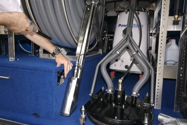

I'll give you a quick run down of our installations starting with a new van
We then rustproof the floor
Fit marine grade ply and screw that to the floor.
Fit insulation into all of the wall cavities
Cut Zinc sheeting to size and rivet it to the cross members of the walls
Apply marine carpet to floor, walls and doors. Measure up and start fabrication the custom racking and auxiliary tanks
Before it gets completed and loaded before it rolls out of our factory...
If you have any other questions Patrick, don't hesitate to ask. :)

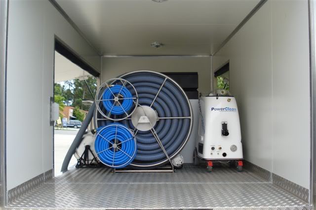

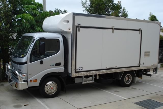

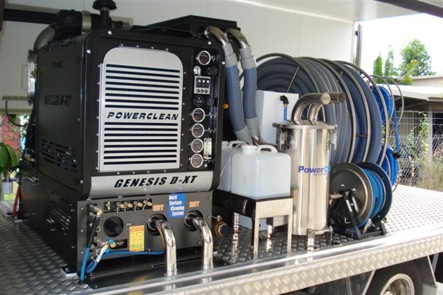

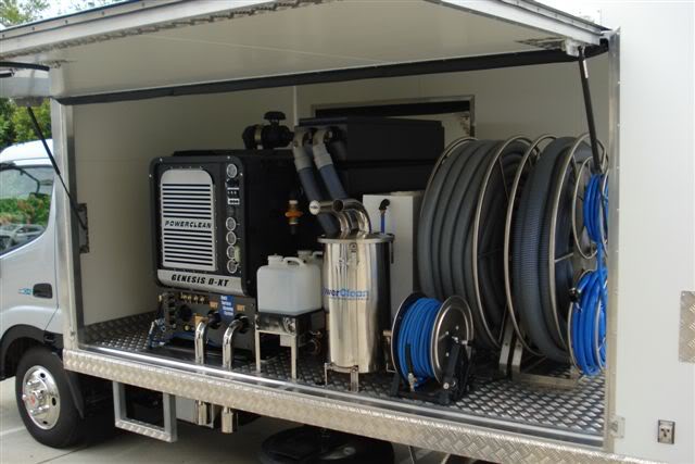

Here are the finished photo's of the rig that I partially posted earlier. The Stainless racking and wraps have now been completed. On board currently there is 2 dehums, Cimex, 22 air movers and still a lot of space left over. All the racking including the chemical lock box is stainless. Came up great!
Side view showing the PowerClean Diesel D-XT Genesis.
Finished off including the wrap.

you have the "best in show" installs, Jim
truly top-o-da-heap!
set up for max efficiency and economy of space.
very very well done!
