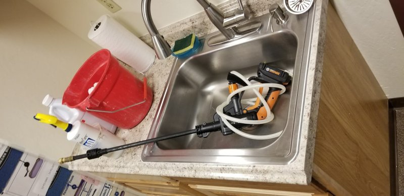

Got the worx sprayer.
What are your tips for using this?

change the tip out to a T jet...

I prefer a 4.0/40 degree pressure washer tip in place of included tip, you can then rotate the spray/fan any way u want. Shorten the hose to way less then half the included length, it will then prime in just a couple secs. I like it on low speed with short lance for upholstery, on high with the full extension to prespray ahead for bonnet cleaning. Very handy gizmo.
Rinse after every use. I do and have had no issues. I use it quite a bit for QUAT jobs, smaller cleaning jobs, and urine.
