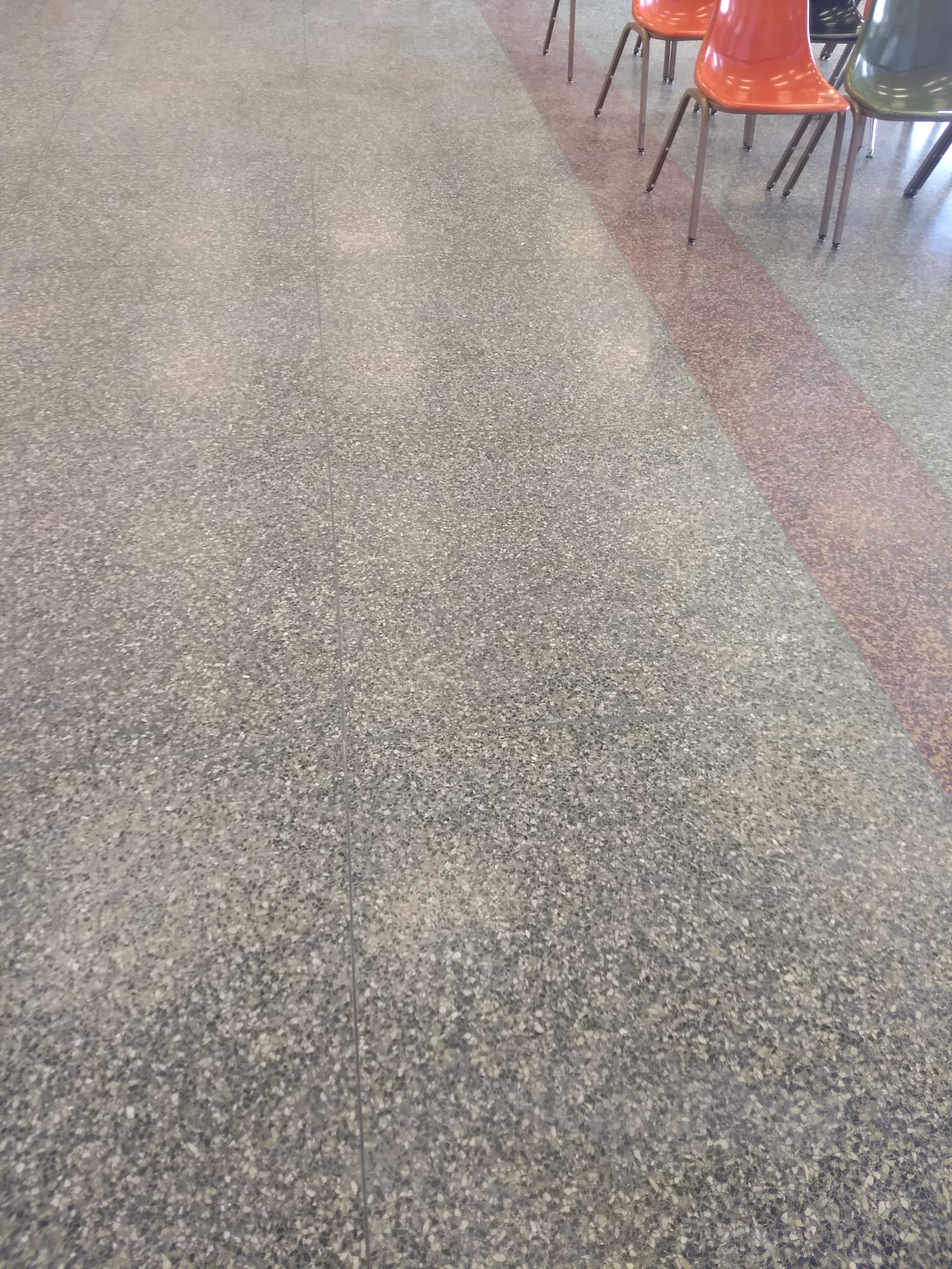

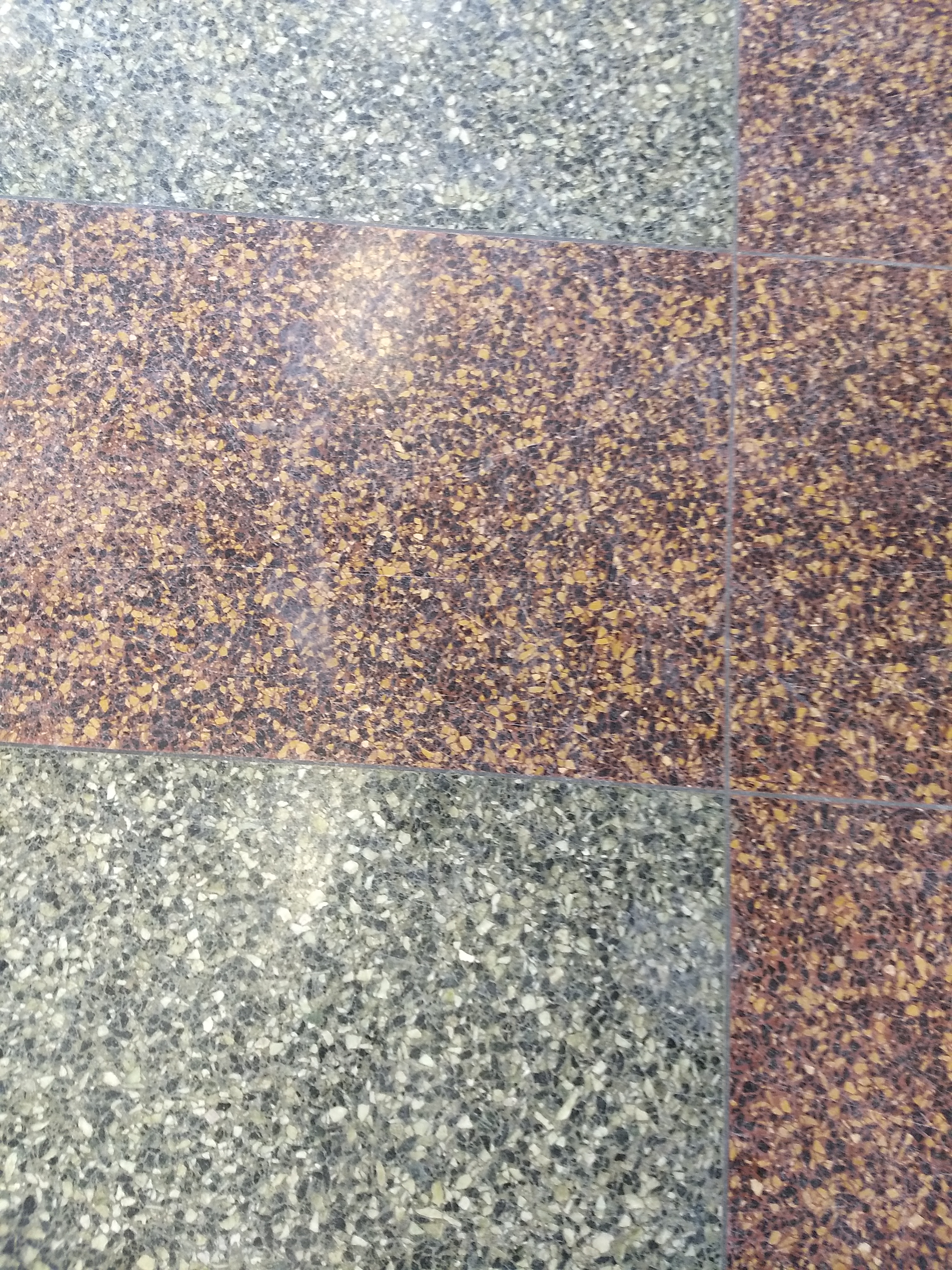

Jun 26, 2018 #1 Lyman Supportive Member Joined May 19, 2007 Messages 1,765 Name Lyman How do I clean and or can I strip and wax?
Jun 26, 2018 #2 Mike Pailliotet Administrator Joined Oct 6, 2006 Messages 117,272 Is it coated? Strip and wax or even better, strip and diamond polish Reactions: Kenny Hayes and J Scott W
Jun 26, 2018 #3 Kenny Hayes Member Joined Apr 17, 2009 Messages 10,175 Name Kenny Hayes When I was moving a load from my old shop to my new one, I had a bag of new diamond pads blow out on the interstate. I seen them going, and I’m like, No No No No!!! 67’s hard!!
Jun 26, 2018 #4 Lyman Supportive Member Joined May 19, 2007 Messages 1,765 Name Lyman Built in the 60s, 8000 sg ft
Jun 27, 2018 #5 Kenny Hayes Member Joined Apr 17, 2009 Messages 10,175 Name Kenny Hayes You can strip and refinish. Spp are great on Terrazo. My Catholic Churches have it, and that’s what I do. A lot faster than polishing.
Jun 28, 2018 #6 B Bruce Humphrey Member Joined May 12, 2007 Messages 2,519 Name Bruce But after it's polished , wouldn't the polish hold up better then the wax? I have Terrazo that I strip and wax , wish I could polish it. Reactions: Mike Pailliotet
Jun 28, 2018 #7 Kenny Hayes Member Joined Apr 17, 2009 Messages 10,175 Name Kenny Hayes You have to maintain both. The reason I put finish on most of mine is time frame to turn it around. Reactions: Bruce Humphrey and Mike Pailliotet
