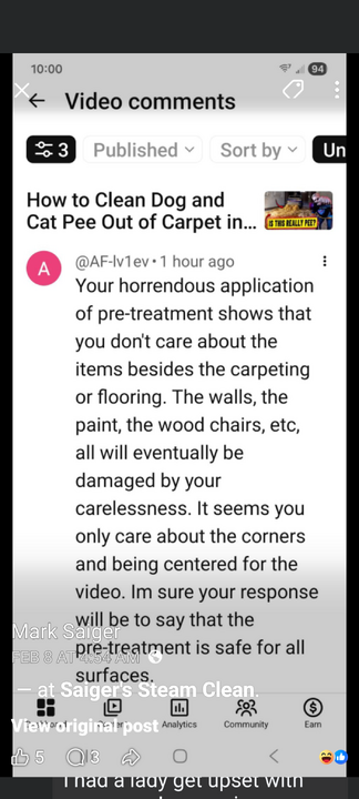

Is this review of Saigers "wrong"
117,265

Did they apply the pre-treatment to the walls and chairs? Was it careless?

Atomization takes our "Pre's" further and wider than you might realize..
So what's the solution?
Isn't the Urine also destructive, more so after it converts to Ammonia?

My question isn't just about urine treatment but the whole priest spray in the swiping of left to right with our two foot hydroforce lances..
On your next job after pretty spraying a furnished room you may want to go touch the legs and skirts of the furnishings to see what you've created or left behind rather...
Maybe the answer are those colars we put around our dogs after surgery

Screw that customer!
Hypocrite for certain. If they cared so much about their own furnishings, the animal would’ve never lifted their leg on the carpet or furniture. People care more about their animals today than they do their own self respect.
But it was probably just another carpet cleaner envious and jealous of Mark’s success which needs to be addressed publicly
Edit: oops. I see that it’s a video comment and not an actual review. I still agree with my statement though.

Like Saigers and many here, we done multiple house many times without complaints.
Obviously you don't want pre spray on wood or stainless.
But the person haggling Saiger is a jerk.

Mark gets a lot of criticism for his videos. They are annoying, but his techniques and his products are first rate. It’s normally just jealous competitors or clueless internet warriors.
True, this wasn't a thread meant to pick on Mark but rather to address that the atomization the priest spray in the moving hydraforce or pump up or any electric sprayer doesn't get on a lot of stuff.
Have any of you ever had a customer complain that you caused any sticky residue or brownouts or worse?

Divulging on atomization; if we set our machines to lower pressure, stop swaying the lance like there is no tomorrow, maybe we wouldn't have to worry about furniture/ SS damages from prespray. I rather take a customer’s complaint that I missed the spot than damages to wood or the stereo. With a competition making false claims nowadays ( we remove 98.9 allergens from your home) in order to lure customers in, I counter with excellent drying times in writing ( less than two hours).
