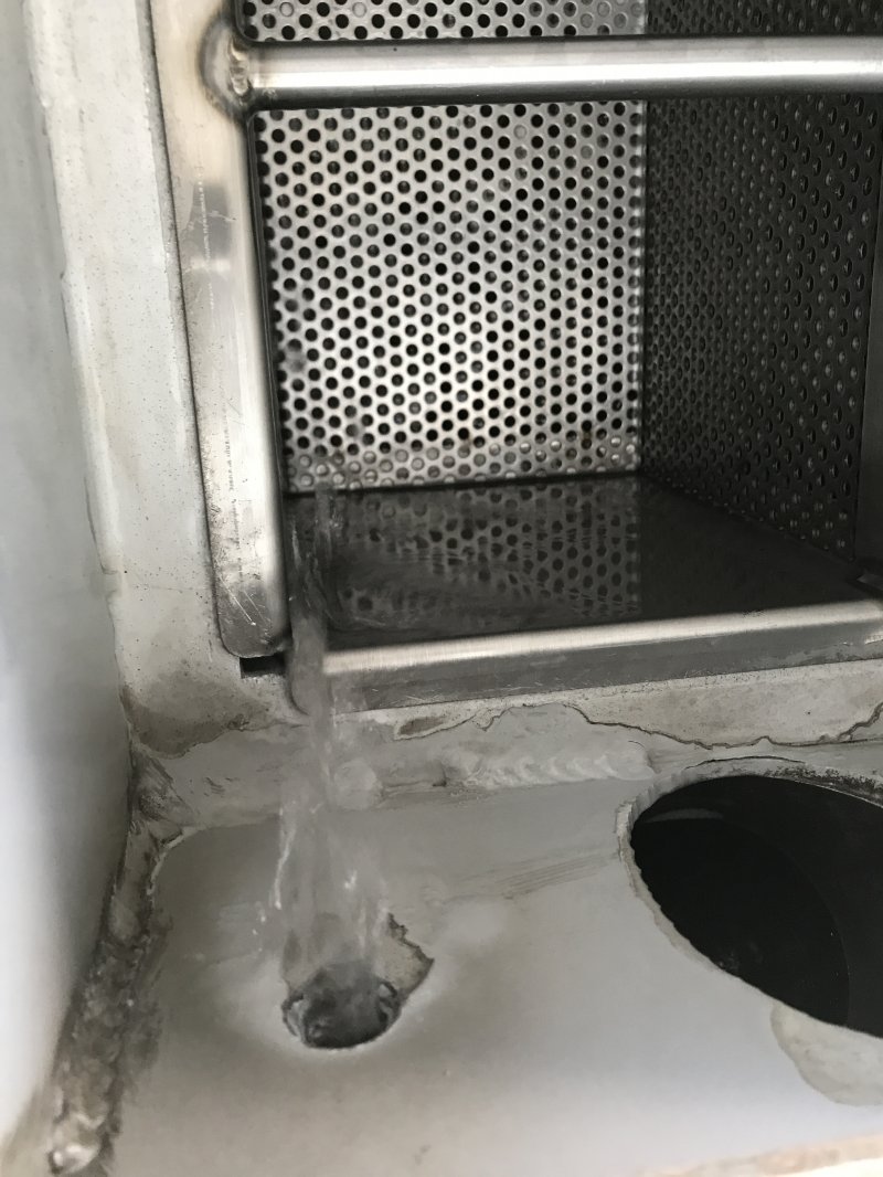

At least they are starting to look better. All I know is the 570 is a heat beast. Divert into freshwater tank seems to be only viable option.

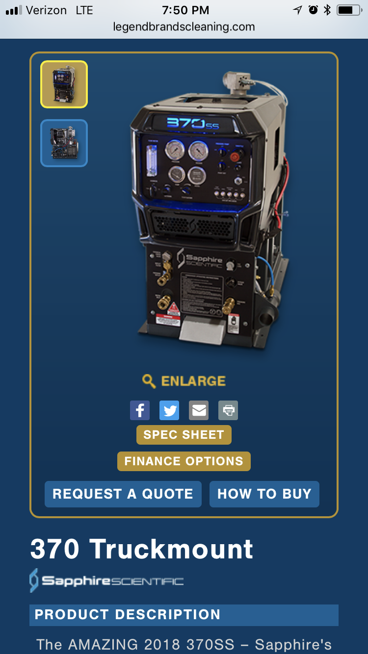

The pic above isnt telling me too much about diverting. My SS370 has a maual diverter to bypass the heating chamber - but I want it to bypass on its own as it reads selected temps rather than dump the water to bring the temp back down.
