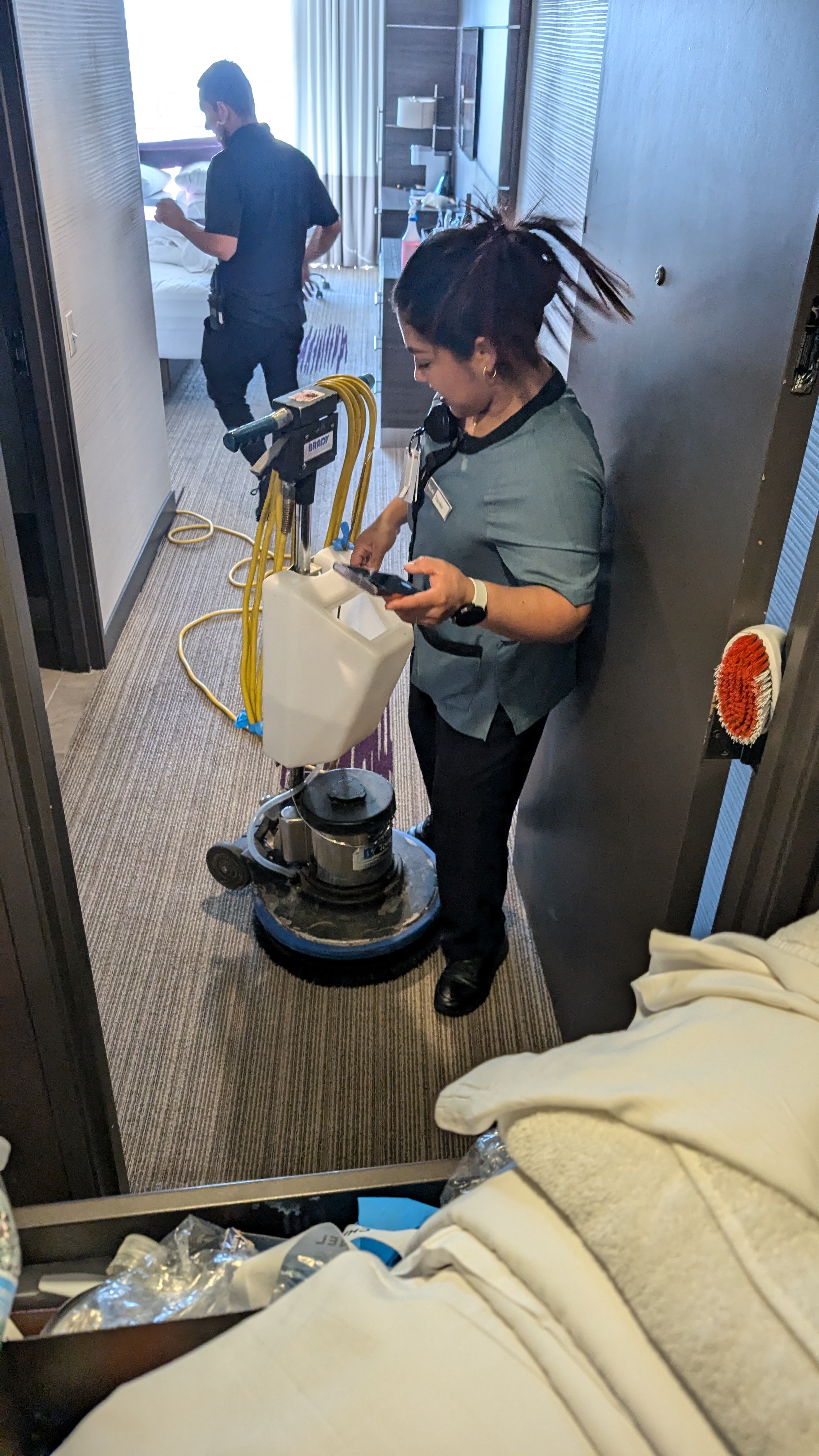

My room at The Palms was shampood...
I'll keep my boots on.
  • Sad
Reactions: KevinL and BIG WOOD
12,839
I see she is holding the favorite piece of technology that every employee of a carpet cleaner uses constantly......
That is as telling as the technique
12,839
She was using it to translate my questions as she didn't speak a lick of English...
Now that is a useful purpose for her to have it.
So....they were feeding shampoo through the shampoo tank and scrubbing it in with no system of recovery at all?

Did you get a look at what was in the shampoo tank?
Back in the "bonnet cleaning days", Jan-San manufacturers produced products made for bonnet cleaning that could also be used as traffic lane presprays. It didn't take long for any traffic lane prespray to become the standard for bonnet cleaning in the commercial/institutional marketplace.
I would be willing to guess that whatever is being used in that scrubber was bought on price and perhaps performance, but with little concern about resoiling.....
.....our how it might affect you delicate feet and toes.

Only noticed a Brady lable on the machine..
Brady Janitorial is huge, and located here in LV
