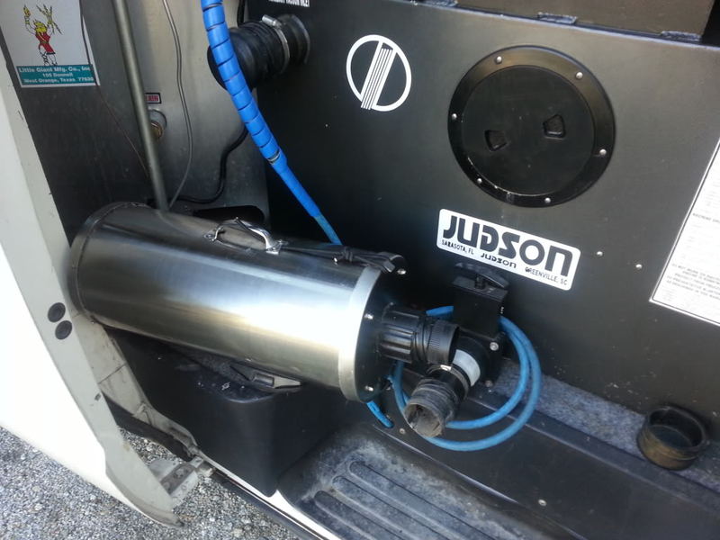

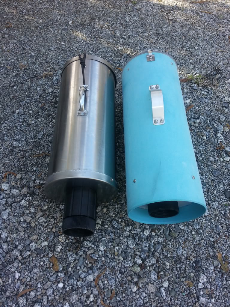

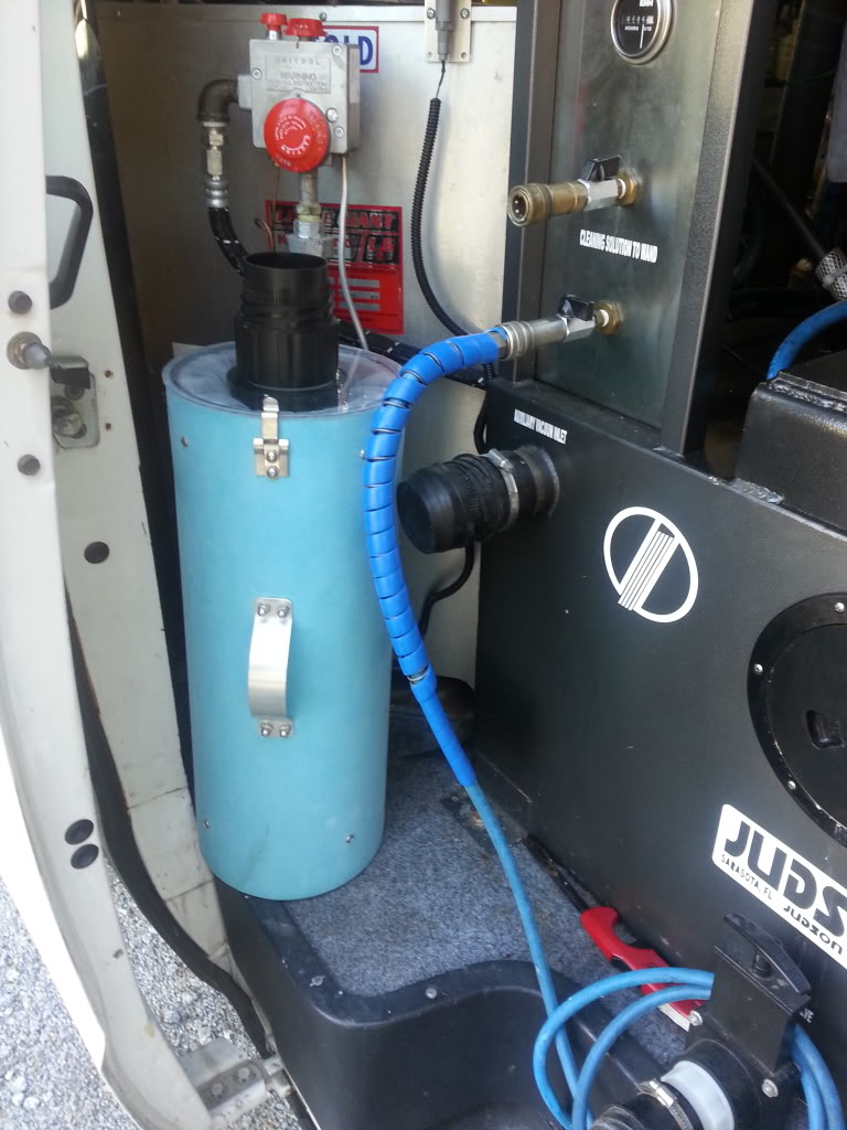

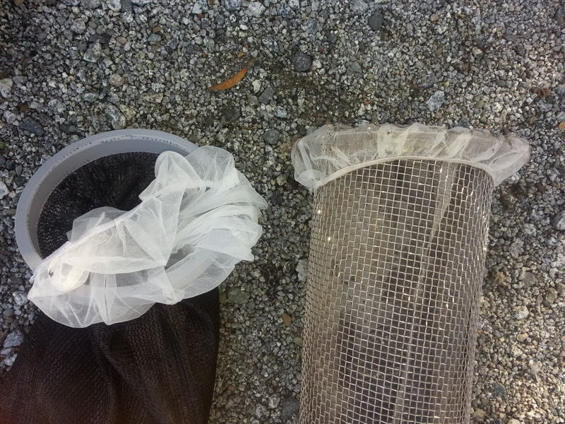

You are 100% correct, I have sold a few filters to cleaners in Florida, they were cleaning beach front rentals and the fine sand was clogging the filter or (white Liner)
When cleaning restaurants or any job with a lot of grease. The white liners are poly and just like poly carpet they love oil.
So what we tell guys is take the white liner out, the HD bag will still give you decent filtration and let the finer greasy stuff pass, in fact some guys don't use the white liners as they feel the bag is good enough, I myself want to keep my blower filter as clean as long as possible, every time I go into my tank my waste tank gasket has to be fixed:madder: so I only crack the b twice a year.
With BJ's filter you HAVE TO run the liner as the holes in the SS basket are 1/4 and wont filter much at all, and as the liner clogs the airflow is going to go around the front of the basket as there is about 1/2 gap. Mine has a gap also just not as big. so you may think the airflow is lasting longer its really more than likely going around the outside of his basket and not filtering at all.

and spraying that mesh bag out is a bitch....ill take tossing the goody bag any day over having to dump and flush the mesh out anyday
