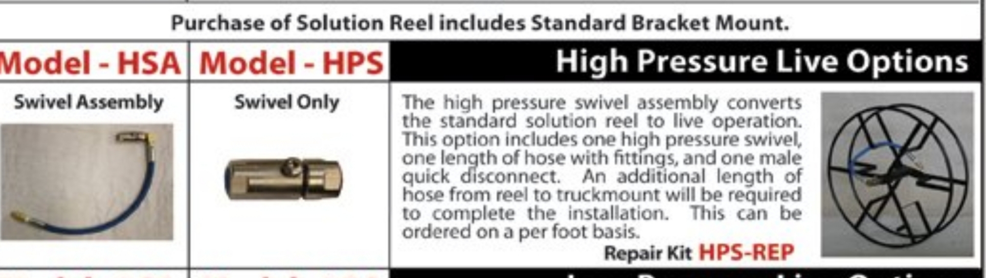

Just don't leave it on the spool to build heat and cook your hose. It will last fine if you unspool most of it each time. So just don't stick it all on the spool, hang the extra that doesn't get used that often. Make sure that section also has a ball valve so when you need to use it, just pop it on the front end.
Rokan had a conversion kit at one time.
