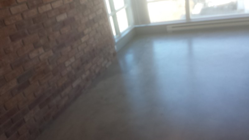

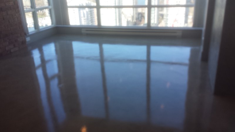

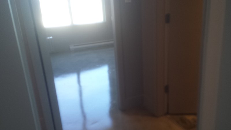

I'm keeping it really simple. Clean and apply finish - that's pretty simple.
Here's todays stuff.

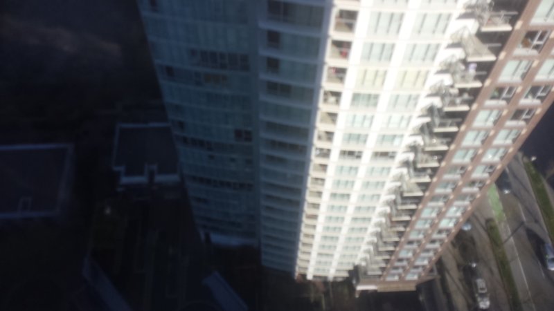

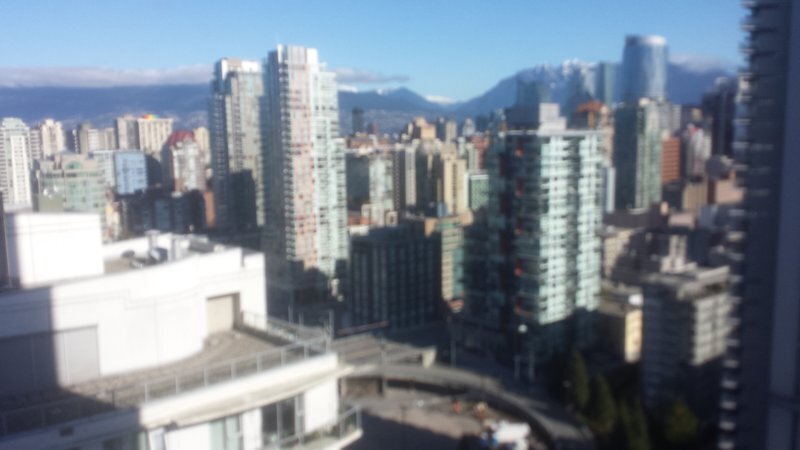

Nice view - 33 floors up.
