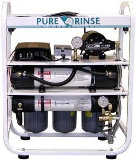

This is the one that does the best job of removing residue:
RO water with nothing else.
Ask Dave G.
Larry
Ron Werner
8,726
Ron Werner
what's the flow rate on that machine?
ie how long to fill 120gal?
Does RO water have the same challenges as DeIonized where it eats the metal?
