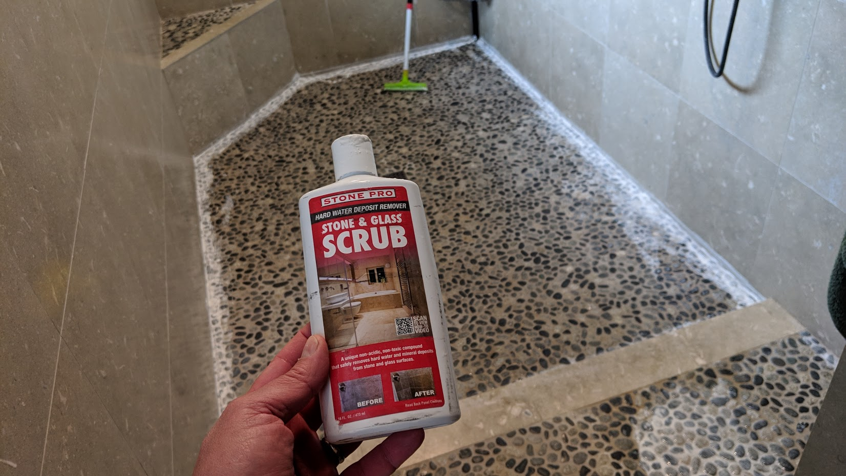

with this..
I never read the label.Is that why it says “stone and glass” on the label?
Razor for the stuff on the wall tiles. Grit brush on the floor with possibly some acid depending on the conditon and finish of the walls and floors. Those stone floors are always failing...the stones are smooth and the cement doesnt adhear well to them. There are often micorcracks between the two.
Limestone wall tiles....
SGA makes a kit for these mosaic floors to replace the grout....I would think it would be indestructible.
how are you going to remove that grout though?
