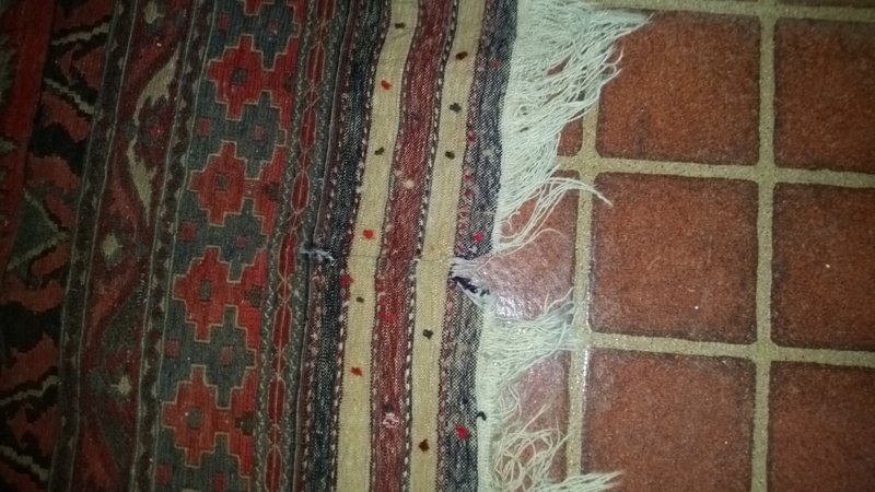

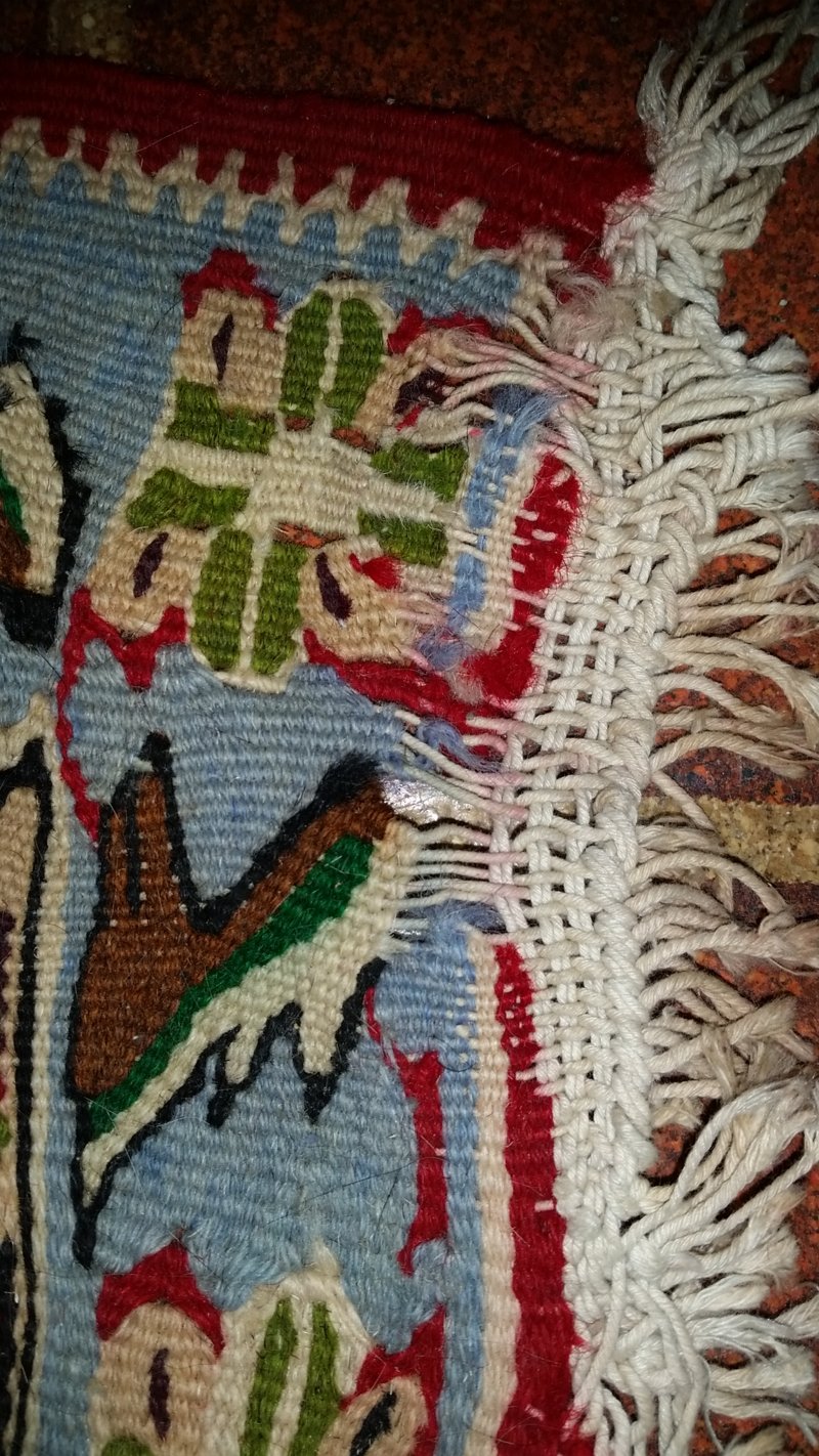

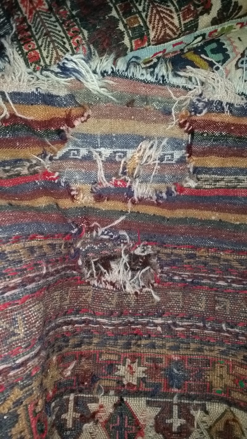

That is a nice product to have. A couple of years ago I treated and cleaned aprox 50 assorted rugs for moth larva infestation. Many of the rugs needed extensive repairs and reweaving. The whole house was infested. The owner had one area in the bsmt cleaned and treated, just so he could store the rugs without them being reinfested. Sounds like this product will prevent the larva from eating the wool and backing. How long have you been using this?

I agree but especially in some of the older mansions that I get rugs from, they have the potential to harbor a decent population of moths despite attempts to keep them under control. Just too many food sources I these large older homes. I think even my rug collector customer would appreciate having that option. It also makes a good upsell as long as it works.

I agree, if you had seen the extensive moth damage on some of my collector customers rugs, you would cry. He imports carpets from all over the world and I don't know if the moth larva comes in with the rugs or if they are picked up locally. Some of these rugs are treasured heirlooms reflecting depictions and inscriptions from the Bible in Hebrew. Some are very valuable silk rugs, just beautiful to look at and feel. I had no idea of a product such as repel but I will be adding it to my chemical lineup. We were able to kill and remove all of the larva from the rugs but I know there are more in his home and eventually they will find the rugs again. I wonder if this can be used in home on rugs that are in use?
