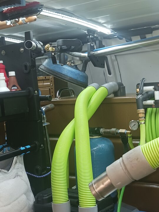

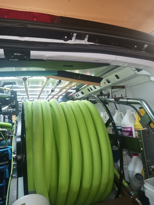

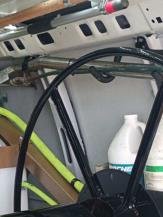

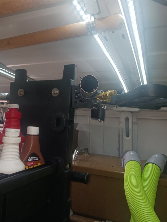

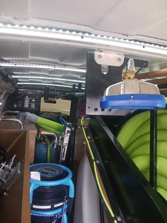

When building Frankenstein i used several different methods to secure wands , for a scrub wand i used a wand clip and a modified bicycle carrier. For my gekko wand i used 2 garage hooks from home depot, a 1½" rubber hold down from Amazon and ½ of a hydramaster wand holder, for my spinner i used the other ½ oh the hydramaster wand holder and a 1½" rubber hold down for my stair tool i used a 1½" wand clip.for caution hose signs i used a modified upholstery tool/hose holder piece from a old prochem chemical rack

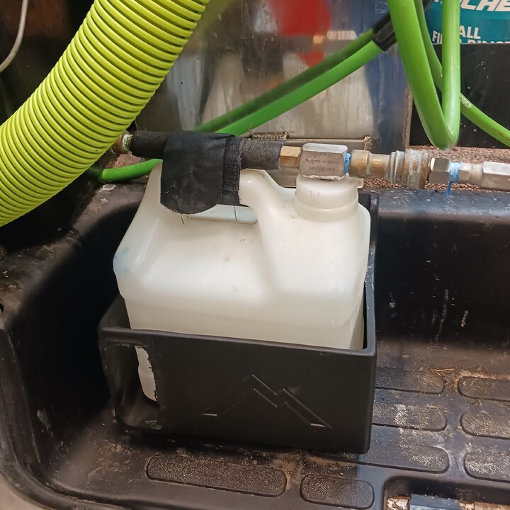

Sorry hit post by accident. For gum tools i used a magnetic hook from harbor freight. For blower lube , stainless(machine)cleaner , and small tools i used harbor freight toolbox magnetic accessories ( added thumb screws to hold in place) mic. Cords home depot garage hooks
For sprayers i used modified mytee sprayer holders secured with small sectional sofa clips to make removal for cleaning easy
