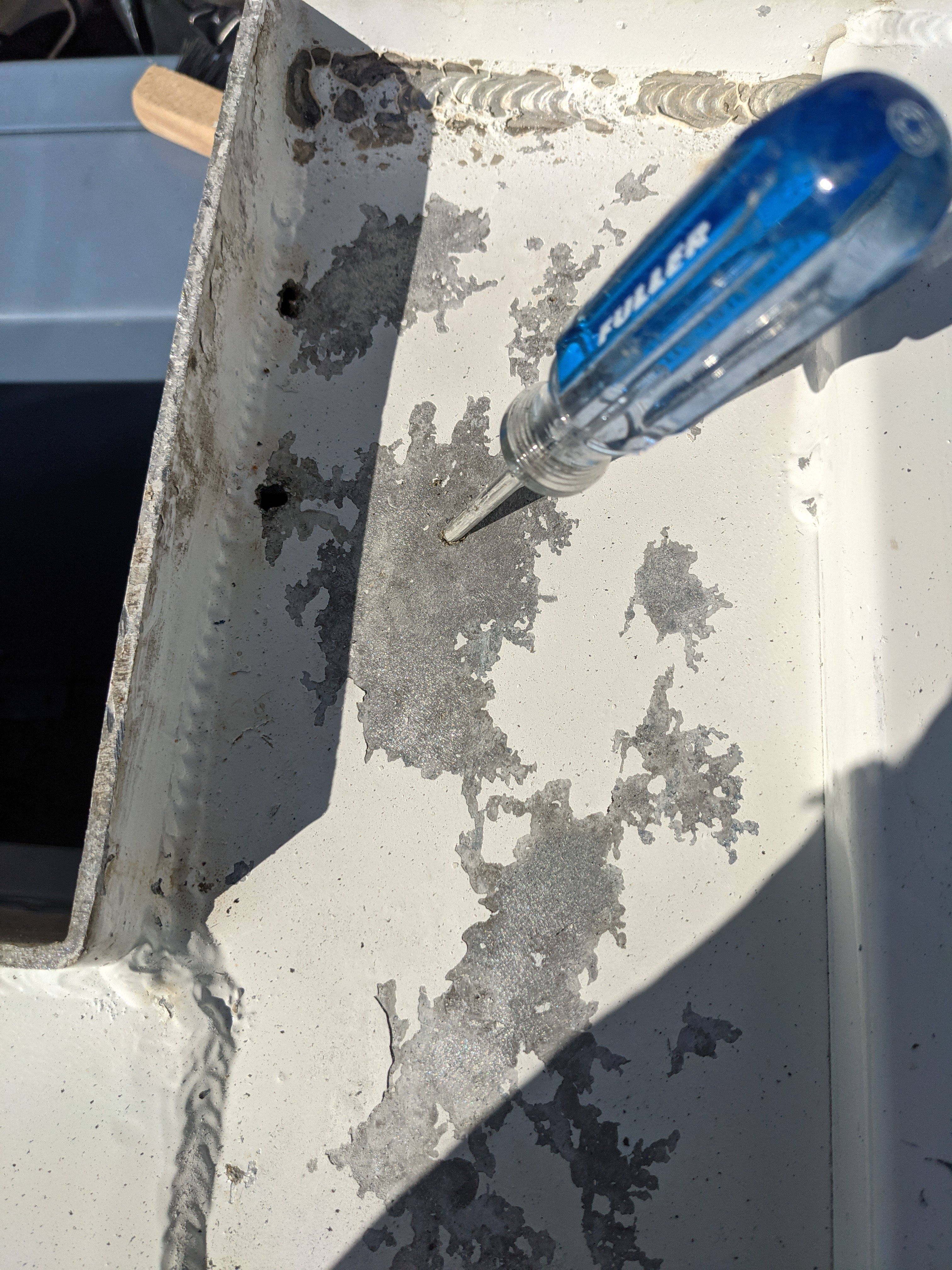

I thought you of all people would recognize a screw driver.What’s that round blue thing?
My fabricator is looking at it. He has a similar idea.I had one repaired for $600.00. They added aluminum to the bottom and up the sides 1-ft. That was several years ago and as far as I know it's still holding up.

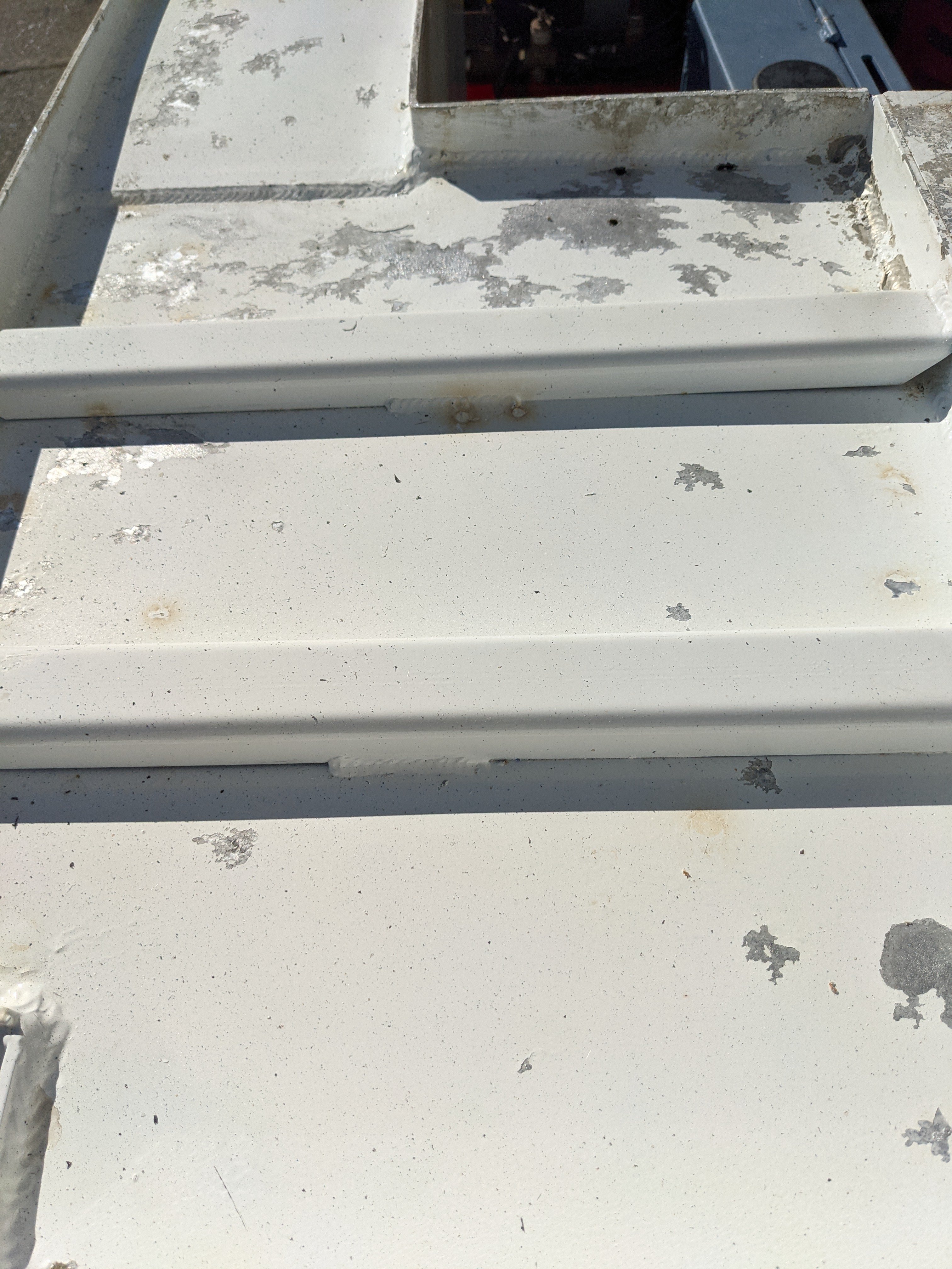

I used job weld on mine. Holding pretty good!Finally pulled the waste tank from my Cleanco to inspect the leaks. Found major holes all along the bottom. Still undecided if it can be welded or if I can apply some sort of epoxy. Will have to be sand blasted first to see all the damage.

my alloy tank had similar issues as yours, they tried welding new alloy but kept blowing through corroded areasThis is going to take more than JB weld or small amounts of epoxy. The bottom and lower sides have multiple holes and many pits that will become holes. Have to sand blast first to see the extent of the damage. Probably going to weld new aluminum to the bottom and plug and epoxy the sides.
Makes me wonder what the prior owner was putting in there. I had one other tank repaired but it was in service for 34 years. This one is only 19 years old. Do acid rinses add to the corrosion? Someone using bleach to clean it periodically?I haven't ever had issue with my 'marine grade' aluminium water tanks. My fresh water tanks of the same material are another story. Those are where the sacrificial anodes would be helpful. Softened water destroyed the insides in a matter of a year or so.
In the long run, replacement with a new tank would have been the way to go. I went the ss route for my freshy tanks. I credit the longevity of my vac tanks to our 7.8 ph Roto-Static Cleaner.
I think ours was 12 years old or so. I believe not thoroughly washing the tank out and leaving sediment in the bottom damaged ours. ???Makes me wonder what the prior owner was putting in there. I had one other tank repaired but it was in service for 34 years. This one is only 19 years old. Do acid rinses add to the corrosion? Someone using bleach to clean it periodically?
Good reason to invest in an inline filter.I think ours was 12 years old or so. I believe not thoroughly washing the tank out and leaving sediment in the bottom damaged ours. ???
We had them. We should have inspected and rinsed them out more often. Fortunately it was the only one we ever had do that. A corner had gotten eaten to the point it was almost as thin as foil.Good reason to invest in an inline filter.
